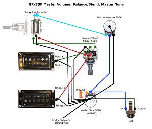

    Is the wiring working as intended? I completely forgot about that diagram and meant to follow up with you to make sure it worked with your specific balance pot. I did the pot config from memory in original diagram as I didn't have any on hand at the time, and while that would match some brands of balance pot, other brands like Alpha actually have a reverse configuration. Basically, the ground connection needs to be on the resistive side/end of each layer of the pot.
    Here's the alternate diagram for Alpha style balance pots, just in case:

    Again, congrats on the build.

    Wierdbits, yes it is working! I'm not 100% sure if it's as intended but that might have to do with pickup height. Select rhythm, roll the pot all the way to the neck pup and get about an 7 out of ten on volume. Nice clean sound and when I hit a chord I can turn the whole volume off and on by switching up and down on the selector, a fun option. Select treble roll the pot all the way to the bridge pup and I get ten out of ten on volume, but if I switch Back to rhythm I still have it at about 6 or 7 volume. It's definetly a fun setup that I'm enjoying playing with.
