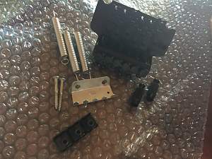

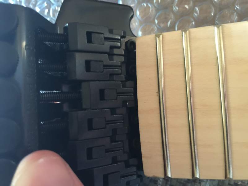

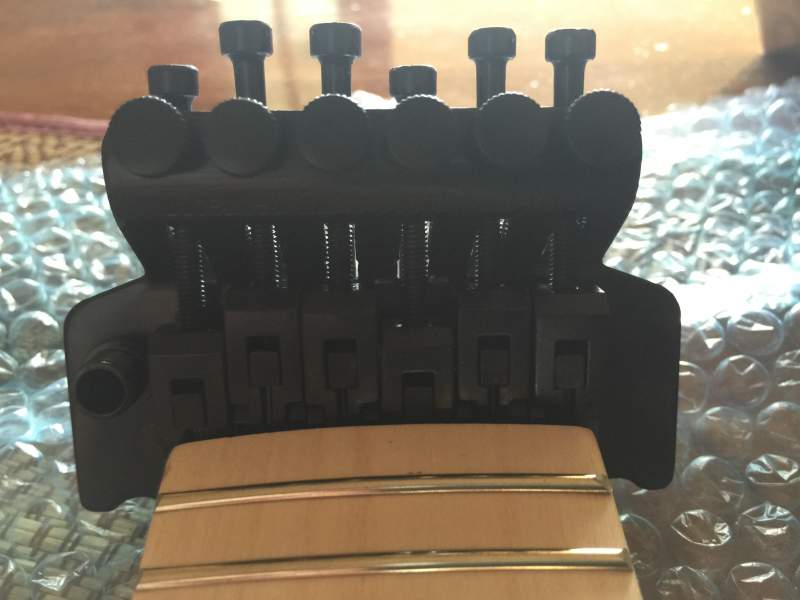

    i still havnt finished that headstock, im over wearing my arm out, its half done though haha. here are those photos as promised guys
    more photos to come hopefully in the upcoming days as i took my guitar in a gave it to a rather nice fellow in toowoomba to do the routing for my floyd rose. when that comes back, it will be time to start painting.. finally, although i havnt been able to get ahold of DB to organise a custom colour. anyone know anywhere else that i can order a good stain or that can contact DB for me? Cheers lads

    nice one Kurt someone doing the routing. Before you stain it I'd recommend a mock build to make sure the FR fits and works ok, in case it needs any more tweaks. It's worth screwing the neck on, fit the FR, springs, trem claw, string it up to get an idea if the tremelo will sit flat. The spring cavity needs to be long enough to get the necessary tension on the tremelo.
