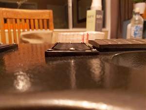

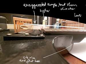

    Potential problem - right at the end!!
    OK I'm a bit stuck now.
    I bolted the neck on, but it looks like its got quite a downward tilt starting from the neck bolts closest to the pickups, then fading down out to the head!!
    I did check the fitting before painting and it seemed reasonable. I tried a gentle tap with a nylon hammer, then rescrewed, it didn't seem to make too much difference at all
    So I'm sort of stuck, should I put some strings on and see if it's ok - I doubt the tensioned up strings would lift the head end up a bit (would they?) as they'd be competing against the 4 neck-to-body bolts.
    Or, should I try to carefully sand inside where the neck fits into the body?
    I've attached 3 photos to show as best I can. ANy help for this final push really appreciated!!
    thanks

    p.s. I can take more pictures if that helps the analysis
    I did note from your earlier comment Trevor you thought maybe a small angle e.g 4 degrees would be ok... it just "looks" wrong to me at the moment, albeit with no strings on
    1,967
    The pictures in post #56 look right. I would not sand the neck foot or neck pocket. Put the strings on and see.
    There is a lot of adjustment for the bridge height.
