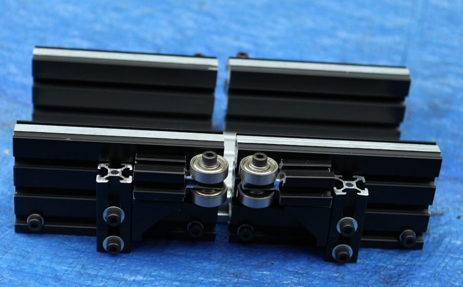

    I was never happy with the adjustability of the fret cutting jig, so I ditched the other two (I had one for an already marked fretboard and another for a blank on a 6mm perspex template). I came up with this:
    The idea was there was enough range of ajustability to replace both jigs with a single one. It wasn't till I had already cut all the parts that I realised that I only needed to be able to accommodate the template version. To deepen the slots in an already marked board just needs a 6mm base underneath the marked blank. Yeh.. my brain hurts!

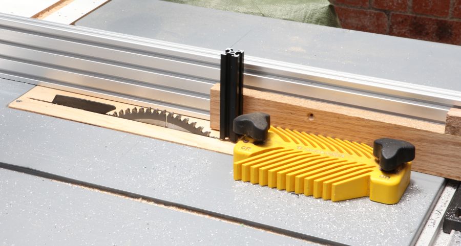

    The elegant way of dealing with the bearing section of the bearing blocks would be to use a mill, but since I'm not yet assessed on the mill, I had to get ...creative:
    The piece of extrusion was held to the push board via the t-slots of the extrusion:
    Since I had no idea how this was going to go I did the first slot in 4 cuts wearing thick welding gloves, a thick padded welding jacket and a face shield. The multi-material blade I used cut like a knife through butter and I was able to do the other 7 slots at the 20mm depth required in a single cut.
    Since the bearings have an 8mm hole and the 2000 series extrusion uses M5 screws I had to machine some sleeves for the bearings.

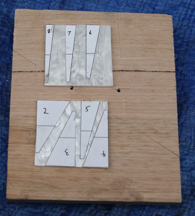

    The other guitar related thing was laying out the paper templates on the pearloid squares for the cliffenbacker fretboard inlays:
    I was expecting to need more pearloid so I had extra . Good thing since I will need it to determin how deep I need to inlay them so I don't loose the edges of the 7th and 8th inlay when the board is radiused.
