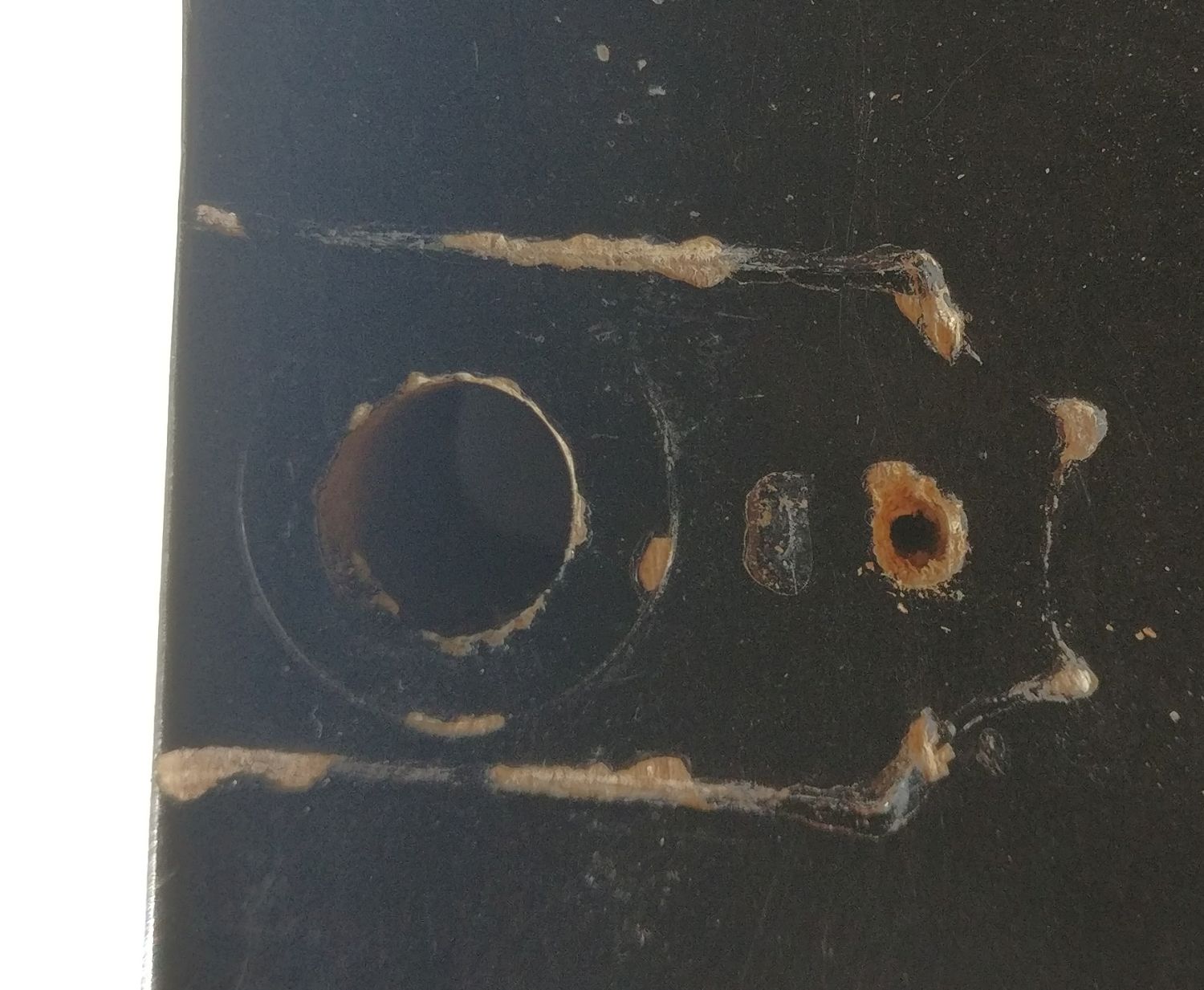

    Yeah, I didn't do that. I couldn't see an scratches when I put the tuners together, even though I only used the double-cut side of the flat file. I didn't have any serious burrs and polishing seemed like a lot of work with not much payoff. What did become clear is that the tuners are probably going to leave a mark in my heastock as they did on my jig...
    ...which, of course, no one will see on the finished product. I have decided that neither invisible problem bothers me enough to do something about it ;-)

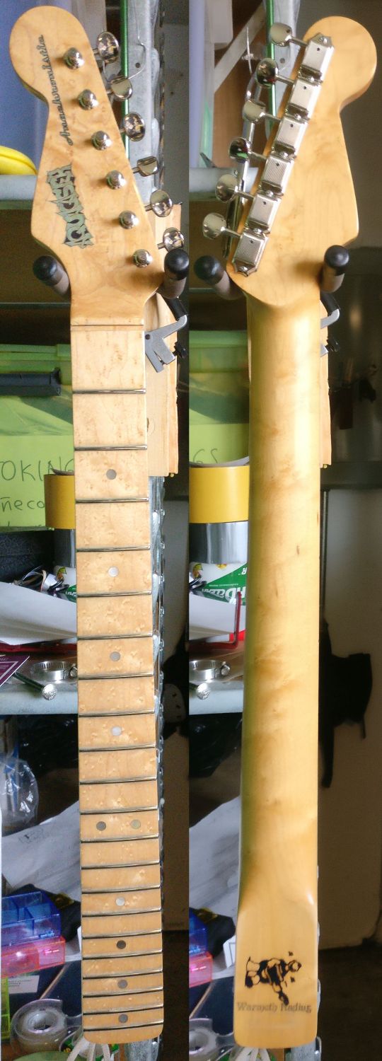

    A little progress...
    I managed to do the finish sanding an polishing to the neck, and then added the tuners.
    Not the clearest pic, but the up close the bird's eye figuring in, particularly on the fingerboard, really comes out. Not a perfect finish, but I think I can live with it. Ironic how tempting it is to rush now, after putting the first touches of finish on this neck over 30 years ago. Most of the color in the neck is from that original finish that was very light and almost completely clear, but has yellowed dramatically over time. There is not a drop of stain or tint on this neck.
    Is this what has happened to the original fender necks? Were they almost white when new, but have just yellowed with age?

    Why the wax? Never makes any sense to me. Naptha (lighter fluid) may help. Or kerosene and then naptha (to help remove the kerosene quickly).
    The original 'clear' nitro lacquers were neither clear nor stable under UV. So they started off with a yellowish tint and got yellower as they aged. Some of those first 'TV yellow' guitars started out pretty white, but not for long after they were sprayed with clear coat.
    Then almost clear UV-stable nitro came along, and whilst that was good for coloured bodies, it did make a lot of the necks look rather pale, so I suspect that some lightly tinted clear lacquer was then employed for consistency/continuity in looks.
    Fender started using polyester undercoats in the late 60s, with nitro colour and clear coats over the top. But that then often ended up with a mixture of polyester and nitro on different parts of the guitar, so a neck could be all polyester apart from the headstock face which had nitro over the decal and yellowed with age, whilst the all-polyester neck stayed the same colour.
    It wasn't until the early 80s that Fender switched from nasty thick Polyester + nitro finishes (which could be up to 1/10" thick!) to thinner all-polyurethane finishes. Now nitro on Fenders tends to be just on custom shop or special run guitars.
