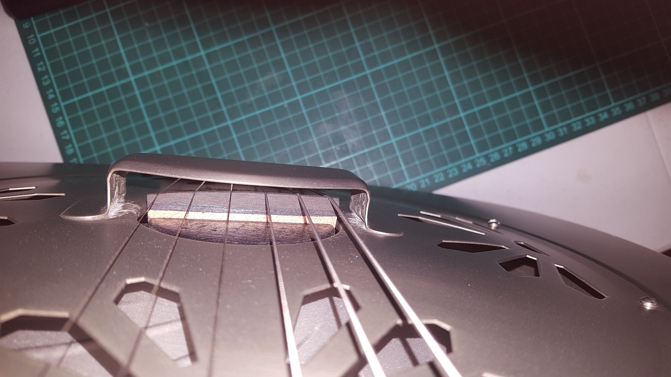

    The cone is a standard 10.5” (It's actually 10 9/16" or 268.28 mm for the Young 'Uns) spider type, it is pressed aluminium, not spun as you can see from the press form marks around the cone rim. The ideal is that the rim of the cone seats firmly against the rim of the sound well and no glue or fastener attachement is required as the string tension over the bridge and through the arms of the "Spider" hold everything where it should be. Interestingly enough the cone comes complete with four screw holes punched through the rim, which prevented it from seating properly (or so i thought). I dressed the burrs on the backside of those holes very carefully with a small flat diamond file to get them flat.
    After i'd done this, i was surprised to find that the cone rim still did not locate properly, you can see the gap below the rim in the photo below, the seating issue wasn't due to the screw hole burrs, it was the fact that the cone base actually sat on the rear of the sound well, the sound well was too shallow to accommodate it.

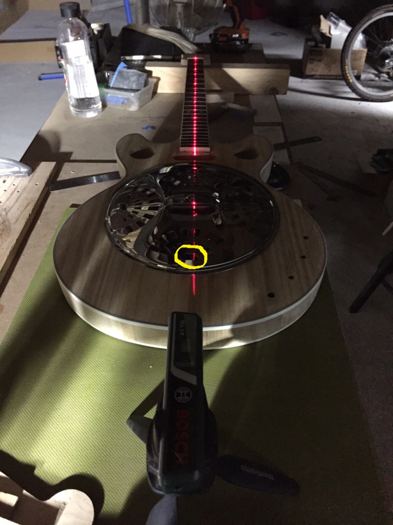

    The neck sets up perfectly to a 24.75” scale length, but there is no way that neck pup with go in with out some mod. The eagle eyed forumites might also notice that the Hole for the decorative chrome screen is not, strictly speaking, round. A minor issue all it means is that the screen doesn't fit snugly, but it is another fix needed and a tad annoying.
