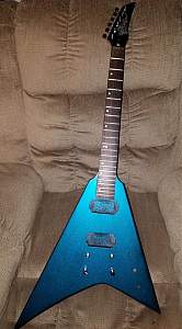

    Apparently the back just needed a little more time. I had other things going on for the past couple of days, but I returned to the JK-1 last night and the gumminess had cleared up. The back was fully dry, perhaps a little slicker than the front, but ready to go, I think. Just too much impatience on my part.
    I can't believe that I almost scrapped this one at one point because I thought it was going to be horrible. It looks great. I can't really capture the color with my flash inside. All of my photos come out looking this turquoise color, but it flips from a deep metallic blue to a dark purple in good light. I'll try to get it out in sunlight at some point and see if I can get better photos. There are definite flaws in the paint, one I'm particularly angry at myself about, but they're not incredibly noticeable without a close inspection. On to the polish.

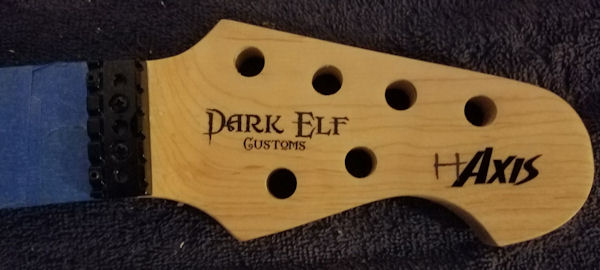

    I had mixed results with my headstock logos. I'm pretty happy with the way the MM-1 (pictured below) came out, but the JK-1 headstock is giving me some trouble. Since I painted it to match the body, I thought I'd go with a light gray, which looked good on the paper, but when I slid the decal off the backing on to the headstock, you couldn't see it at all. I guess the inking was too faint for the gray to show. I'm going to try with a darker gray, which I'm guessing won't have enough contrast with the blue/purple, and a cream, which I'm guessing will have the same issue as the dark gray. I really don't want to go with a bright color that will clash with an already pretty flashy paint job. Anyone got tips for getting a waterslide that works on a dark background?

    Unless you have an printer that can print opaque ink (ie white) you won't have any luck with waterslides on a dark background. Unfortunately this is limited to pretty high end commercial machines.
    I'd suggest getting a decal vinyl cut in white - there are stacks of places online that will print/cut your design in a variety of ways. Thats probably the easiest way to get a pro looking finish.

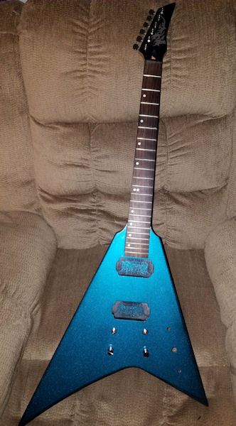

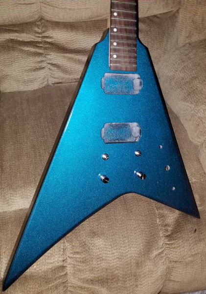

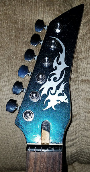

    So it's been a while. I put my builds on the backburner for a while after running into some frustrations and life intrusions, but I've made some pretty good progress on them in the last week or so. The JK-1 has had strings on it, for one, and I'm down to getting the electronics installed on it.
Name:	Thing 1 full.jpg
ID:	26090Click image for larger version.
Name:	Thing 1 body.jpg
ID:	26091Click image for larger version.
Name:	Thing 1 head.jpg
    The finish definitely has some more than slight flaws (you can see one or two pretty clearly on the headstock), but it looks better than it has any right to after all the woes I had with it. The guys here that have a lot of builds under their belts and a lot of finishing experience would have serious issues with it, but overall I'm pretty happy. It looks pretty good from a distance if not as good as I'd hoped up close, but I've got great experience to take into the next one. The paint is a blue-to-purple flip, but unfortunately, the flash only captures the blue, and brightens it a lot. I'm hoping for some sunlight photos once I've finished it that will better show it off.
    I sanded the neck to about 2000 grit and applied the oil and wax treatment that I love on my EBMM guitars. It's not quite as nice as those, but it's really smooth and fast, and I'm pleased with the result.
    After trying to source a vinyl label of my logo for the headstock, I wasn't really happy with what it was going to cost for such a small piece, so I instead found a vinyl design that I liked to make it look a little less plain, and I did a waterslide of the logo on the back of the headstock. The tuner holes in the headstock were not completely aligned, but it's not off horribly and it didn't bother me enough to refinish the headstock to fix it.
    I strung it up with the rusty generic strings that came with it (saving the EBs for final) just to see what it would play like and if I thought I could make it a player before I made the decision on electronics. There are some action and buzz issues that will have to be worked out, but it's not bad. Held tune fairly well even with the cheap strings, though one of those did pop pretty quickly. In the end, I decided it didn't quite warrant shelling out the $200 for the SD Nazgul/Sentient combo I initially planned for it, and instead ordered a set of Dragonfire pickups that came highly recommended in another group I belong to. They should be here next week, and I can get this thing finished.
