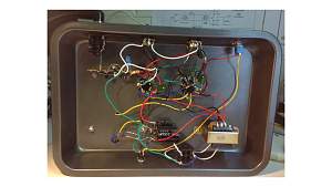

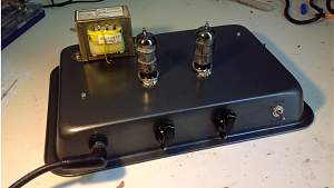

    Hi,
    Just finished building the Lamington Junior. which I gave to myself for Christmas.
    I'm a total beginner, had to practice soldering on scraps before I attempted to do any real work on actual components.
    Build took two days , approx 8 hours but a lot of that was learning how to read resistor bands and working out the correct range and settings on my multimeter.
    It was pretty straight forward, though some of the language in the instruction steps took me some time to be confident I was doing the right thing. Also some components (transformers, Capacitors) had been swapped without updating the instructions or parts list (I didnt get an addendum in my kit). Though more experienced builders may have been able to asses the substitutions and get on with it, I needed to email Greg from Valve Heaven a few times to be clear. He answered promptly and seems very enthusiastic that people are building and using his designs. I was also confused about the 10K - 100K substitution that maddogm mentioned.Click image for larger version.
ID:	23823Click image for larger version.
    Had a few newbie issues like melting insulation off wires by clumsy soldering work (had to de-solder and replace), wrong count on valve pin numbers which took a few backward steps to fix and go forwards again, poor soldering technigue which resulted in a valve socket pin filling up with solder ( had to drill it out, heart in my mouth, but it worked)
    The amp is super clean, barely any hum even at full volume Has a really nice creamy overdrive, which start to come in quite early and can be progresively dialed up with the tone knob.
    Im using it with a Burny Les Paul from the 80's with original VH1 humbuckers so it has a fat sound to begin with.
    Im building a little cabinet with a Celestion Original Series Eight 8" speaker to go with it. Definitely a small room setup.
    Attached are two pics - external - I swapped original coloured knobs for volume and tone for chicken heads from Jaycar.
    Internal - looks messy, but im happy for my first build.
    I will play around with the mods suggested in the instructions to see what difference that may make, just as a learning excercise, im happy with the sound now.
    Might have to read some of DrNomis_44 posts to get some more background.
    Best wishes to anyone else building this, its easy ( I can say that now.....). and sounds great in a small room/ garage.

    It's a 10/10 from me Scott .... mostly cos you made it work which is often the biggest battle... and bonus points for apparently not zapping the life out of yourself in the process ...
    I had a quick look at your pictures and can honestly say that my amp builds when I first started years ago didn't look any better. Getting everything to look neat and professional takes years of practice, mostly in learning what you can and cannot cut or what to do first or last so as to get that 'neat' appearance.
    Play and enjoy.... and when you get your cab built we'd all love to have a listen too...
