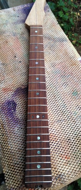

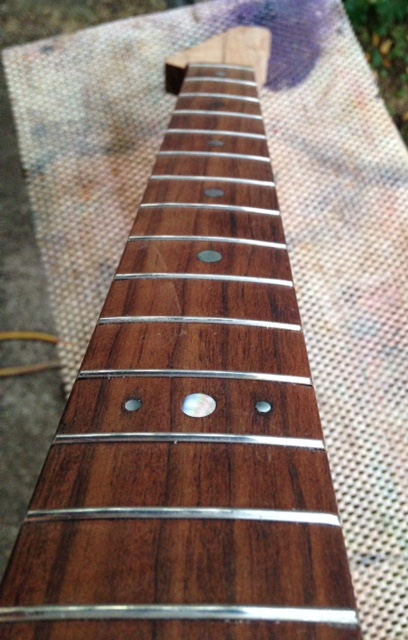

    Update on how the Blackwoodtek fake Rosewood is going
    It is now radiused inlayed and fretted
    I started out quite liking working with this material, however the following happened:
    As the fretboard was being radiused using a radius sanding block, I found that it was taking more of the lighter timber away than the darker timber so it appears that there are harder and softer areas in the timber. I thought this a bit strange considering the timber is treated.
    Inlaying did not present any problems, the wood dust being mixed with a little superglue as a filler worked well.
    Fretting presented some problems, I found that some of the frets were not seating properly and I decided to remove some and change my fret wire this caused a fair amount of flaking around the fret slots.
    Fretting was eventually finished satisfactorily with the frets being glued in. (Which I would normally do anyway by applying a small amount of titebond in the fret slot)
    Next step will be shaping the neck and then oiling the fretboard, so will then see how the Fake Rosewood feels.
    So a little problematic but not too bad, don't know if I would like to ever do a refret though I suspect you may get a lot of grain tear and flaking.

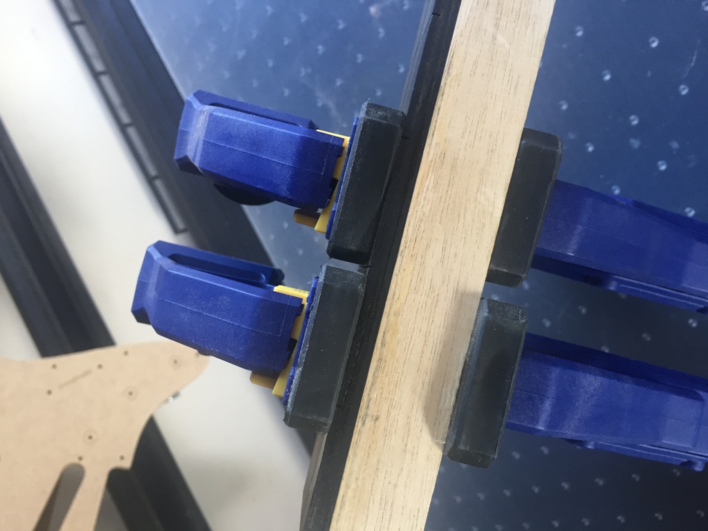

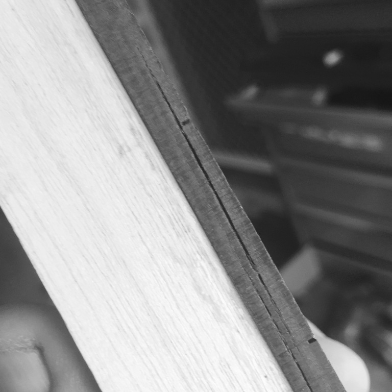

    So continued on with this neck, when trimming the sides of board down with a file found some lateral cracking in the board (minor movement) and added some glue and clamped to see if it would improve and didn't come up too bad. radiused the board, seemed to take awhile to sand and a lot more frequent paper changes as clogged up a bit (sticky dust) but came up all right.

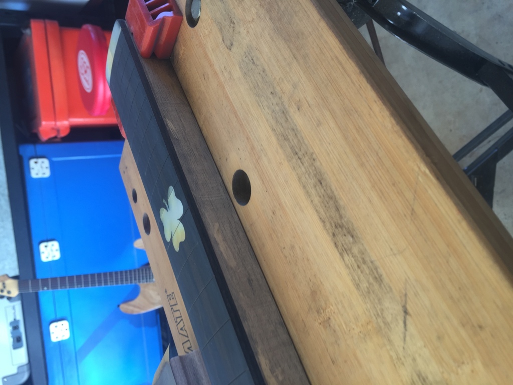

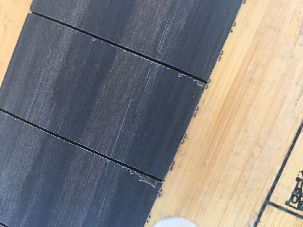

    And then it all went wrong, but not entirely a material issue.
    Fret slots were not deep enough so had to run saw through again (normally not an issue). cleaned slots as best I could and then started to saw again. Not sure if related to the sticky dust or not but saw would not easily move through the material so needed a bit more light force to get in and clear material. during this process now have more chips than Smiths on the board. It is a brittler material than timber so was a little less forgiving of my saw action. I suppose is down to difference in material verses process, as could have likely avoided if the slots were deeper to begin with. You can also see a bit of the "colour bleed" that Euroa was talking about up near the nut end of the board.
    I will probably scrap this neck as not to keen to continue and fit frets.
    So from my initial experience, I wouldn't say that it is an entirely bad material or I would never use it again, but would do things differently in the way I worked with it.

    Quote Originally Posted by vh2580 View Post
    Those chips near the fret slots make it look like rosewood as that is what things looked like when I removed frets on a Rosewood board however the colour variation once sanded is weird. Maybe we may have to add dark stains to maple if wanting a dark fret board in the future?
