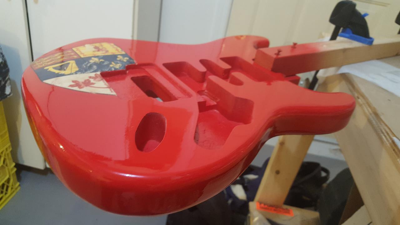

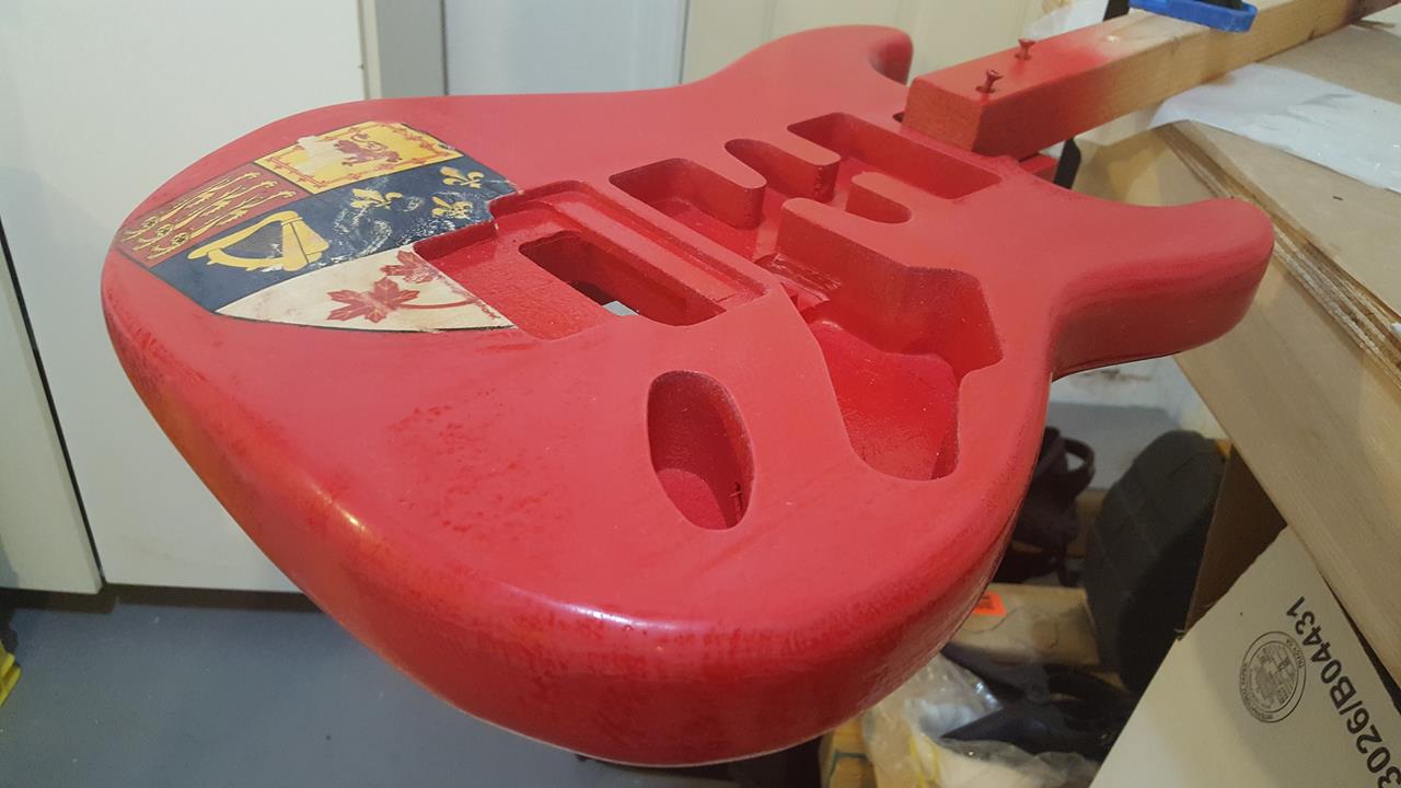

    The saga continues. So here is what she looks like after sanding back with 400 then 600.
ID:	20025 Click image for larger version.

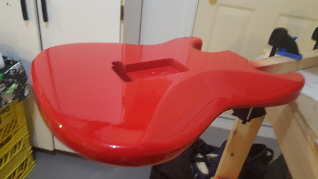

    This is the sixth (???) coat of poly freshly applied. Starting to look pretty smooth.
ID:	20027 Click image for larger version.

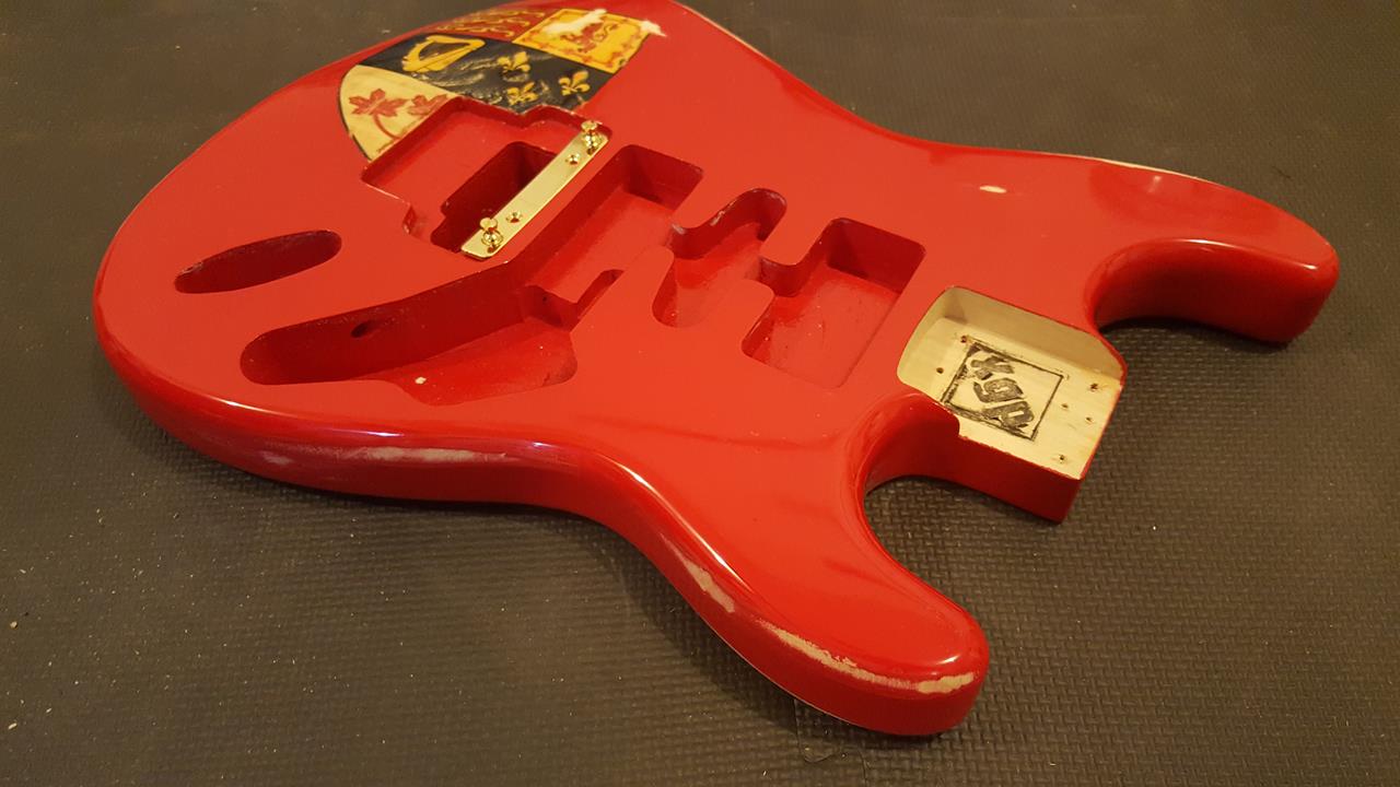

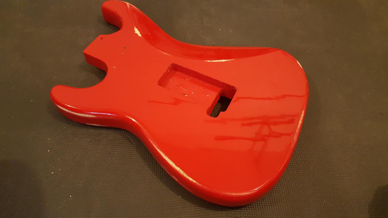

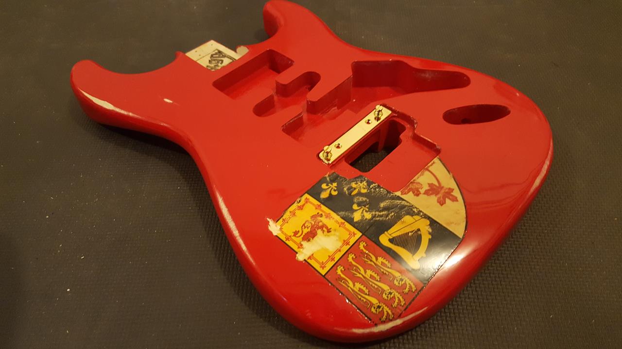

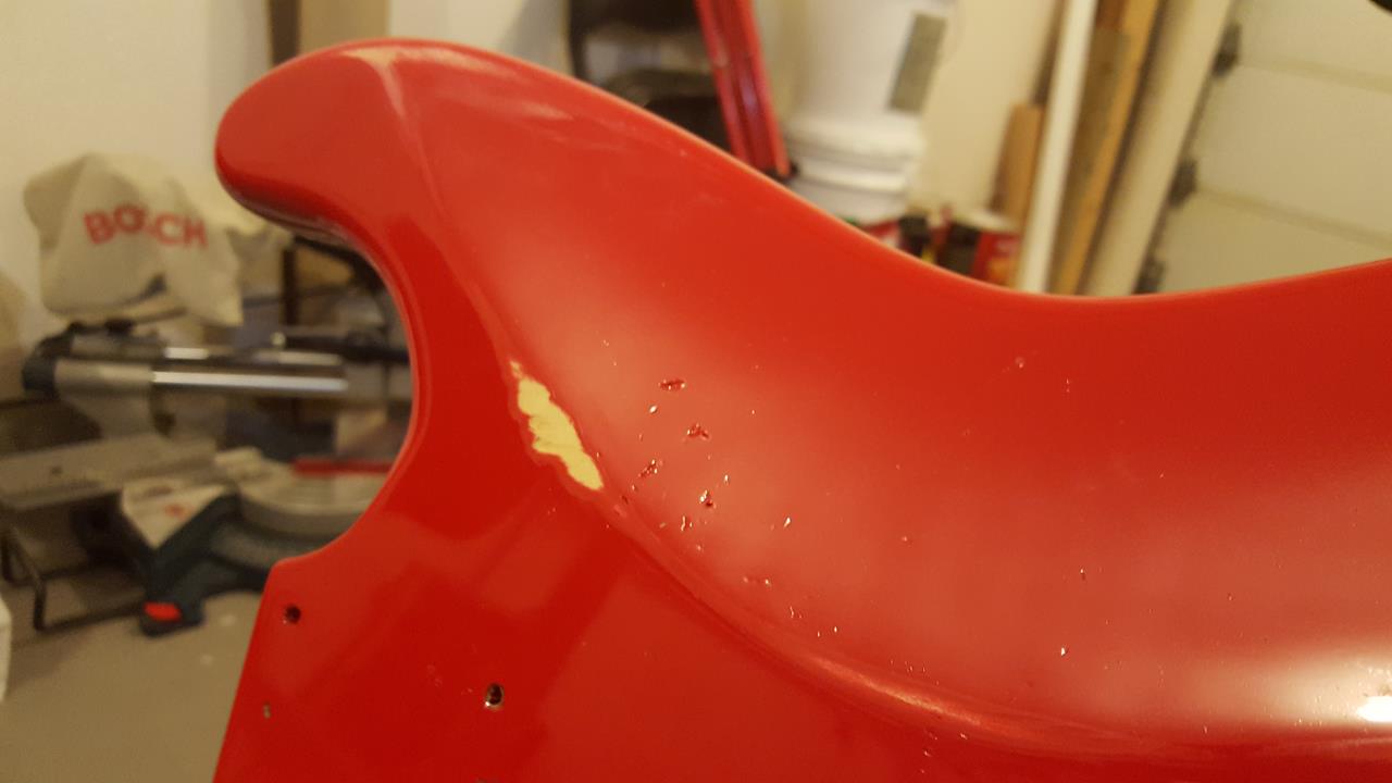

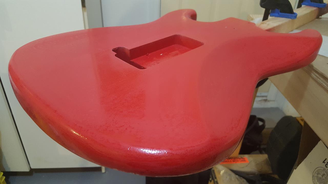

    I finally finished with the poly on the body! I then destroyed my pristine finish in an attempt to give it that 1963 feel. All things considered I don't think it turned out too bad for my first attempt at a relic job.
ID:	21678 Click image for larger version.

  8. #48
    Subtly done. Good job.
  9. #49
    came up looking good CGG. I don't understand why people relic guitars, it's like buying a new car with half the paint missing.
    Nice subtle relic though you must be happy
