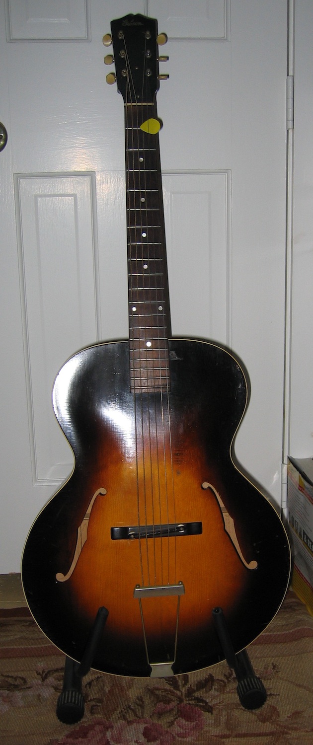

    Sanding is great for getting out of your head, and letting your mind wander...
    The first guitar I ever saw or touched or played belonged to my father, and now belongs to me - it is a 1940’s Gibson L-50 archtop acoustic with a beautiful worn and cracked sunburst finish. This was not a fancy instrument when he bought it, but a working musician’s guitar. It has been well loved, even if it has not been remotely pampered. As a young man he almost lost it in a house fire - he dashed in, grabbed it and a pair of shoes, and ran out as the house came down behind him. He played it in USO shows when he was in the army, around campfires when he was a Boy Scout leader, and he used it to teach me a few chords.
    It is wonderfully intact - only the pickguard is missing (it self-destructed - some kind of time-bomb cellulose). It's not easy to play , but it plays well. Thanks Pop.

    What a beautiful old bird that guitar is, and has family history, also from right around the same era as the 1st electric, Charlie Christian and the ES150 another classic archtop except it had a pickup.

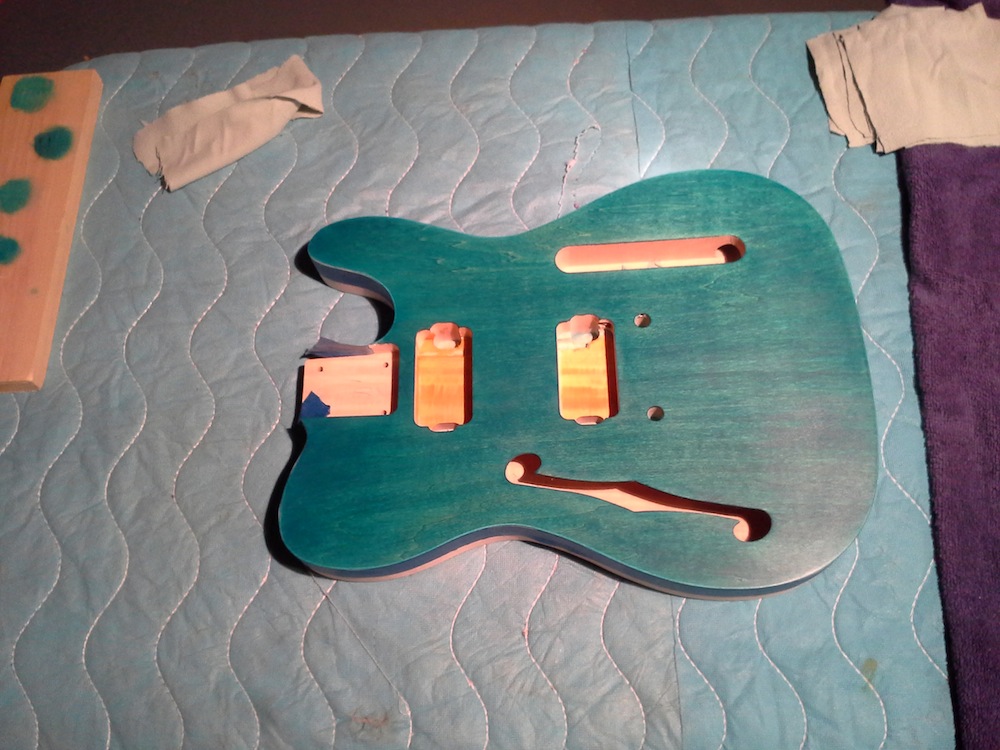

    Thanks Swanny - very interesting. I think my problem may be that I had already started with the Lady Teal (2 coats) - just now I experimented with adding a dark blue ink to a mixture of white base coat and some of the LT - I added a little, then a little more, finally the whole bottle. At each point I did a small test on some scrap that was close to the basswood.
    Small difference.
    The guitar clearly wants to be green.
    Here's the latest:
    The color in the pickup holes will be the sides and back.
    Happily, the neck and headstock are looking good.

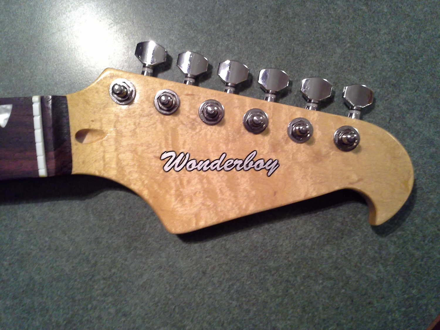

    Wonderboy Headstock
    So - here's the latest: 2 coats of Antique Yellow, 2 coats of top coat, 2 coats of lacquer, decal, 1 coat of lacquer, and I think it's done. I oiled the fretboard, and it looks and feels pretty good. I'm going to use a retainer bar instead of string trees.
    As far as the body? I added a whole bottle of blue ink, and the difference is minimal. I think the wood has absorbed about as much color as its going to. In short, karmic payback for being a difficult child; it's time to accept it for what it is, rather than what I hoped it would be. Rather than the color of the sky, it's the color of the ocean - I can live with that.
    Next, Antique Yellow on the sides and back.
    Good night my friends.
