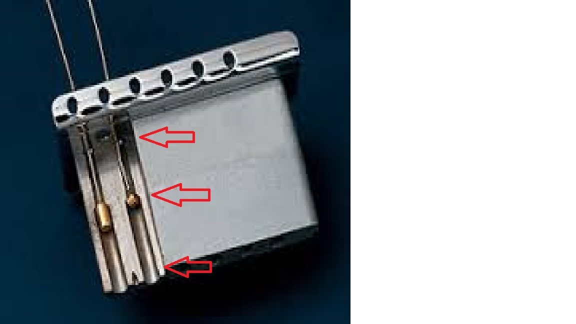

    Quote Originally Posted by Tweaky View Post
    I'm waiting a reply from post #75 i made here [link below] on a particular Tech question regarding the Babicz trem bridge.
    http://www.buildyourownguitar.com.au...?t=4482&page=8
    Like you, I know how to set up a Strat for a floating bridge.
    Until I get a answer to my question, I'll reserve judgement on that Trem bridge design.....But IMHO, after going to every available site that shows the design.... it's premise is based more on mass than lessening the string break angle at every possible point, which is the WANT when using a tremolo.
    Oh....that's a fairly easy one to answer, the ball ends are held where the bottom arrow is, inside the sustain block where the strings pass through it, you can see that the hole diameter has been enlarged for part of it's length, this creates a ledge which the ball end sits against under string-tension, this serves to anchor the string so that it can be pulled up to pitch by the tuning machine.

    So you are saying it's at this lowest arrow point....correct ?

  4. #44
    So you are saying it's at this Multi arrow point....correct ?
    Have a look where the ball-ends are (those pieces of brass at the end of the strings) (the middle arrow, I didn't notice the arrow right at the bottom since it's hard to see it against the background colour), now where those ball-ends are is a ledge that they sit on, that's what anchors the ball-ends.

    I looked into the break angle from the trem bridge thing a while ago for my Frankienstrat build, as well as getting rid of all the other break string angles as possible.
    I ended up getting some GOTOH HAPM tuners... these are infinitely height adjustable, great tuners, but I had to import them, and they have their idiosyncrasies ....but, what I mean is, get staggered tuners, plenty cheaper than the ones I bought.....you can get rid of one friction point by using them.... and that's the string trees.
    The BEST find though, was the Trem bridge.... it ticks all the boxes.
    Solid steel trem block around 14mm thick, countersunk string holes in that trem block, result is that the end of you strings wrap wires are protuding out of the saddles, result is a very shallow string break angle... buy the way the string saddles are solid steel as well.
    So what brand is the trem bridge, as how many kidney's do you need to sell to get one ?
    It's a Wilkinson 5 + 1 bridge made by GOTH Japan, current Aus price at Realtone is about AUS $65...push in trem arm adjustable by small screw at side of bridge ....it's the real deal...recommended.
    http://www.realparts.com.au/bridges-...style.html?p=3
    With the Tuners and trem I can dive bomb to the max and up to the max, several times....let the trem arm go and the guitar will still be in tune.
