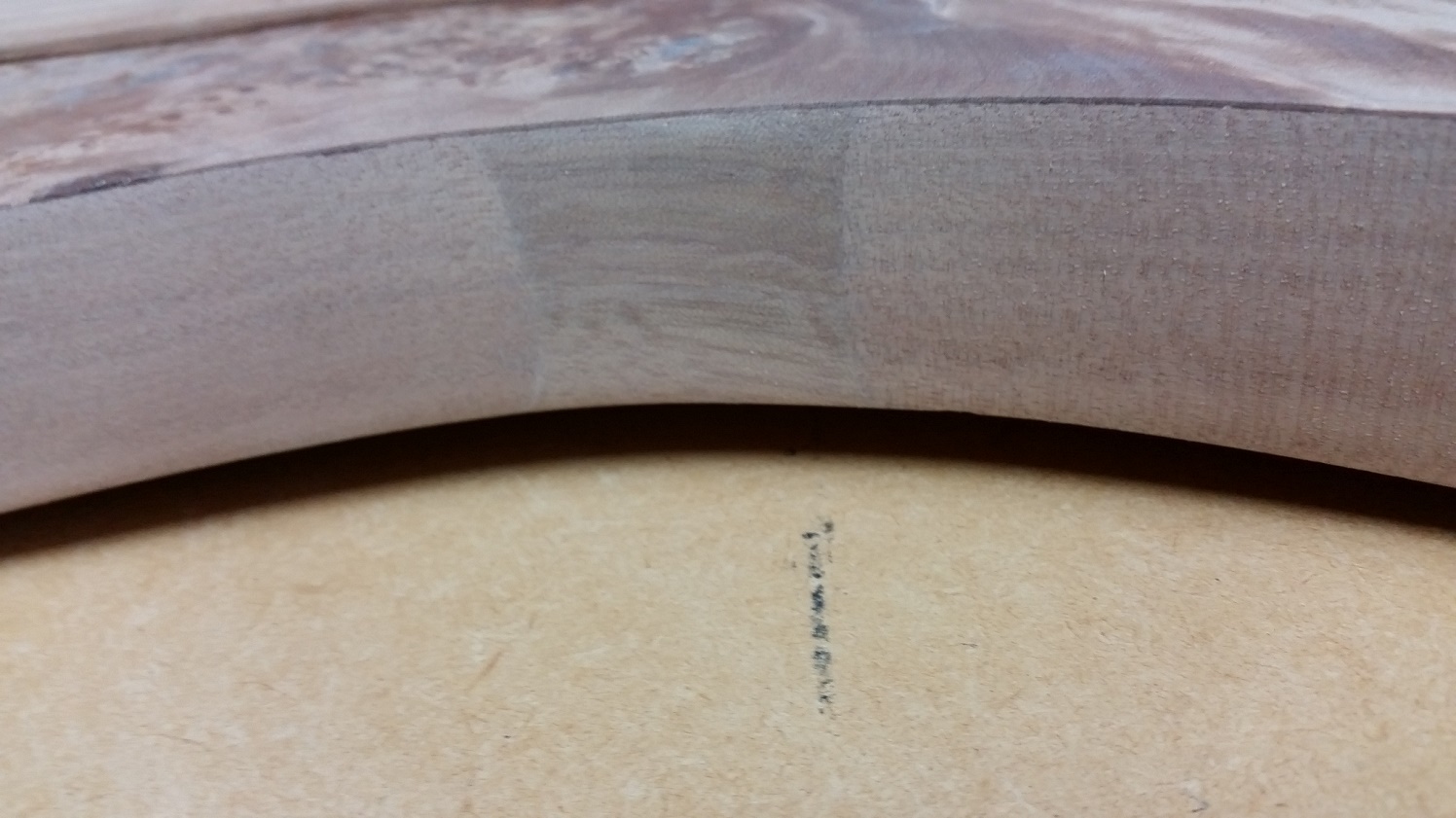

    Next step was to sand the sides of the body to remove the excess glue and make the join between the body and veneer as neat as possible. Was going well until I sanded through the outer piece/plank of the body on the left side. It's only cosmetic, with any luck between grain filling and staining it won't be too noticeable.

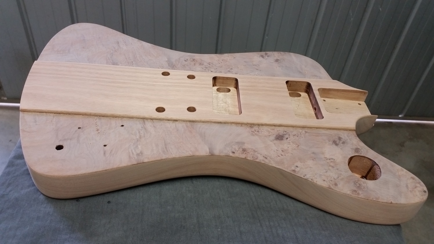

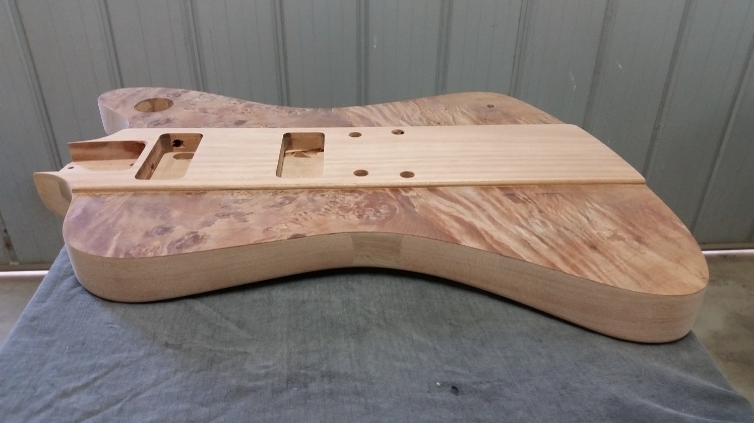

    And a shot showing the front.
    Body is sanded to 180 grit and gave the veneer a light sand with 400 grit.
    Really don't want to mess up the veneer by getting Timbermate or stain on it so gave it a coat of vinyl sealer, light scuff with 400 and brushed on one coat of poly to seal it and hopefully prevent any mishaps. Will still mask it up when dry enough as an extra precaution (can you tell I'm a bit paranoid about it?) Before
