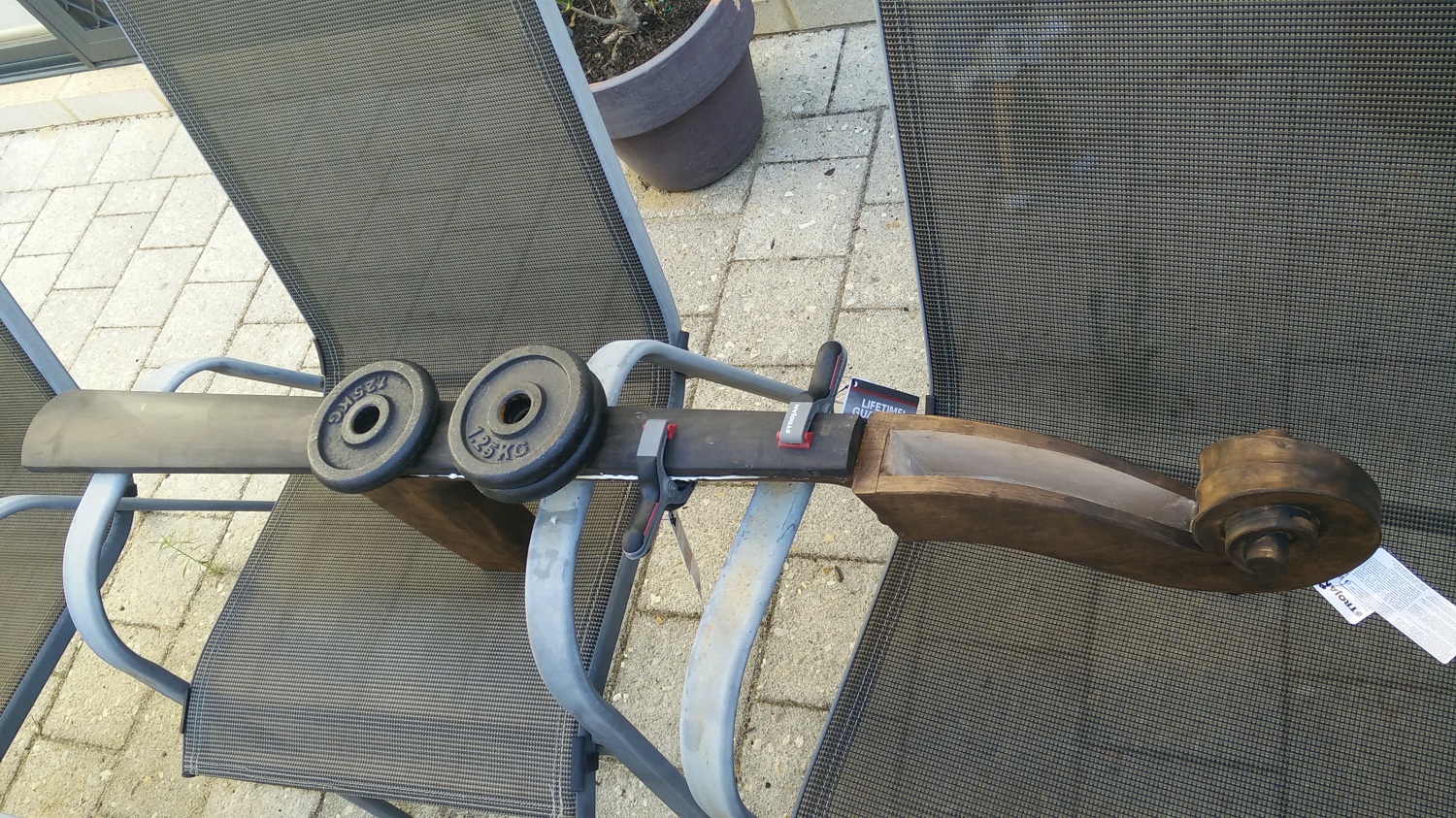

    I went to the big green shed to get some clamps, glue and some wood.
    I bought the wrong sized wood for it to be most convenient (too small)...... So... Yeah. But I'm slowly cutting out pieces that are about 11.5 inches long. Planning to sand them down so they're flush. My only available saw is a coping saw - cheap and nasty... It's hard to cut straight so I should have cut 12, probably.
    I bought some crappy, small, spring squeeze clamps. I bought a size or two too small. I shoved them on the neck and fingerboard while in my computer room. The clamp slid off at the fatter point of the neck and went flying across the room, hitting me in the face. Almost lost an eye (thanks Bunnings).
    I've glued the fretboard down. Used too much glue if anything, but I guess I can fix it later. Keeping an eye on it now to make sure the fretboard doesn't drift off centre too far while drying.
    I dunno guys. I'll get it done but it might not be pretty.
  8. #48
    Pictures.
    Note: These clamps are dangerous (and also too small for just about anything as I found out - bits of wood are actually bigger than they seem). I do not recommend them. I will probably return them if I can. Otherwise I'm going to have to take up some kind of hobby making.
    Setup isn't ideal. I figure if there's a problem I can fix it later. As it is now it seems "FINE".
