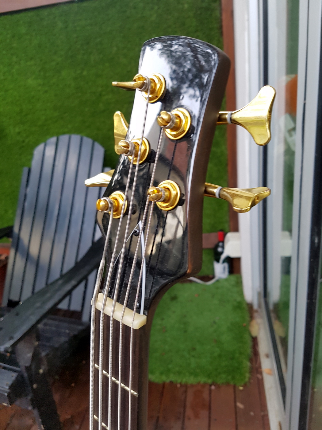

    The kit came pre-drilled for headstock and bridge and they must have had their template wrong for the headstock... The side with 3x is okay, but the one with 2x looks very weird. I'll have to fill this one (with a toothpick maybe?) and re-drill:

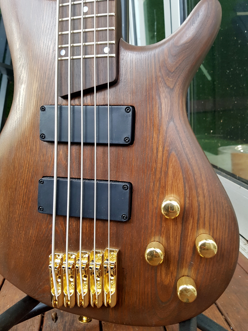

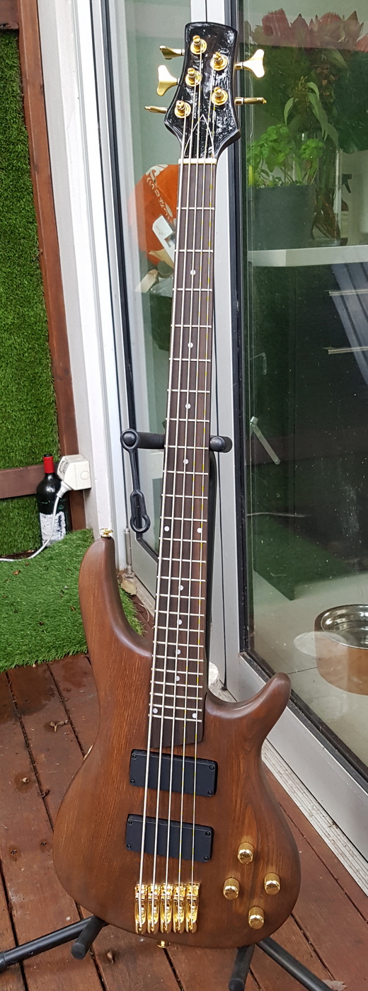

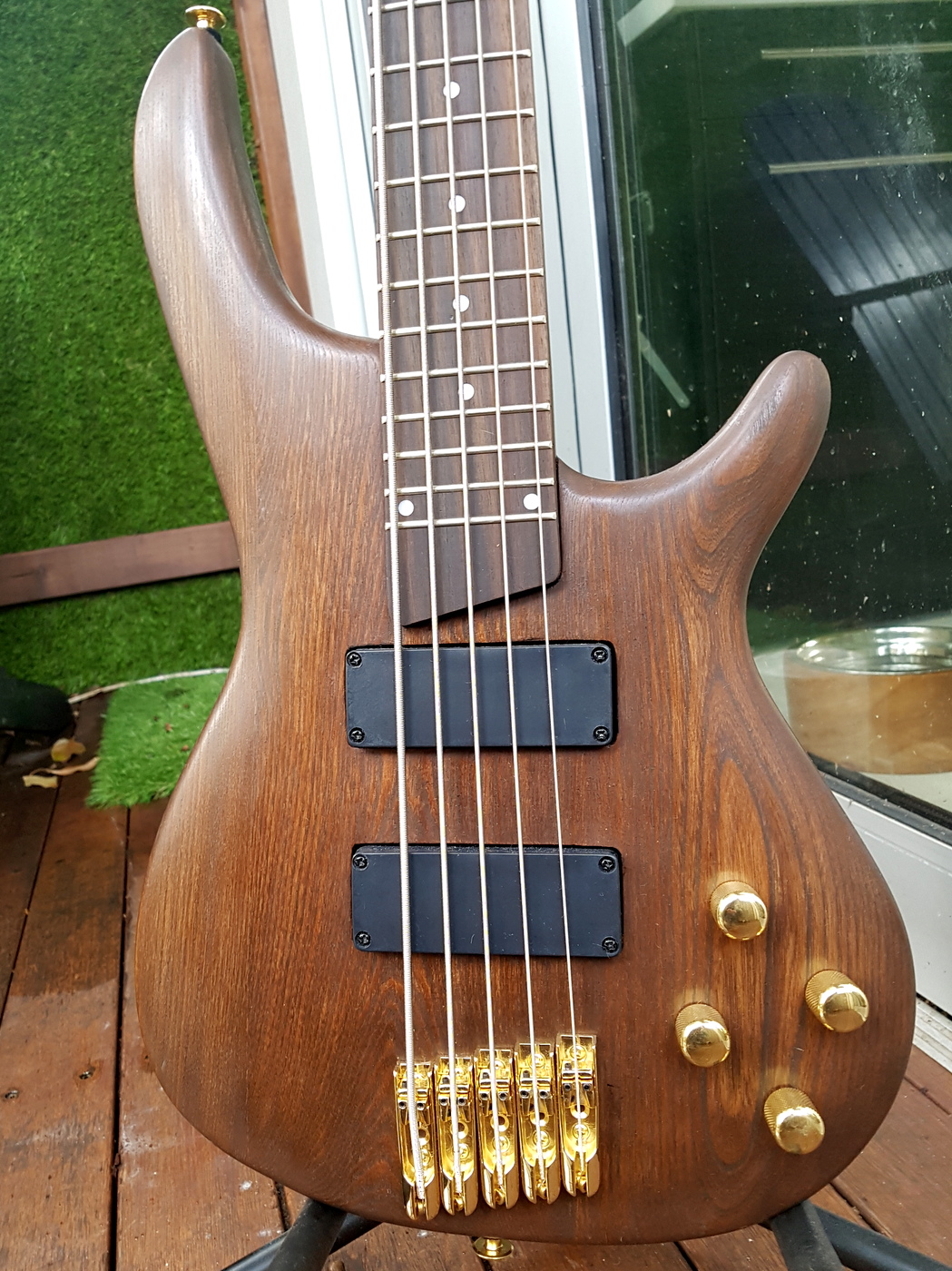

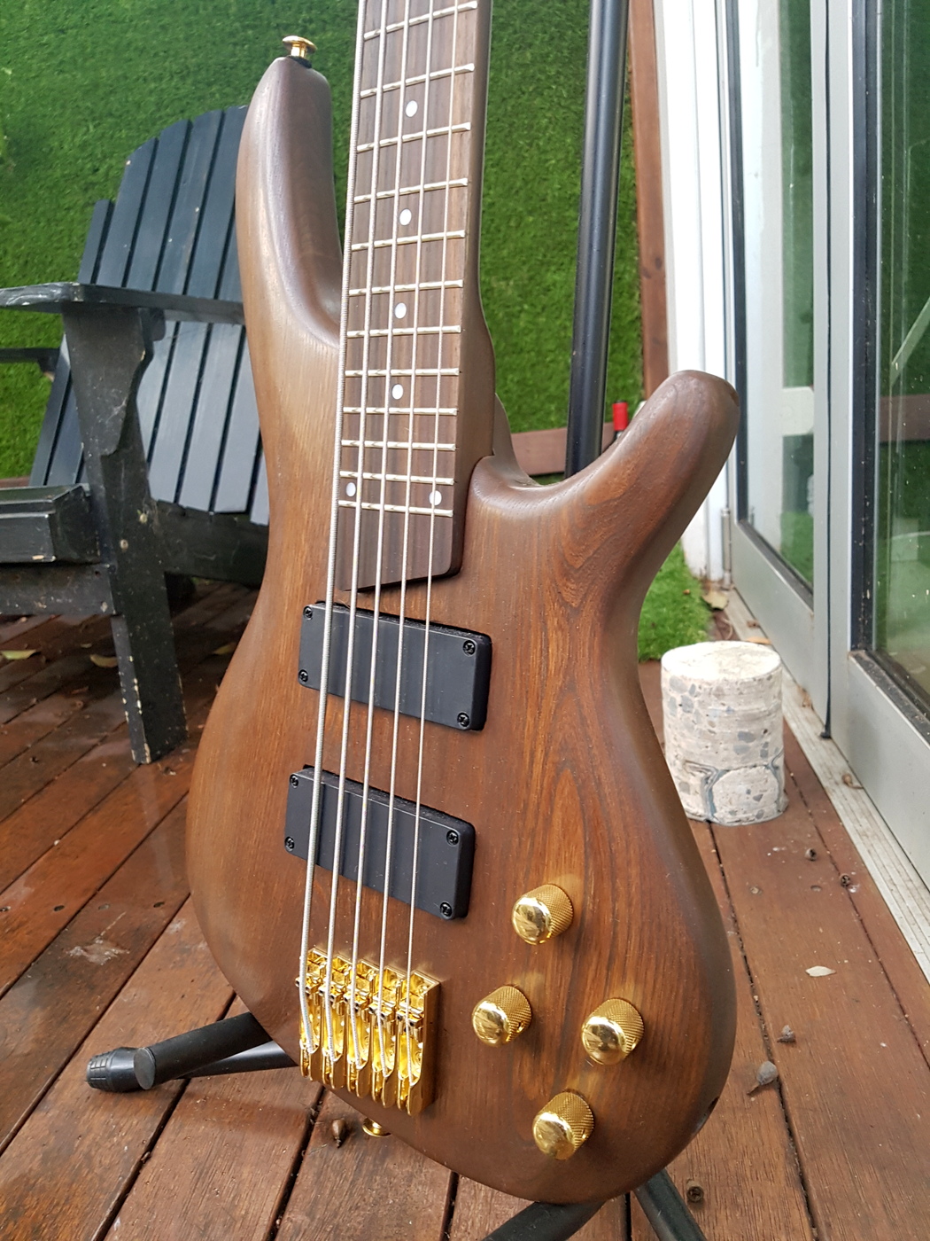

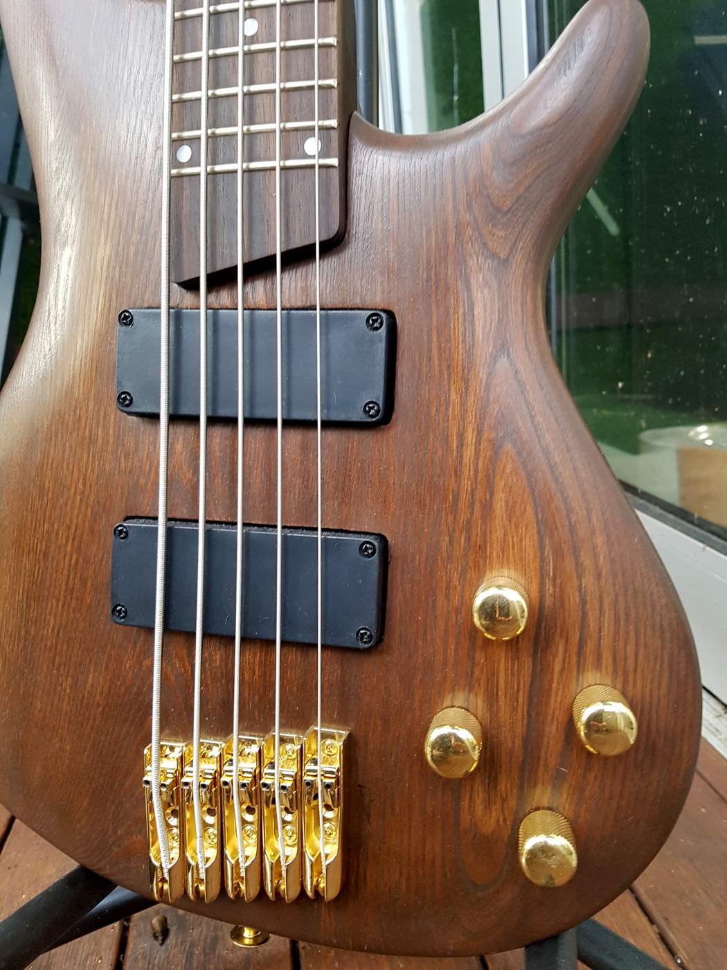

    Also I want gold hardware instead of black, so I've ordered gold replacement parts for everything. Thank you eBay!
