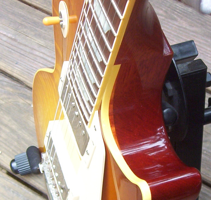

    Incidentally, until the demise of the LP Standard in 1960, the original Les Paul's binding followed the curve of the top in the cutaway. So you always got a section of the maple cap showing, like this:
Name:	Les Paul Old binding.jpeg
    Only after the reintroduction of the Les Paul to the Gibson line in 1968, did the binding start following the line of the maple cap in this area. Even now, it's only the historic style Les Paul reissues that are produced with the top curve-following binding.
