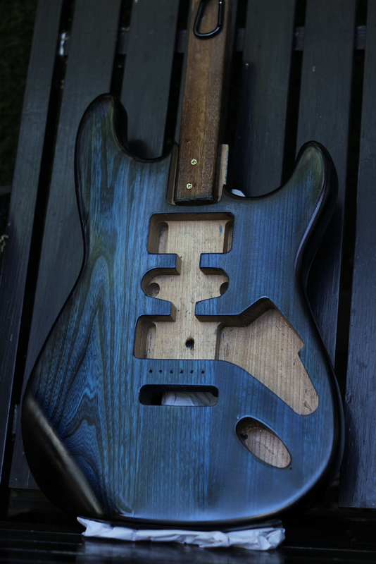

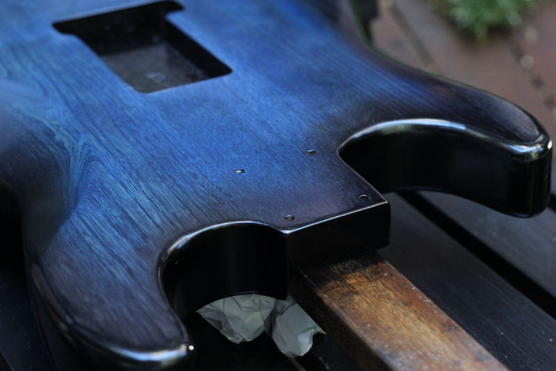

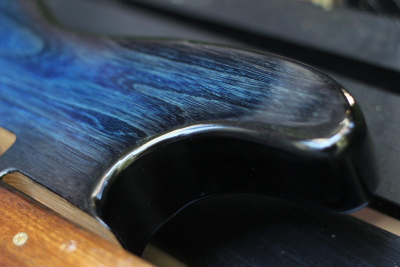

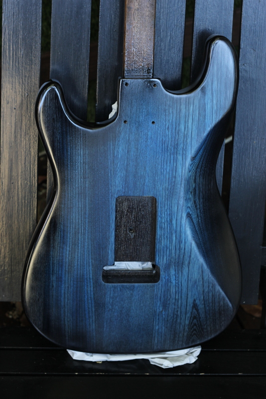

    Haven't posted anything for a couple weeks, but I've been steadily working on the guitar.
    Last weekend, as I had a fair bit of gloss on, I sanded the whole guitar flat. Took me a fair bit of sanding at 600-800 wet.
    I then sprayed again and let that cure all week.
    Same deal this weekend, I still had too much grain showing for my liking, so I sanded flat again.
    And sprayed again...
    I'm pretty happy with the result now:

    I had that idea of adding gold highlight to the blue, so this morning I mixed some mica powder with clear gloss for one of the coats.
    Not the best results... I reckon I put way too much mica powder and it was showing too much in some areas.
    So I ended up sanding most of it and re-spraying clear on top.
    No photos yet, we'll see next week!
    Anyway, one last final touch up spray tomorrow morning, and then I'll leave this one alone for a couple weeks while it cures.
    On the neck side, I wasn't too happy with the finish. I used Dingotone clear but must have been too heavy-handed and didn't squeeze the excess enough before wiping for the final coat as I had some waxy looking areas...
    So I sanded it with 600 dry to remove all these waxy area until I was happy.
    I then wiped a new top coat on. This time I barely had any product on the applicator and it does look better.I'll wipe a 'last final' coat next weekend and that should be it for the neck!
    In the meantime I got myself a nice IB-5 kit...
    I'm waiting for golden parts I ordered from eBay, and for some custom Dingotone before I really get started. I'll created a build diary for that one too.
    Cheers

    Fred that looks pretty smick really nice shade of blue and you have brought out the grain beautifully.
