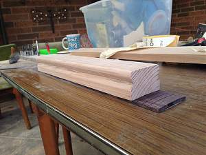

    on the weekend i finally had some spare time so i jumped at the chance to work on the guitar.

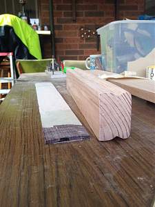

    First i made sure the fret board was 12" radius which it was so i stuck it down to my bench and put 40 grit sand paper on top of it and started making a radius block, i went through the grits until 320 and this is what it looks like now.
ID:	4883Click image for larger version.

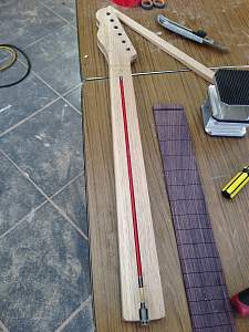

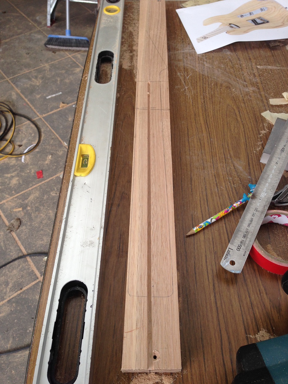

    After i made my radius block i started on the neck. Im following a youtube channel Flecher guitars, he has a step by step guide on how to build a guitar first up was to route the channel for the truss rod, Click image for larger version.
    after abit of stuffing around with the chisel to fit the barrel in i got the truss rod
    in Click image for larger version.

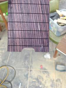

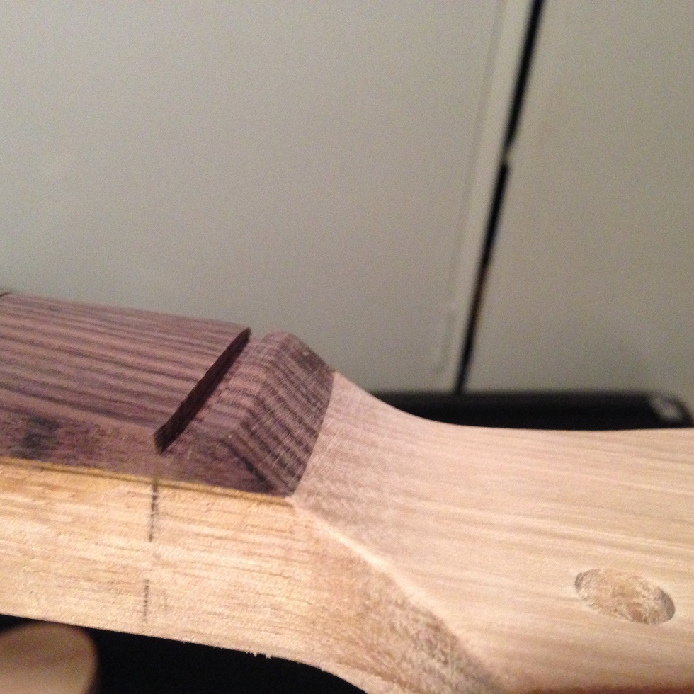

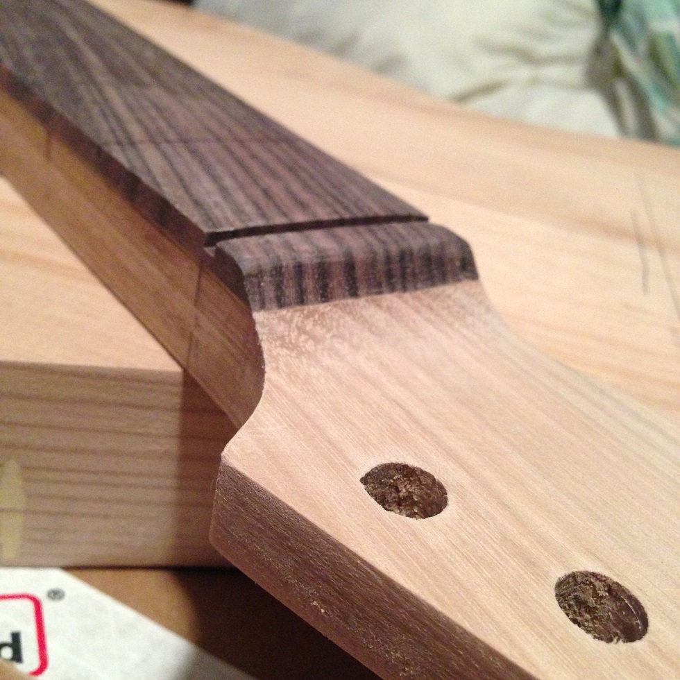

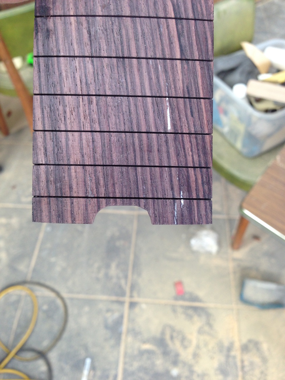

    After that was done i had to notch out the end of the fret board to fit over the spoke, Click image for larger version.

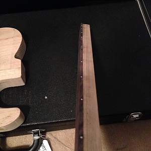

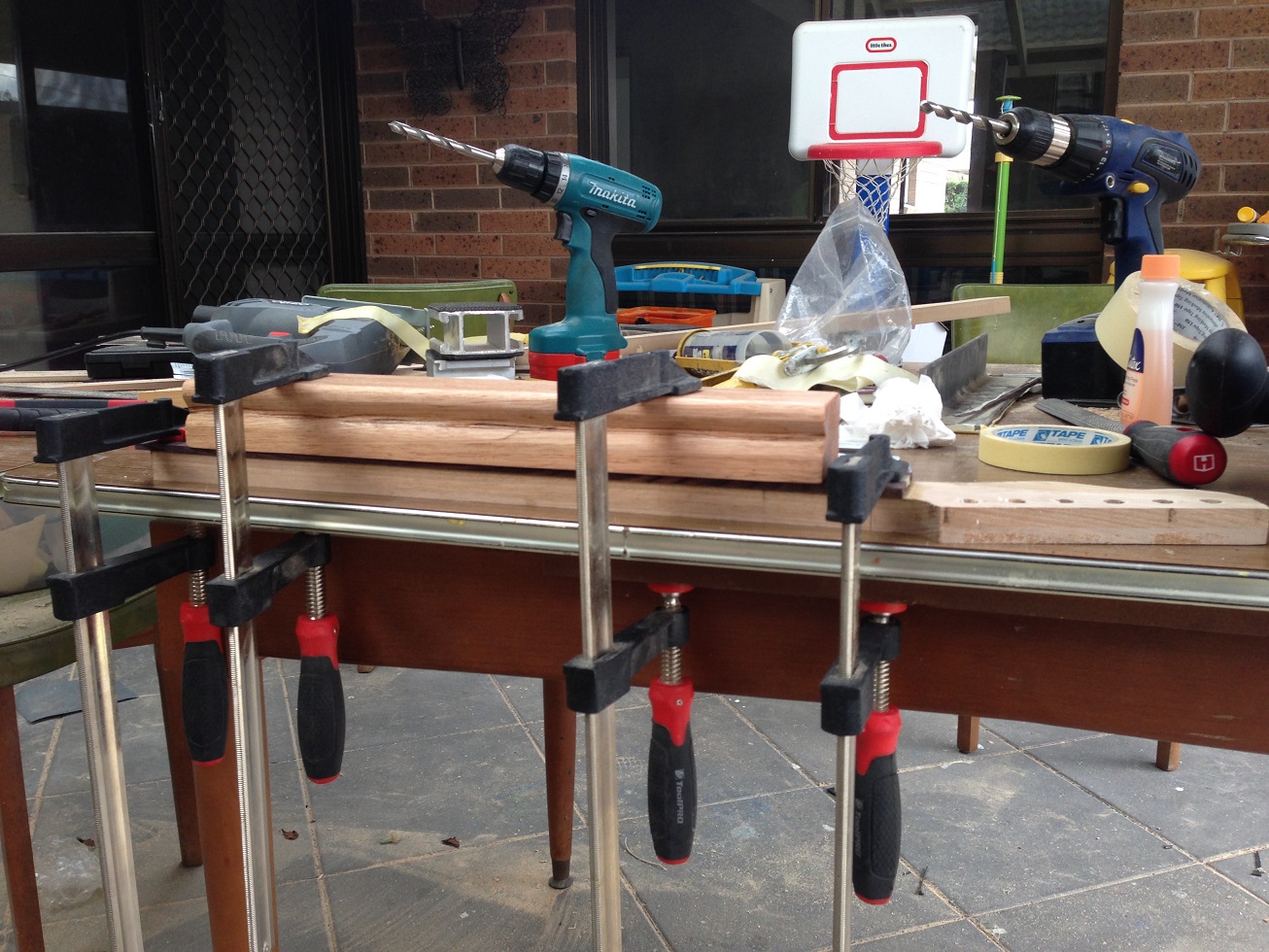

    next step is to glue fretboard on Click image for larger version.

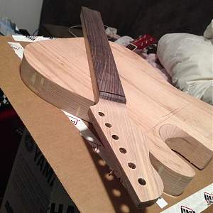

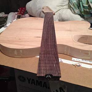

ID:	4888notice my freshly made radius block, came in real handy for the fret board glue up, after it was dry, i trimmed up the fret board edges, thicknessed the headstock to 14mm and put the radius from the fretboard to the headstock. Click image for larger version.
ID:	4889Click image for larger version.
ID:	4890Click image for larger version.
    so next will be shaping the neck.

    Farnzie well done that neck looks awesome. You really have done your homework. Are you putting dot markers on the fingerboard ? Should be done before you bang in the frets.
    So it looks like a reverse headstock ?

    Thanks wokka, no fret board markers, just going with side dots, im am indeed going with a reverse headstock.
    Oh man, you are showing a few of us how to do it (me included). Are you sure you haven't done this before?
    haha, nah i haven't built a guitar before, infact i have never built anything from wood before, I'm a steel fabricator so i been working with hand tools,welders and machinery for 13 years.

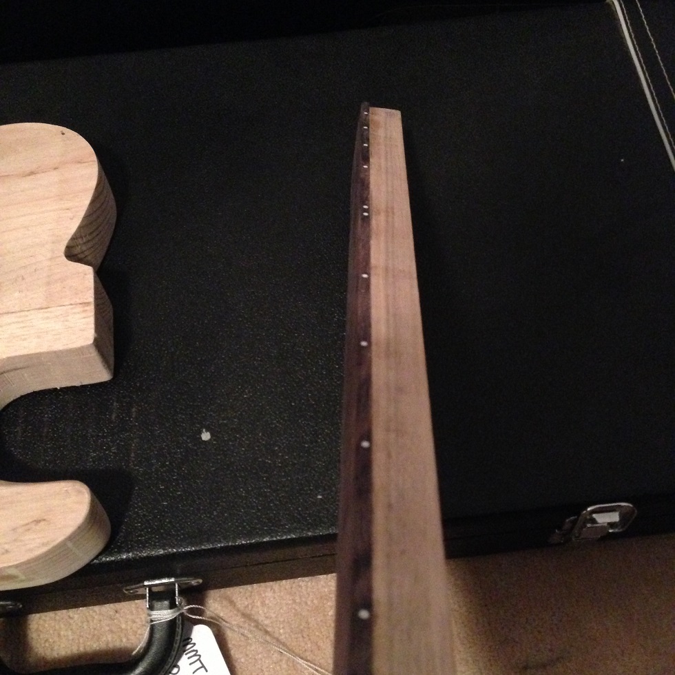

    I had an hour after work today so i installed the side dots, and i reshaped the trasition from fretboard to headstock, i gave it a bit more of a curve.
ID:	4932Click image for larger version.
