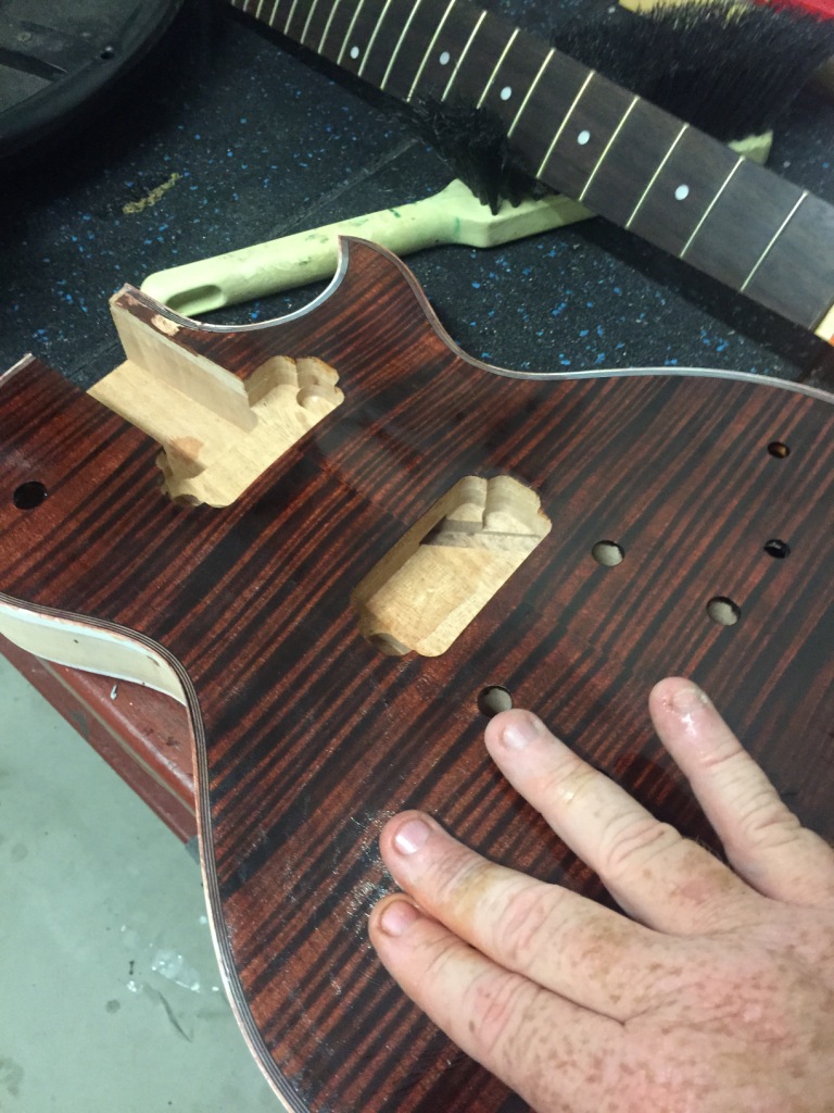

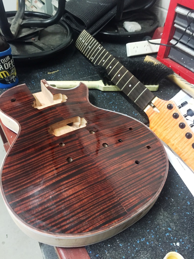

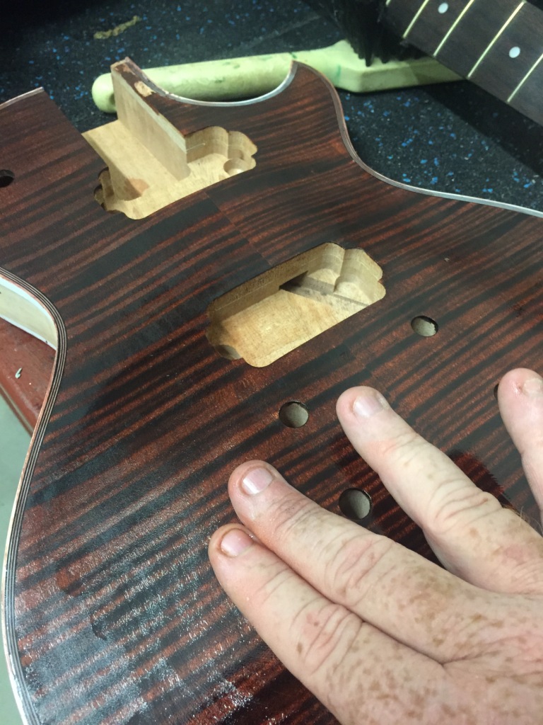

    Mentor vh2580's Avatar
    Cleveland Qld
    1,184
    Arzi, It may not help now but after watching a few guys on youtube doing gunstocks with tru oil, the first few coats I have been doing with my fingers and rubbing circularly until it start getting really tacky and then putting a little more on the fingers and continue rubbing until drying. Once dry I give a quick rub back with 0000 and then do again. Seems to be working especially with maple caps which always have divots and cutting tears.

    Tony
