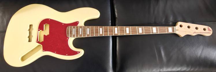

    3,087

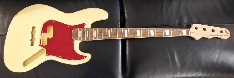

    I chose the color to go with the pickguard, but I hadn't actually seen the color+clear together with the pickguard until now.
    I sort of wanted to see how it would look with the rest of the hardware I plan to transfer from my old SX Frankenbass to the new bass. But that would be a fair amount of trouble, since it's all still attached to the SX. All I have taken off the SX is the pickguard, so that the bass is otherwise playable.
    The finish won't be hard enough to sand for at least another few weeks, but I think it's hard enough for me to begin some gentile attacks with a razor blade. I have used the taped razor blade trick to good effect in the past. Keeping fingers crossed that it works this time as well (although I admit it's hard to hold the razor blade with crossed fingers).

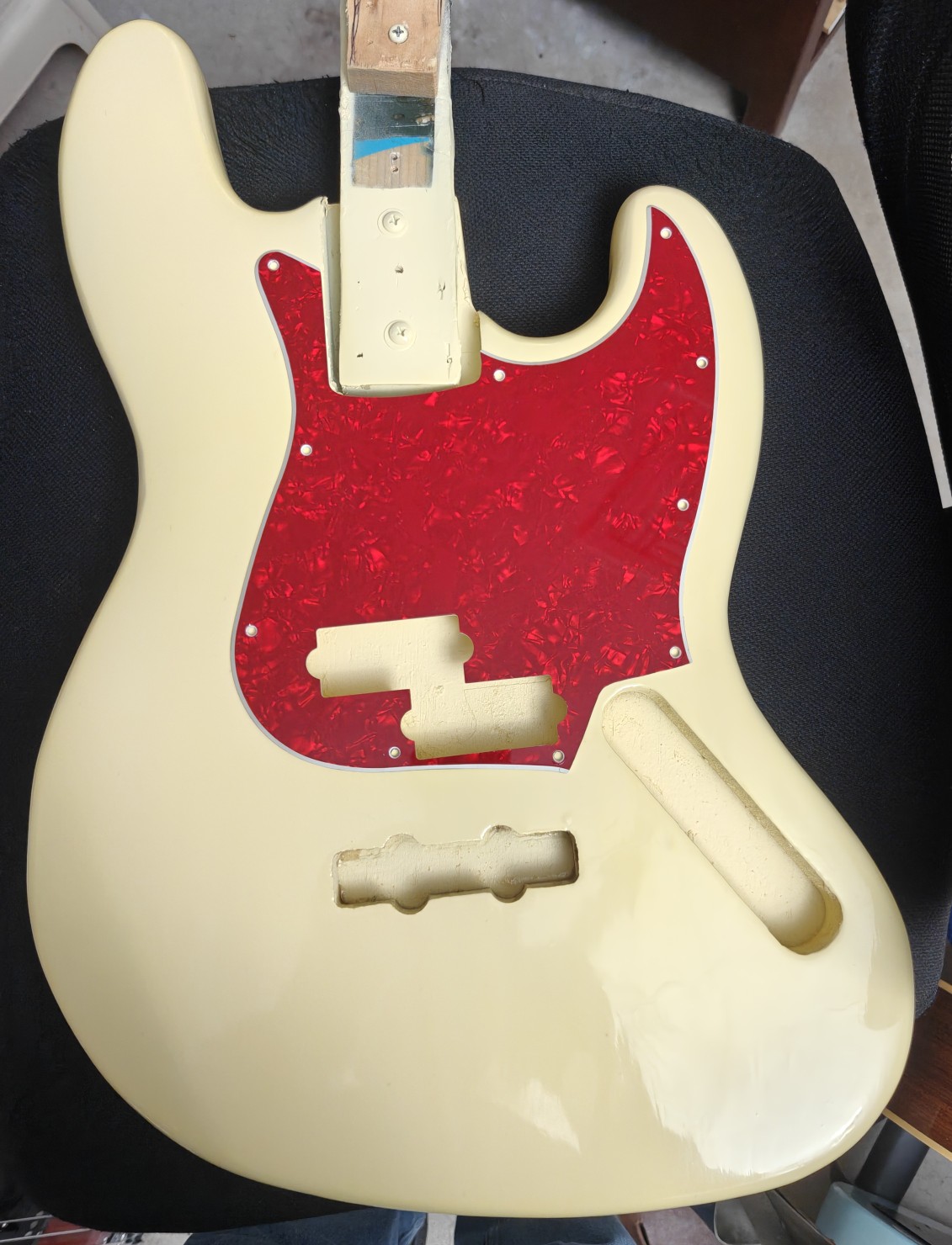

    I went round 2 with the razor blade and got pretty much every small run, drip, and bump flattened. Carefully removed tape from the neck pocket, and fitted the neck.final sanding and polishing to do...Click image for larger version.

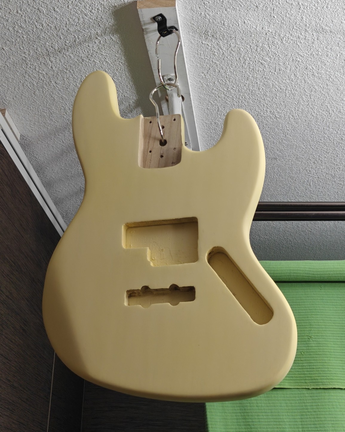

    Not as shiny now. I just finished sanding to where I am currently doing the backs of necks. Will move to buffing next, but need to clear the space around the drill-pres. Will move to the buffer next.
    I have a Tele body pretty much ready as well, and the necks... Will need the drill press for mounting the necks as well.
  9. #49
    3,087

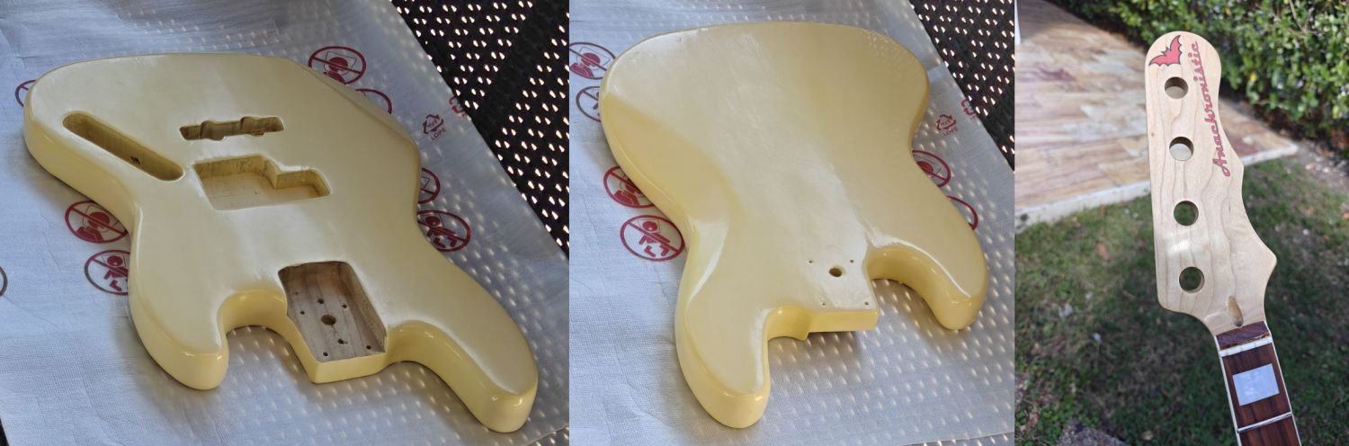

    It's funny--in the pics--this actually looked shinier when I hadn't done anything to it yet. It would, however, not have passed the 3-foot viewing rule. At that point it had had some flaws that needed flat sanding. Couldn't get a pic that would do it justice, but body is pretty much as shiny, but a LOT flatter. Headstock also shined up nicely. You can only see a little of the fretboard but I hit it with a few coats of block oil and it is a much darker, nicer color than it was in the pics above.
    I just need to polish the frets and I should be able to begin assembly. May pause to light some incense and rub Buddha's belly for luck that nothing cracks when I do the final drilling ;-)

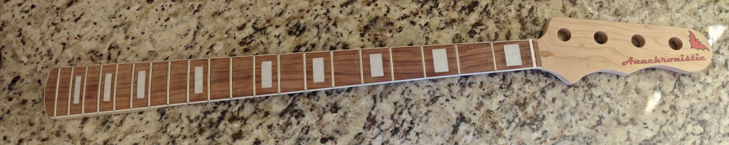

  10. #50
    3,087

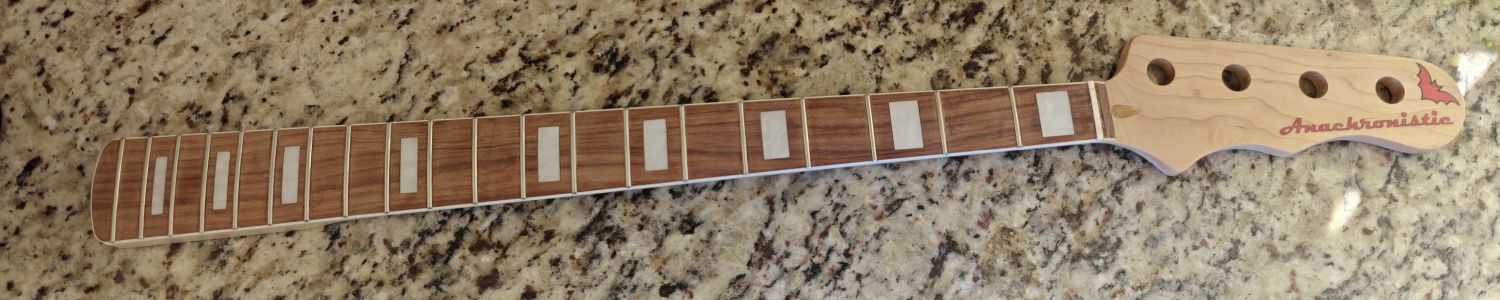

    The bright spot in my polishing adventure this weekend was polishing the frets on this neck. It's finally ready to move from finishing to assembly. Whew!
