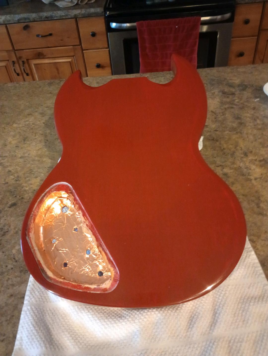

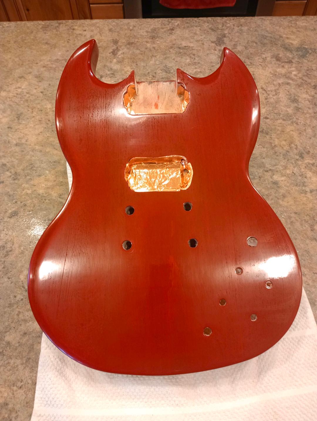

    Well, surprise, we are still alive up here. February was a whirlwind, and March is even worse. But some progress has been made. After the paint and clear coat had adequate time to dry and cure, it got a couple of treatments with Meguiar's Ultimate Compound, then Ultimate Polish, and finally, Cleaner-Wax. The routs have been lined with copper tape, and all that is left is assembly. I'll get photos when I can catch my daughter again.

    We are starting to warm up, and the horses are beginning to shed. So I had better finish before there is too much to do outside. Hope things level out for you, TD.
    Finally got some help, so here are the final pictures of the body. I got a pretty good gloss. Now we start assembly.

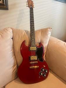

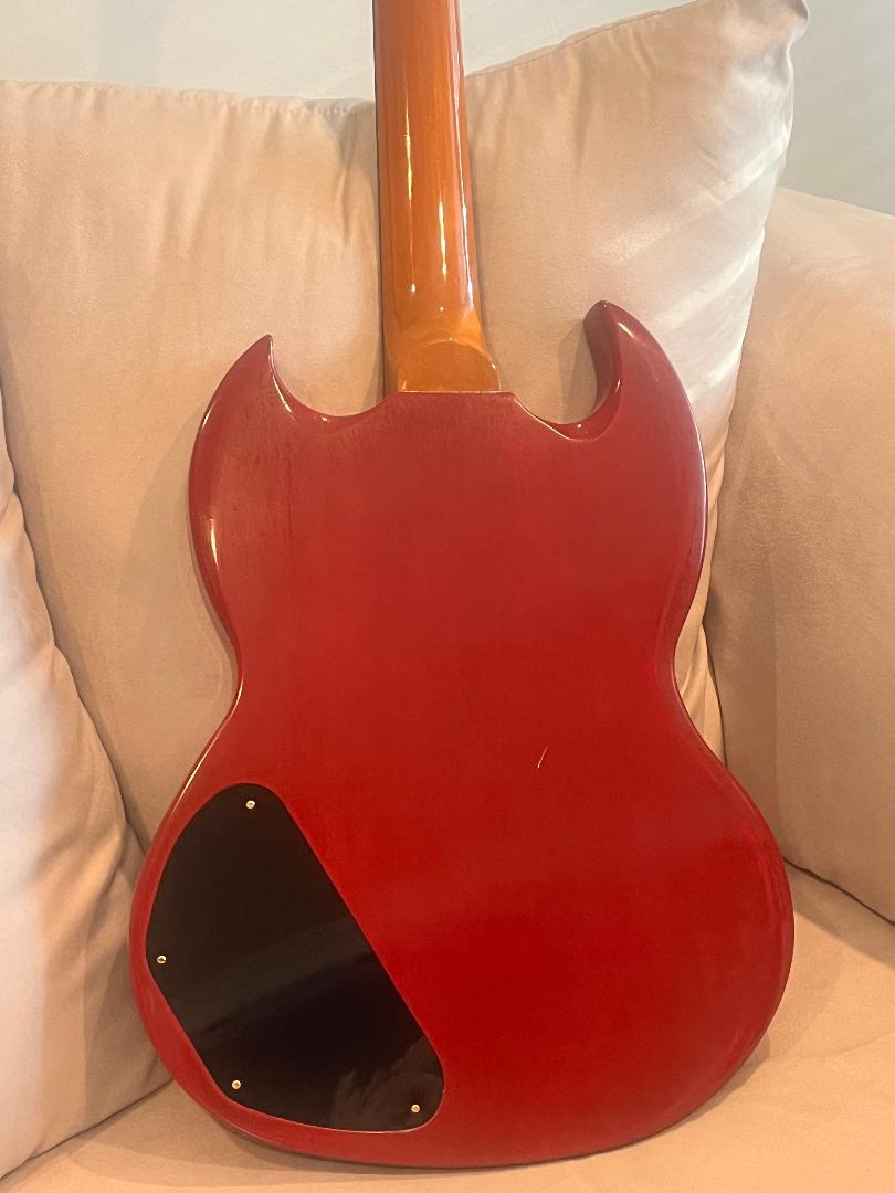

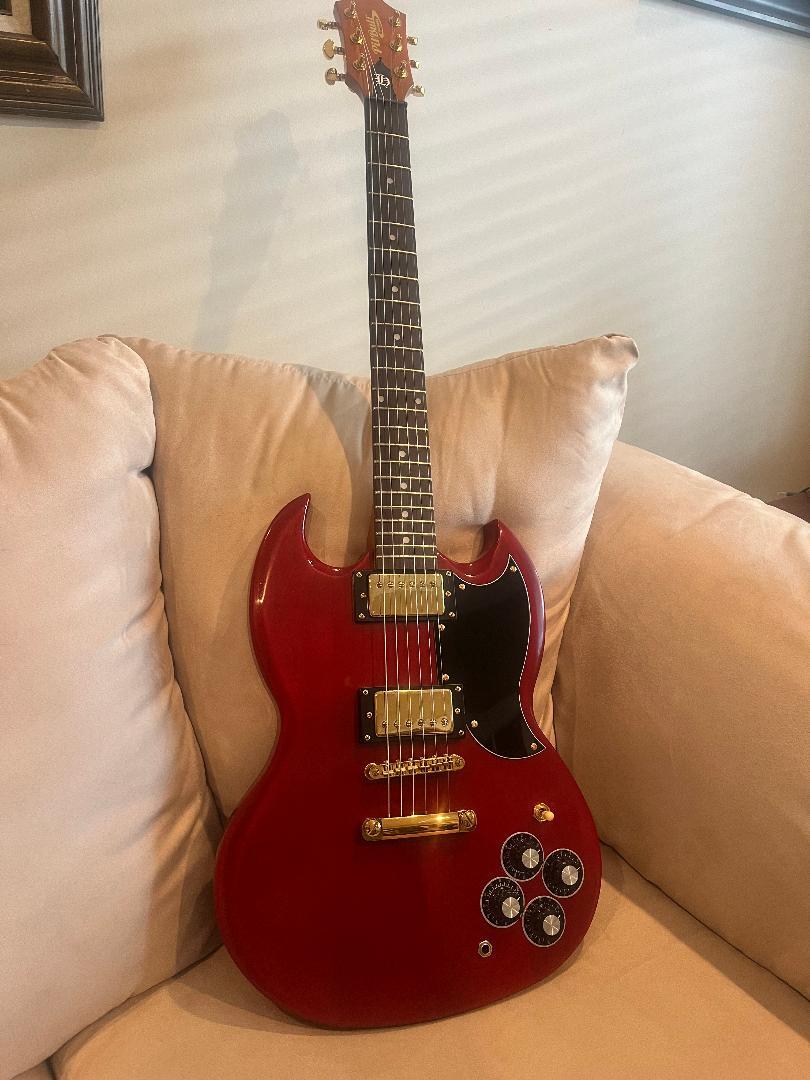

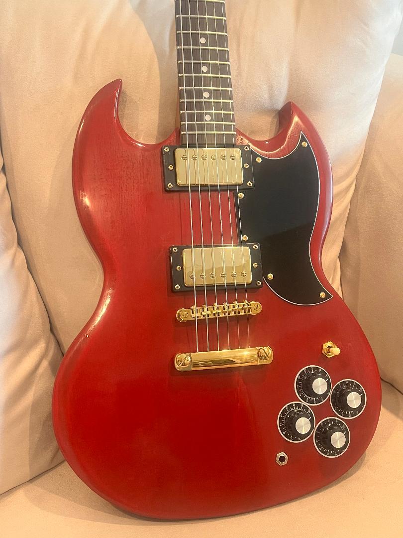

    170
    Well, just about the time you probably thought I was dead or in jail, #5 is finally finished. I like to wrap up before hot weather hits us up here in the north, but not this time. Color turned out very nice. Grover tuners, custom truss rod cover, up-graded tone and volume knobs from StewMac. Otherwise, stock PBG. I had higher hopes for this build, but it is what it is. My work on finish and assembly is not as good as I had wished, and the neck angle is a little too steep, so the guitar cannot be properly set up. Action is too high, and that is the way the kit came. I had the same problem with Blue #2, also an AG style, and thought it was something I had done wrong. Apparently that is the way they come. BTW, a while back I tripped in my messy office/guitar room, knocking the blue one over, and breaking the glued-in neck loose. No other major damage. I have done a little sanding in the neck pocket, hoping to lower the strings and improve the action. We'll see.

    Wow! It really looks great. Exactly the way an SG should. Nice touch with the controls. Makes me nostalgic for "the one that got away"... A similar looking SG with gold hardware, on sale in a Seattle music store. I should have bought it. Been thinking about it ever since. If you can get the action where you like on the other one maybe this one could be for channeling your inner Derrick Trucks. ;-)
