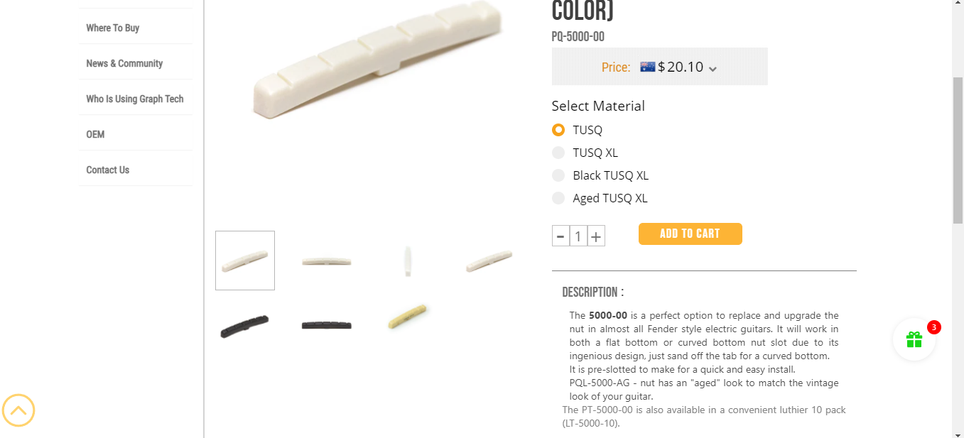

    Actually those nuts are intended to be used for either a flat bottom nut slot or a curved bottom. It's not optimal IMO, but that's what Graphtec does.
    For a flat bottom slot, you have 3 points of contact. They generally still need a bit of sanding on the bottom so you do gain a bit more contact area on the ends. For a curved bottom, the middle "tab" gets filed away.

    Thanks guys, as McCreed says this is how graph tech sells them for flat bottom necks as well as curved. I too not find it ideal, but it was the only lefty I could find for this neck.
