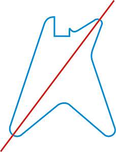

    Much to ponder there Jim! I don’t quite get your first paragraph, perhaps a drawing?

    Quote Originally Posted by impala59 View Post
    I don't quite get your first paragraph, perhaps a drawing?
    Does this help... Straight lines in blue, radii in red. All the way through in this version there's always a straight line before each radius, and the radii are arcs of circles, not compound curves. I tried to draw my lower horn so the angles to the centreline mirrored those of the V.
    It could do with more symmetry maybe.

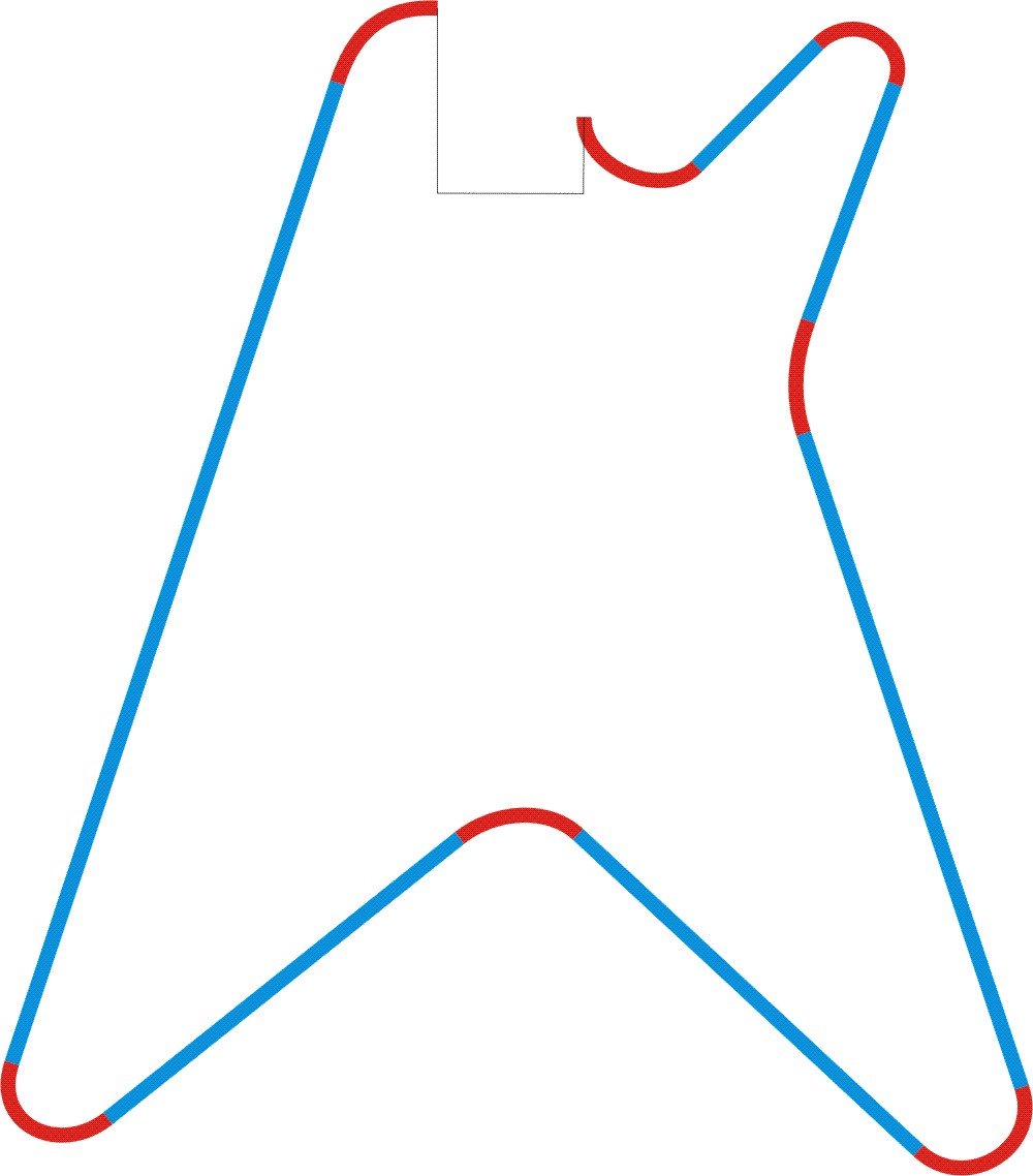

    In this idea I've tried to make all the angles the same, so the upper rear and lower front horns are symmetrical about the red line, the two lower horns are mirror images, and the angles of the front horn are the same as those of the rear horns. Needs more work. Anyway, just throwing a couple of ideas in the pool, hopefully not spanners in the works...
    Maybe that front horn should be blunter, same radius as the others...

    I really like those ideas, thank you. I am a little further along with the TV, it’s not that dissimilar to your drawing but still has the rounded telecaster influence. I may have to make another now! I would be interested in how you would mirror the design for the headstock

    I think that JimC may be onto something. The shape he sketched looks the best to me so far.

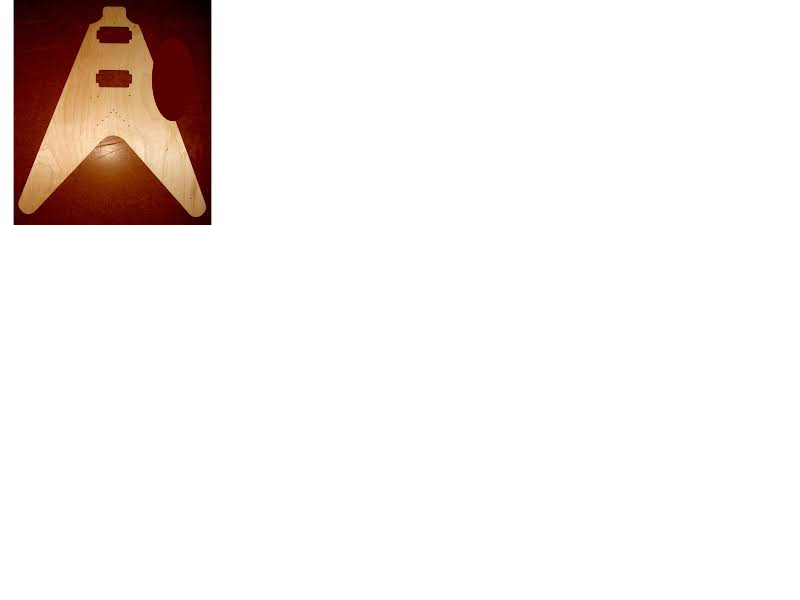

    I had my own idea, which was to abandon the horn and take a bite out of the lower edge to rest on your knee.
    After looking at my idea, I am now completely convinced that JimC's idea is better ;-)

    If so, it may be collective. I was sort of thinking of it as the shark attack Flying V.
