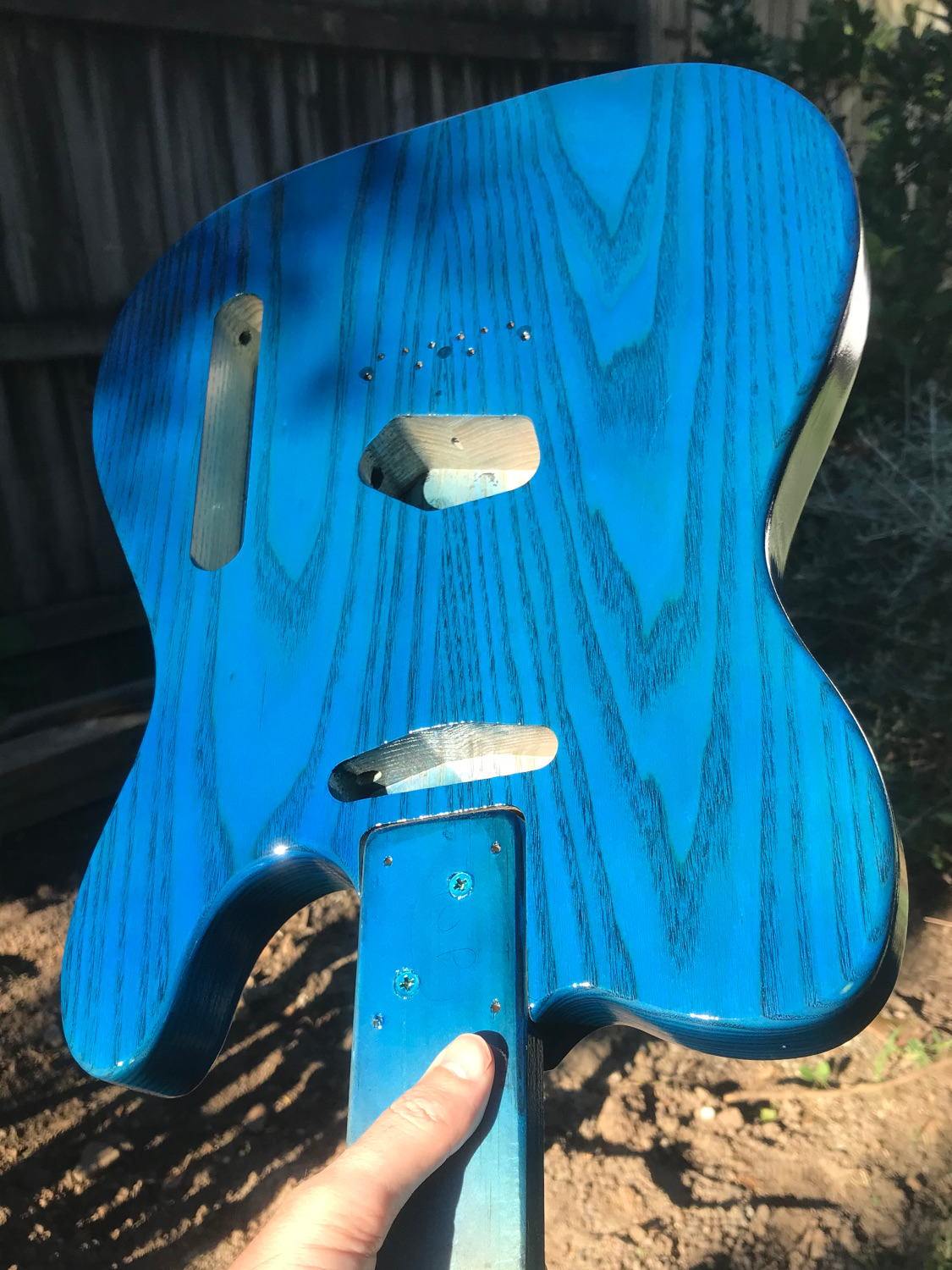

    I've now spayed a few coats of clear, and I think it's looking good. I think I'm going to stop there and leave it alone for a couple of weeks. I've still got some clear left, but I think I'll keep that in case I need to patch anything up. The surface isn't great - I'm working outside, so it's got some dust in it, but I'm hoping that'll all clear up when I sand it.

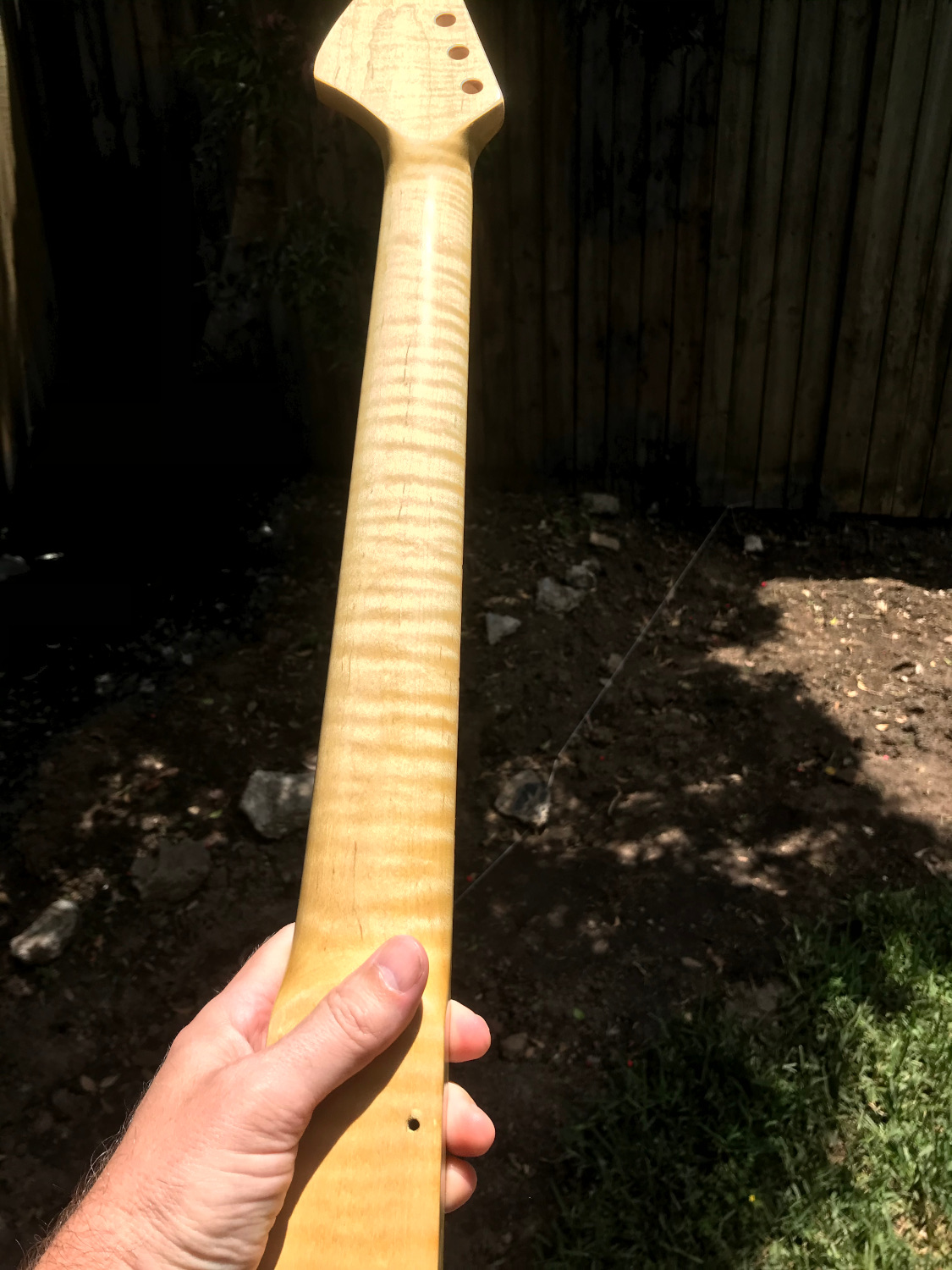

    The neck is also progressing will, with four coats of Tru Oil on it now. The tiger stripe in this maple is really showing up nicely.

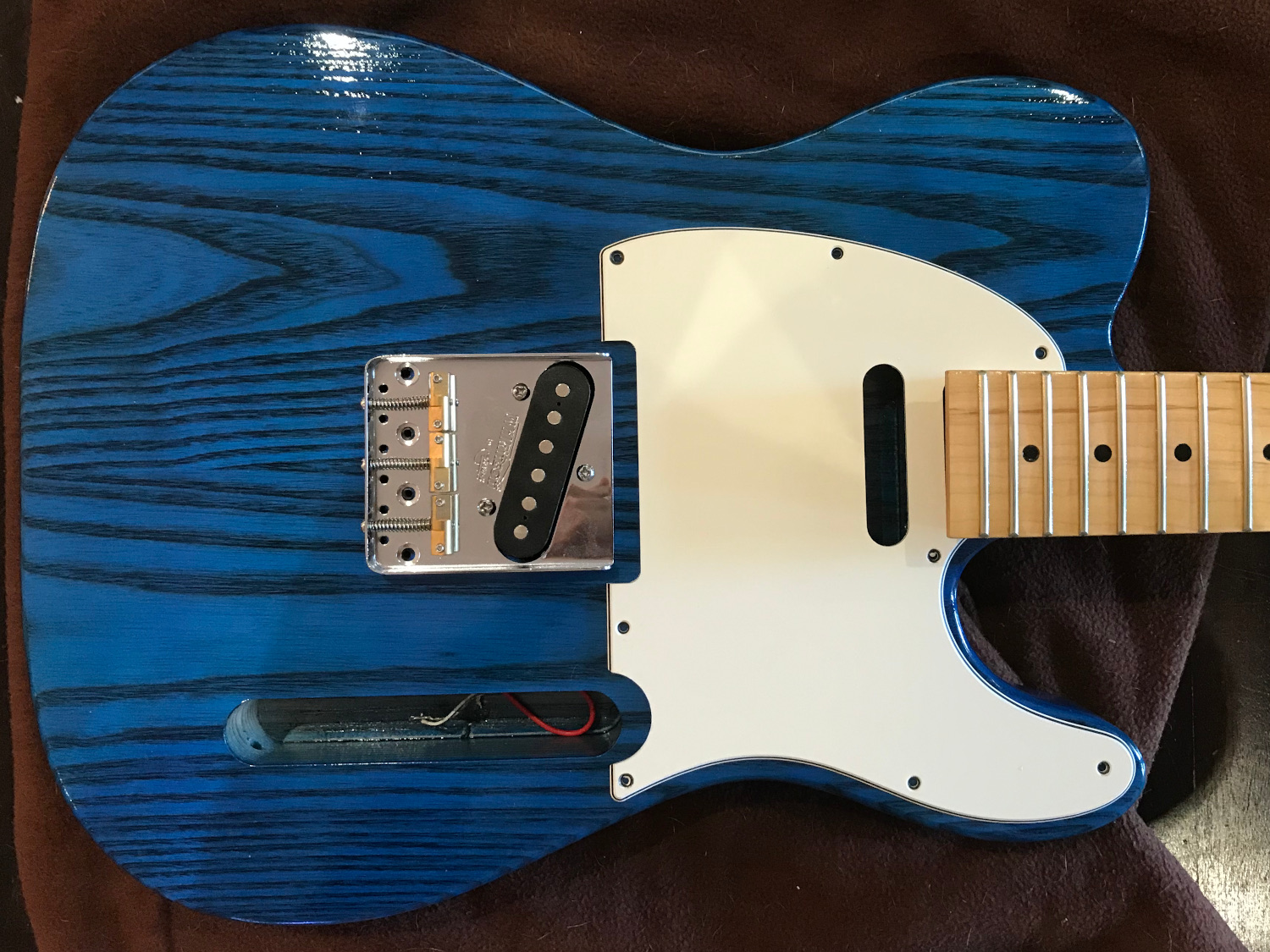

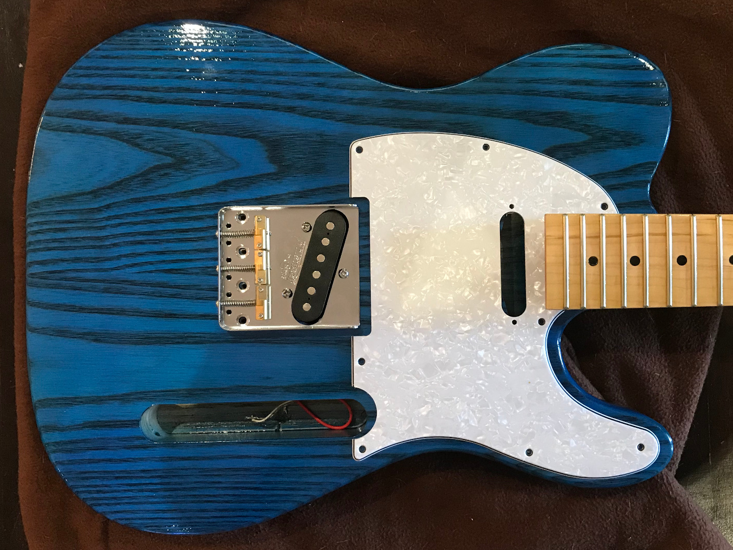

    I have both my pick guards now, and I think I prefer the pearloid - good call McCreed.

    How long do you think I should leave the nitro finish before final sand and polish? I've read anything from 2 weeks to a month. I had reserved some of my clear, but now I'm thinking I might be better off giving the body a light wet sand with 1200 grit to address any dust in it, and then applying the rest of the can. It won't help me with a sand through while it's still in the can.
  7. #46
    Nice! Pearloid for me every time (well, nearly) .
    A while a go I changed a couple of my pickguards because I noticed pearloid was "trending heavily" amongst my guitars!
    As for doing more clear, I wouldn't wet sand, especially as fine as 1200.
    If you've got enough clear to do 1 or 2 full coats, you could partially level what 's on there now before spaying the last of the clear.
    It looks like you have some orange peel on there (the reflection on the lower bout in the photo). You could block sand that (dry) with 600 just to get some of that orange peel out before the next coats. Don't try to get it perfectly flat, just go for about 70% or so if you have concerns about sand-through.
    This will do two things: give you a flatter surface for the next coat to lay on, and the abrading will help with the chemical bonding*.
    You may be able to go as coarse as 400 on the orange peel, but I'd try the 600 and see how it feels.
    *I know nitro will "melt into itself" (reactivate) but even with nitro, if it has set for a while it's a good idea to rough it up, IMO.
