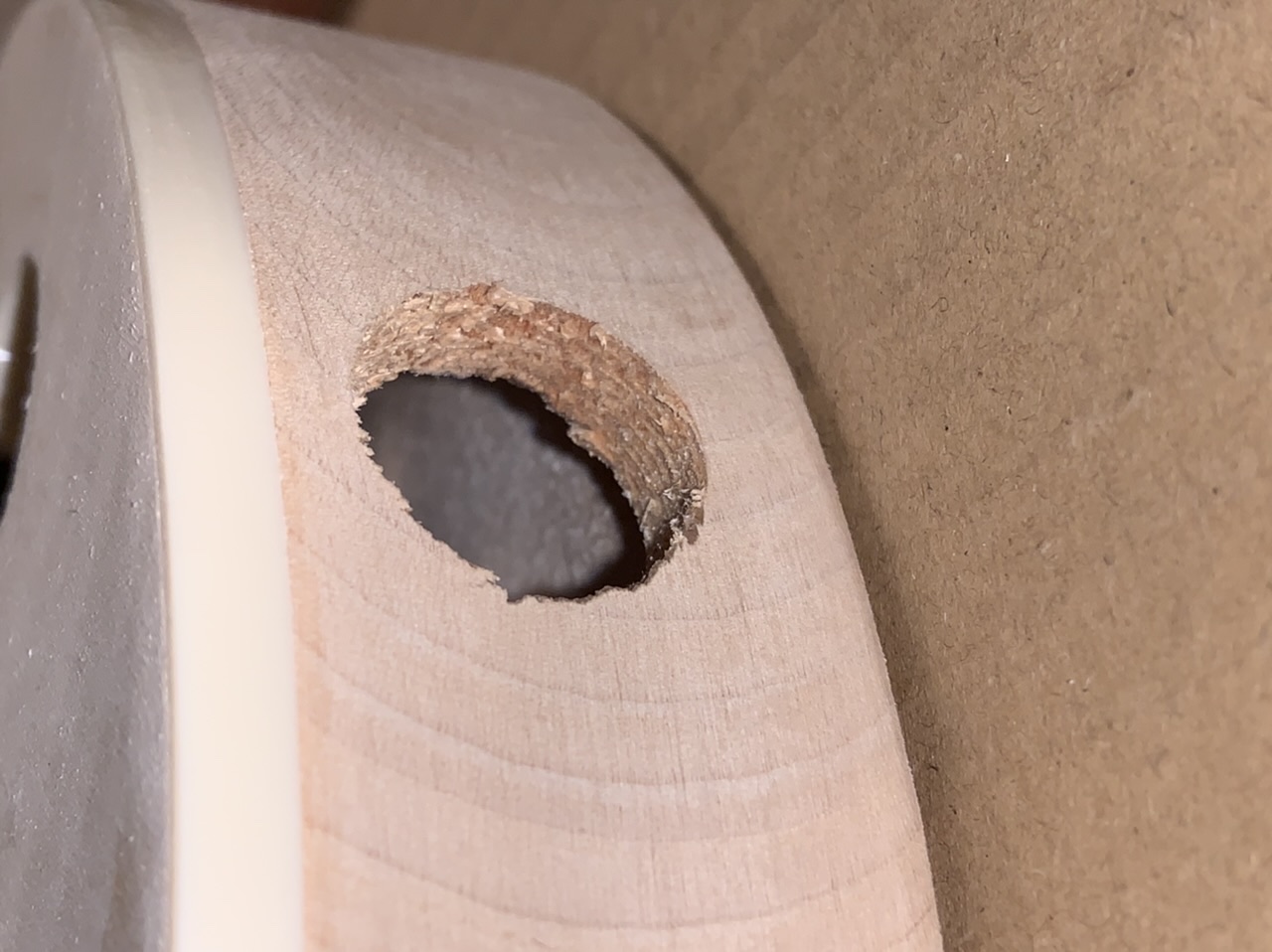

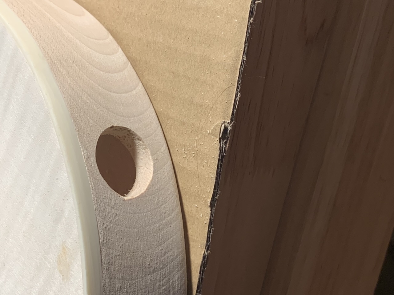

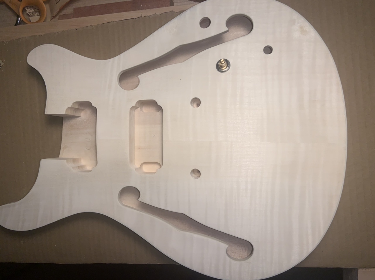

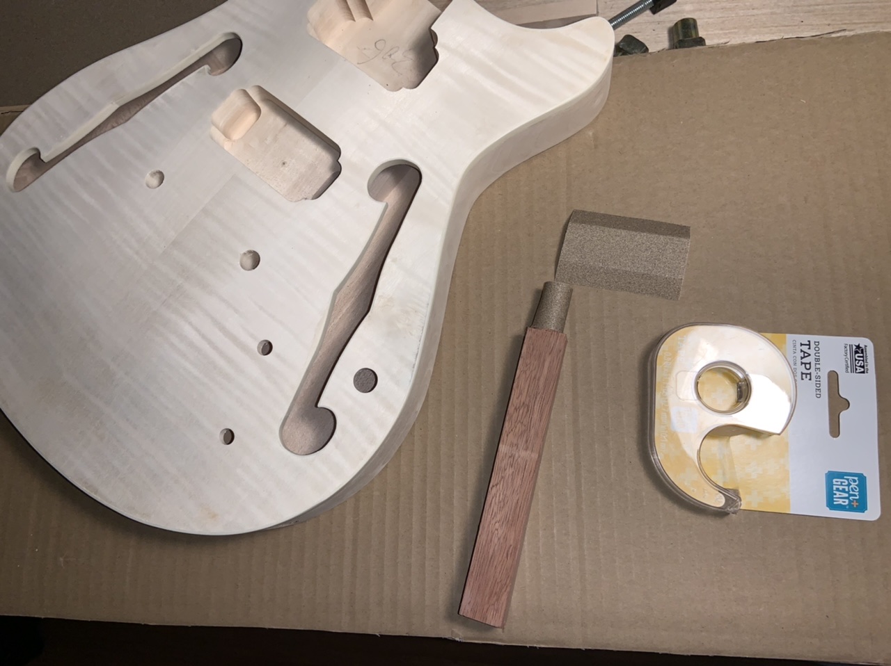

    I think this was the first thing I did. It was pretty chewed up and was hard to sand evenly (with the tool I was using at least.) But it’s miles better than it was and it made me feel better about the guitar. I then proceeded to make more sanding dowels and clean up all the drill holes, the corners of the pickup cavities, etc.
    These are inexpensive kits which usually means (for manufacturing in general) the Factory tooling (bits) is not changed frequently, and also less concern about “Feed and Speed” when machining which leaves a lot of tear out and rough holes.

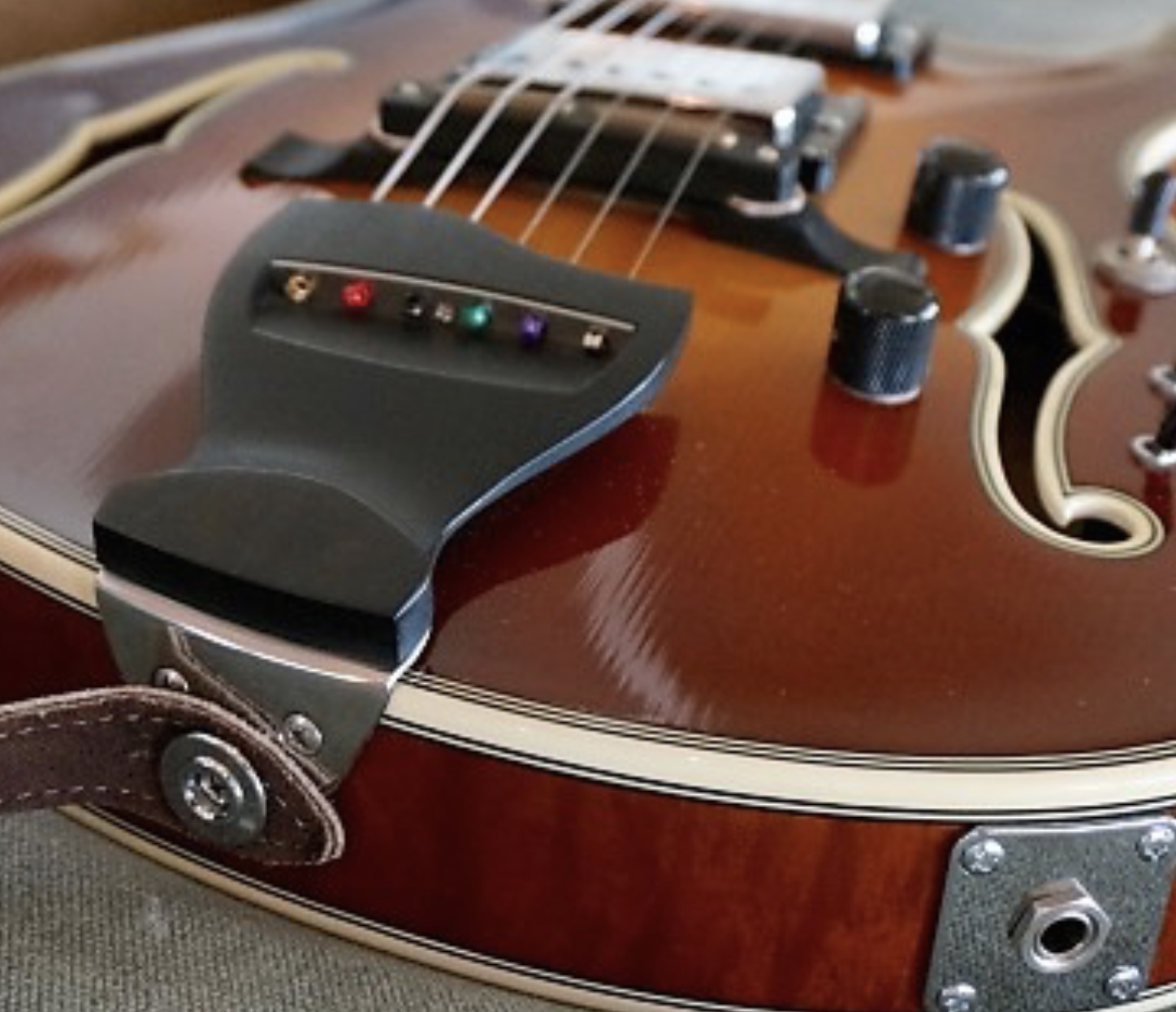

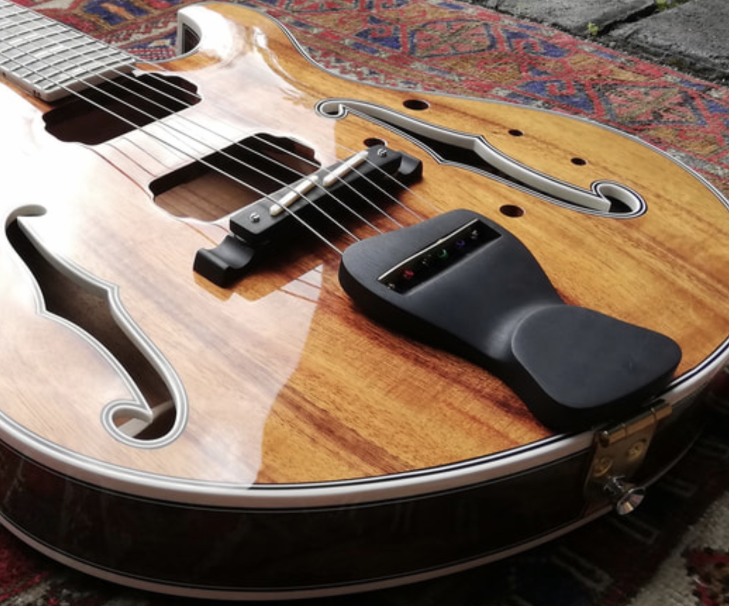

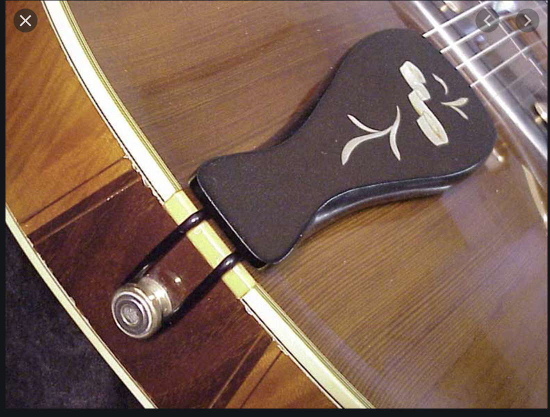

    In order to use the ebony tailpiece, I need to figure out a bracket that will properly support it, and not flex or bend from string tension. Any movement in the bracket means tuning issues. Most guitars with this style tailpiece use a system that lets the tailpiece adjust to string tension: either secured with a wire, or mounted on a hinge. My favorite guitar apparently uses a solid metal bracket. I’ve been looking for good pics for years and never found one, finally I did. I also noticed that the ‘copies’ of that guitar are now switching to solid brackets.
    If the bracket is too thin, or if the angle is wrong, it will bend under string tension. It looks like the Languedoc guitar (the $15000 guitar I love) uses a 90 degree, and I guess it’s just thick enough steel that it doesn’t move.
    So back to the neck angle: I need to have a secure tailpiece bracket, need to know bridge height, and need to make sure there’s enough string break angle over the bridge to the tailpiece. As it is right now, I’d need to add a bunch more angle to the neck to make the bridge pieces I have work. So what I can do to minimize that is reduce the height of the rosewood bridge base.
    A good method to do this is lay sandpaper on the guitar, and rub the bridge until it takes the shape of the guitar top. But, my guitar is unfinished and has a very thin veneer. I’m afraid if I do that, I’ll rub in the grain a little (burnish?) which would affect how it absorbs stain. So what I’m thinking is to just uniformly remove material from the bridge to get approximate height, then build and finish the guitar, then come back and finish the bridge.
    Here are some examples of guitar tailpieces. You’ll see the wire mount, the hinge mount, and finally the bracket mount.

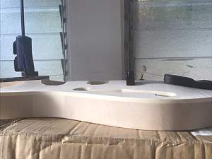

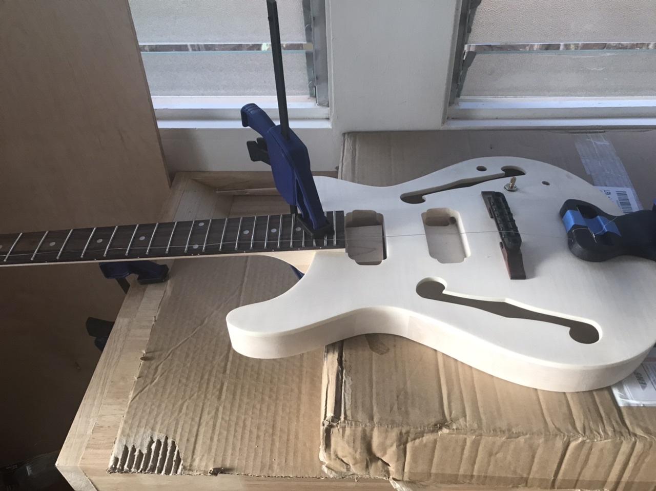

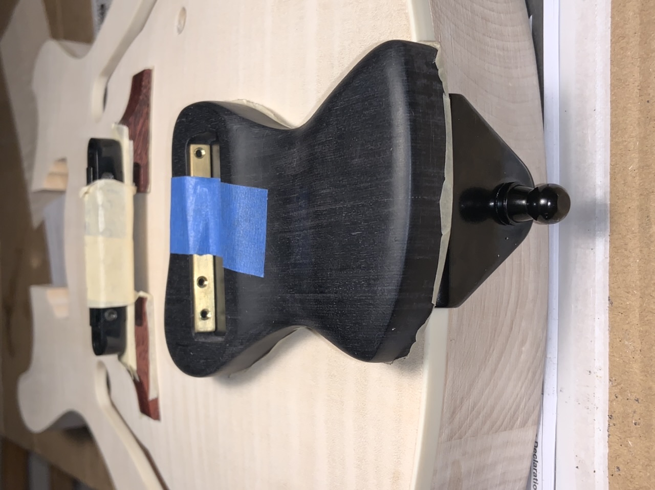

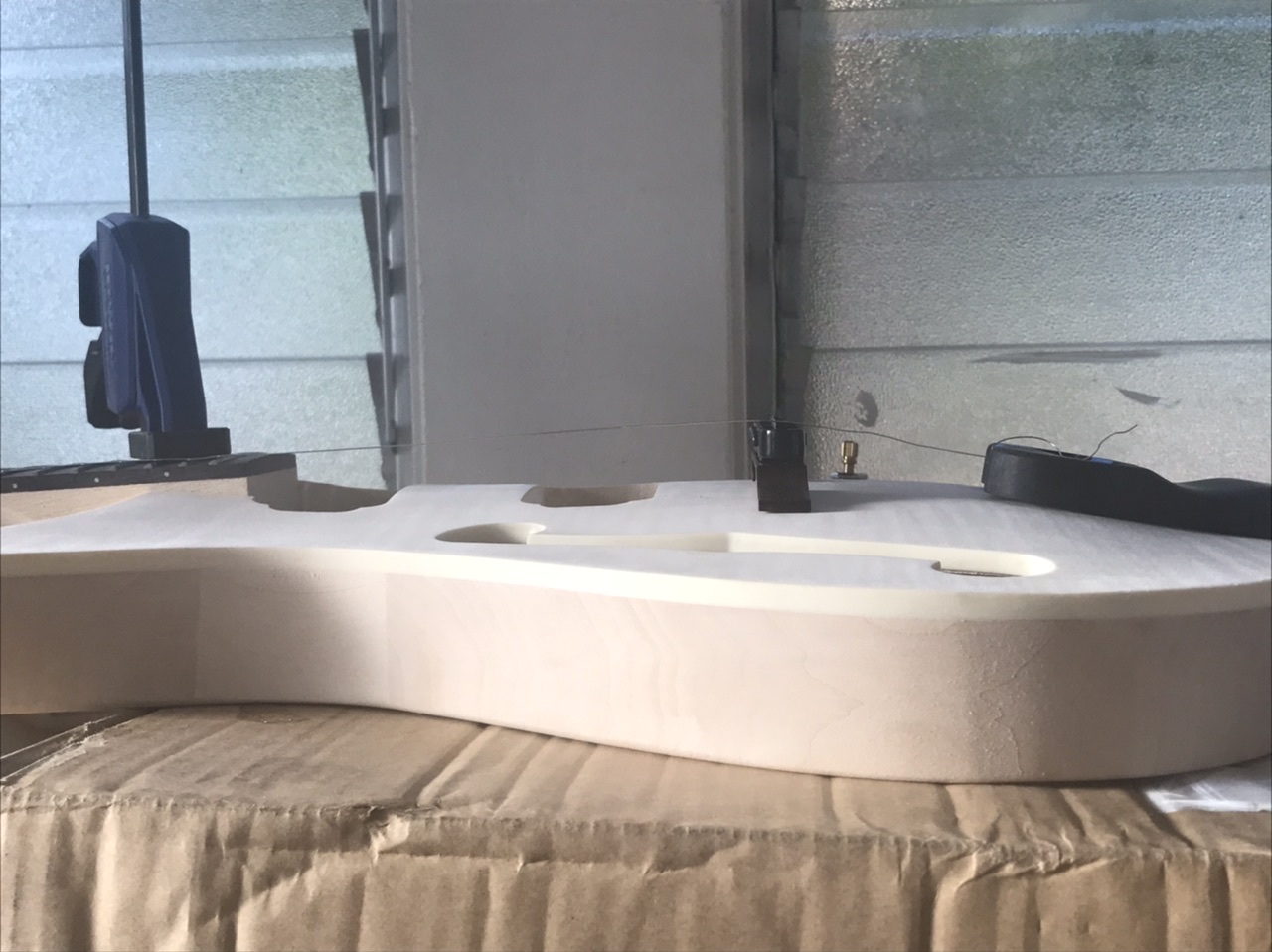

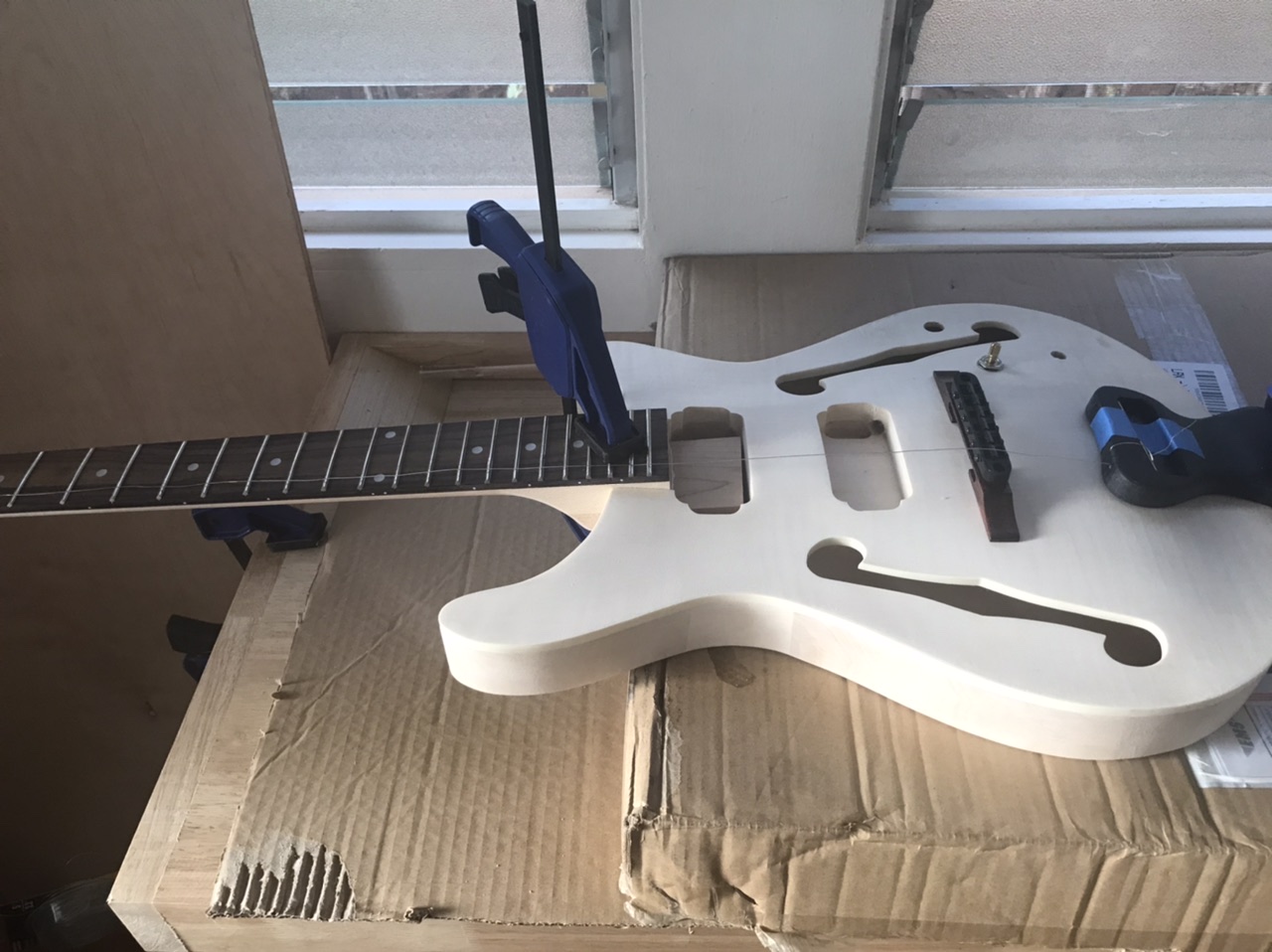

    After writing all that and posting pics, I thought I’d take a pic of my guitar. It turns out the break angle looks pretty good, and lowering the bridge might actually make it too shallow of an angle. That said, this is the lower of 2 bridges I have and it’s not on studs yet. But honestly I think it looks pretty good.
    What do you think?
ID:	35936Click image for larger version.
    *Pictures may be rotated due to my proximity to the equator.
    It certainly looks good enough for now. Really no point taking the bridge height down at the moment (if at all). It can easily wait until final setup.

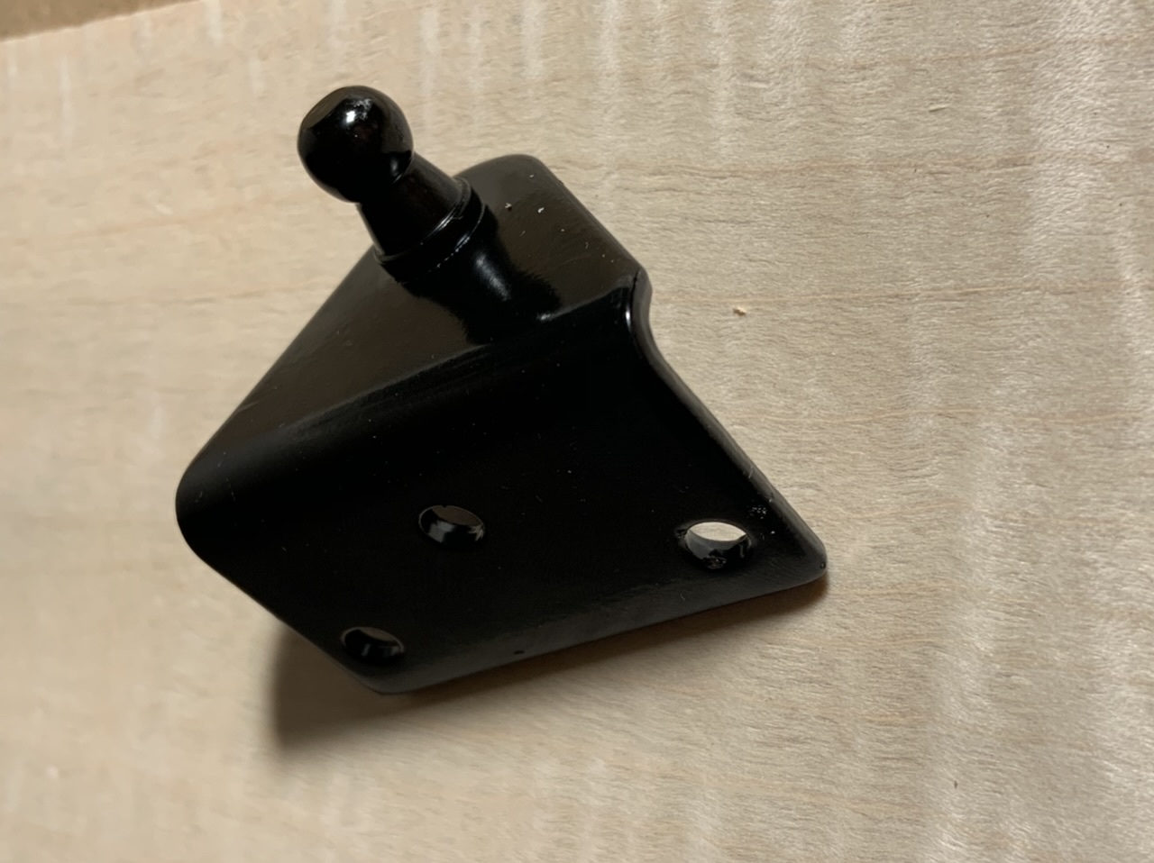

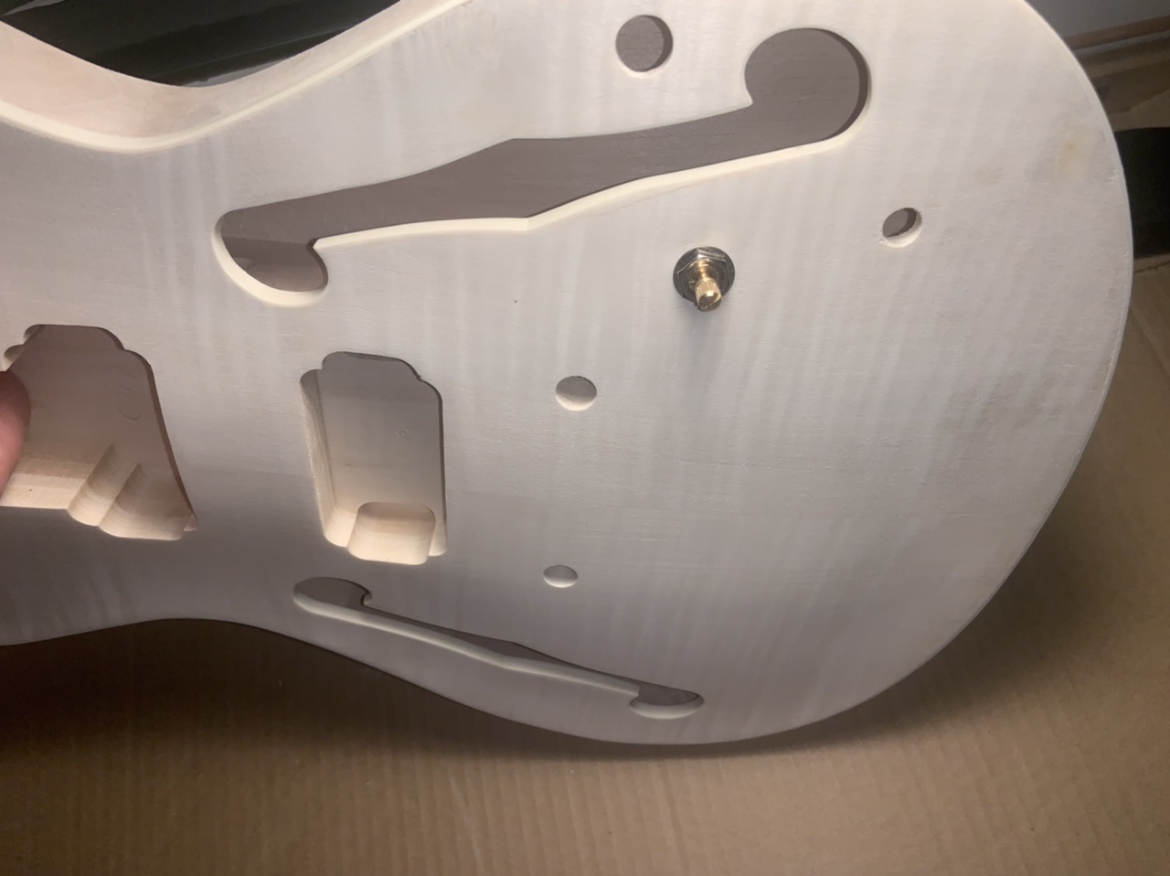

    I’m still torn between a standard combination (wraparound) bridge and the tailpiece. I ordered a wraparound and was thinking this isn’t really the right guitar for a tailpiece.
    Then I found this, which only needs minor modification to work:
ID:	36029 Click image for larger version.
    It’s a bracket for mounting hydraulic “springs” - I think this one is for the escape hatch on a boat or something; it’s from the marine supply store. It’s literally the exact size, shape, and one of 2 colors I wanted. I’ll drill out the ball and put the strap button there, and drill a couple holes for screws.

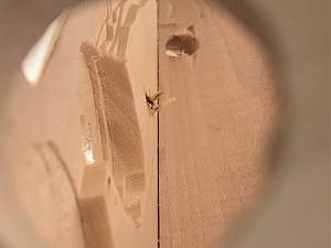

    The top of the guitar is very thick: the topside is carved but the bottom side is basically flat. There is some material removed from the underside around the control routing, otherwise the top is pretty thick. Here’s a pic looking through the jack hole at the underside of the top (I swear these pics are right side up on my phone!)
    This means the guitar probably won’t have much of the resonance one would associate with a nice hollow body. The arch top style bridge with the tailpiece is all about transferring vibration to the top for resonance. So in this case it would be purely aesthetic.
