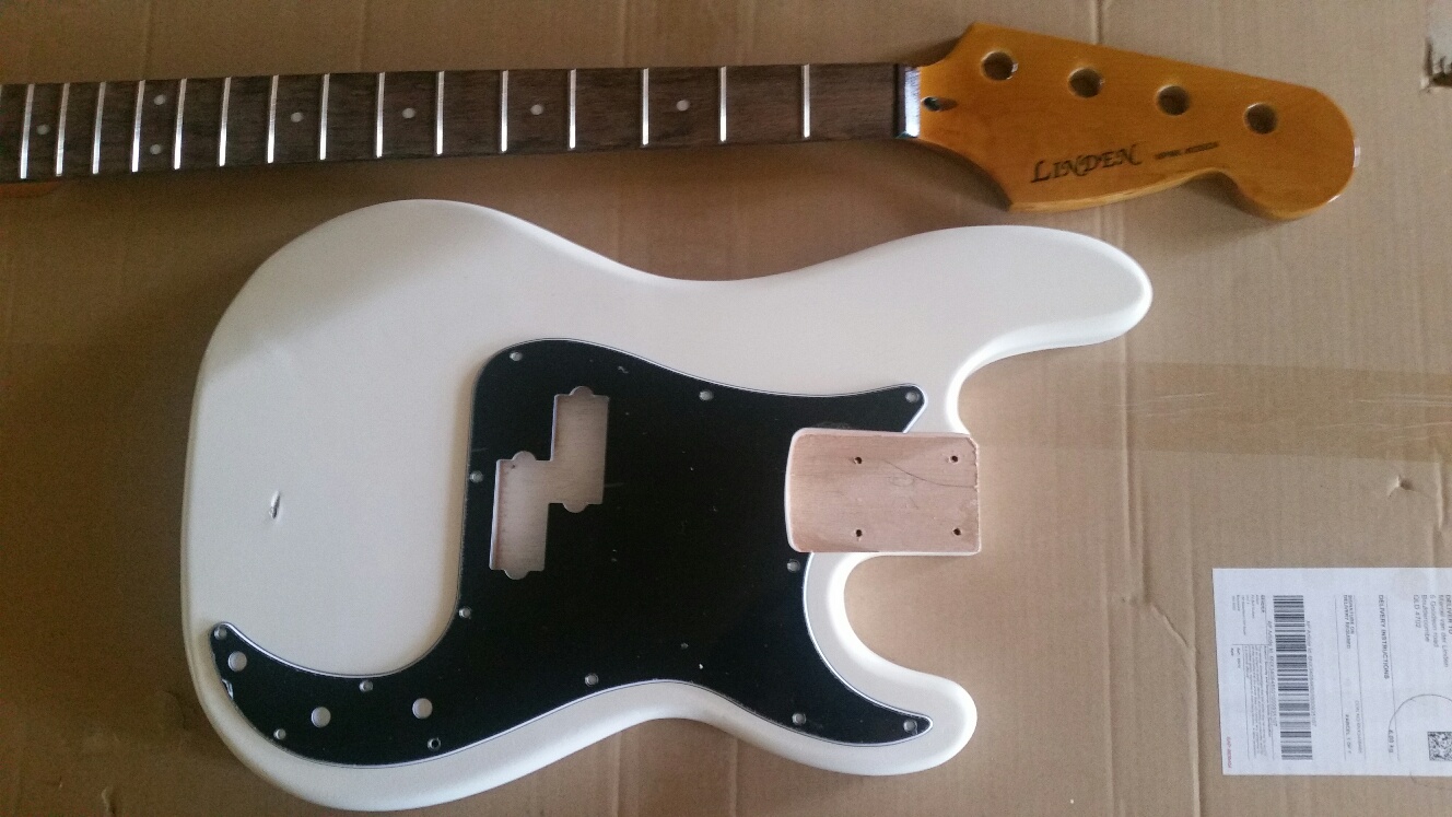

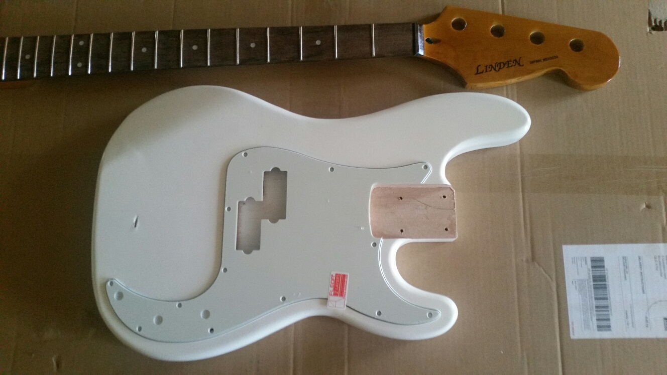

    Have got all the vintage white coats down, and 3 decent coats of gloss clear over them...
    Just before the last clear coat I did do a light sanding with 400 to knock down any "hairs" and such.
    Gloss came up quite nice so am very tempted to not sand from 1500 to 4000 and just buff... Issue is there is quite a lot of wood texture still visible on the front and back surfaces and any attempt to remove that will most likely result in burn through. I have a down feather buff wheel and a light going over with that might just get me there....
    Anyways, I have some alternative pick guards to choose from.... Not sue if to stay with the original kit white or go black...

    Certainly is Simon...
    I'm quite taken by the kit guard with the true white on the vintage white, but the black just looks so bad ass...
    A trusted lady friend of mine says do the black guard.... decision in a few days

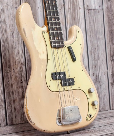

    I reckon it's the one on the low/left.
    That closely matches this one

    +1 from me on the black & white.
    Dec 2017
    New Mills, High Peak, UK
    99
    Another vote for black pickguard
