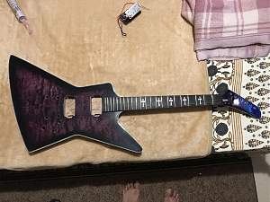

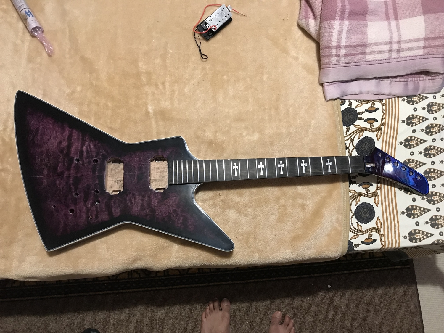

    Hi all,
    It was a long wait until the clear coat had cured, or at least sufficiently dried, but I finally felt it was time for wet sanding and began the polishing process, ending with Meguairs ultimate compound to achieve a lustrous shine. Now I’m about to finish the shielding of the cavities once my exams are finished, but here’s a little sneak peak at what might be the end result. The guitar looks kinda unglu in the photo, but trust me, it’s beautiful in person.

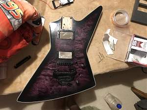

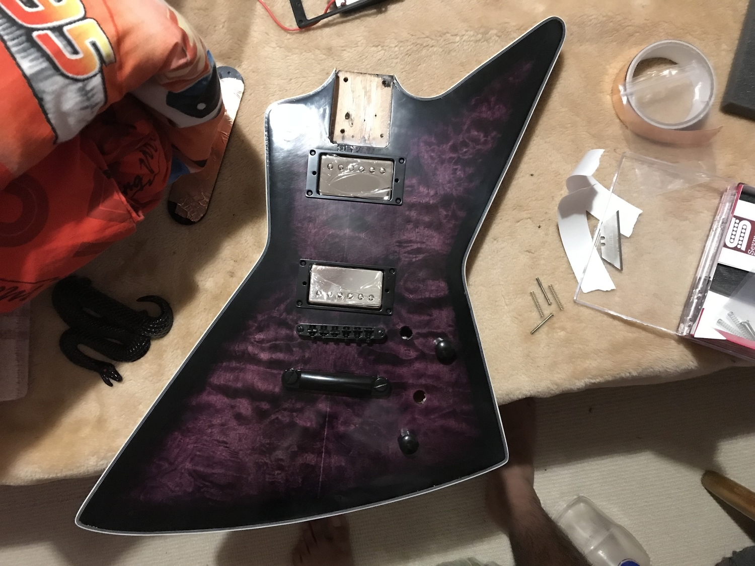

    Torn between what tailpiece to put on. Photos are pretty bad but what are your verdicts between the snake or the bar?

  8. #38
    Hah wow. I'd go the snake! You can always swap it later. Looks nuts. In a good way.
  9. #39
  10. #40
    Jan 2019
    Shanghai, China
    233
    A snake tail piece won't look right on most guitars but on this one it looks great!
