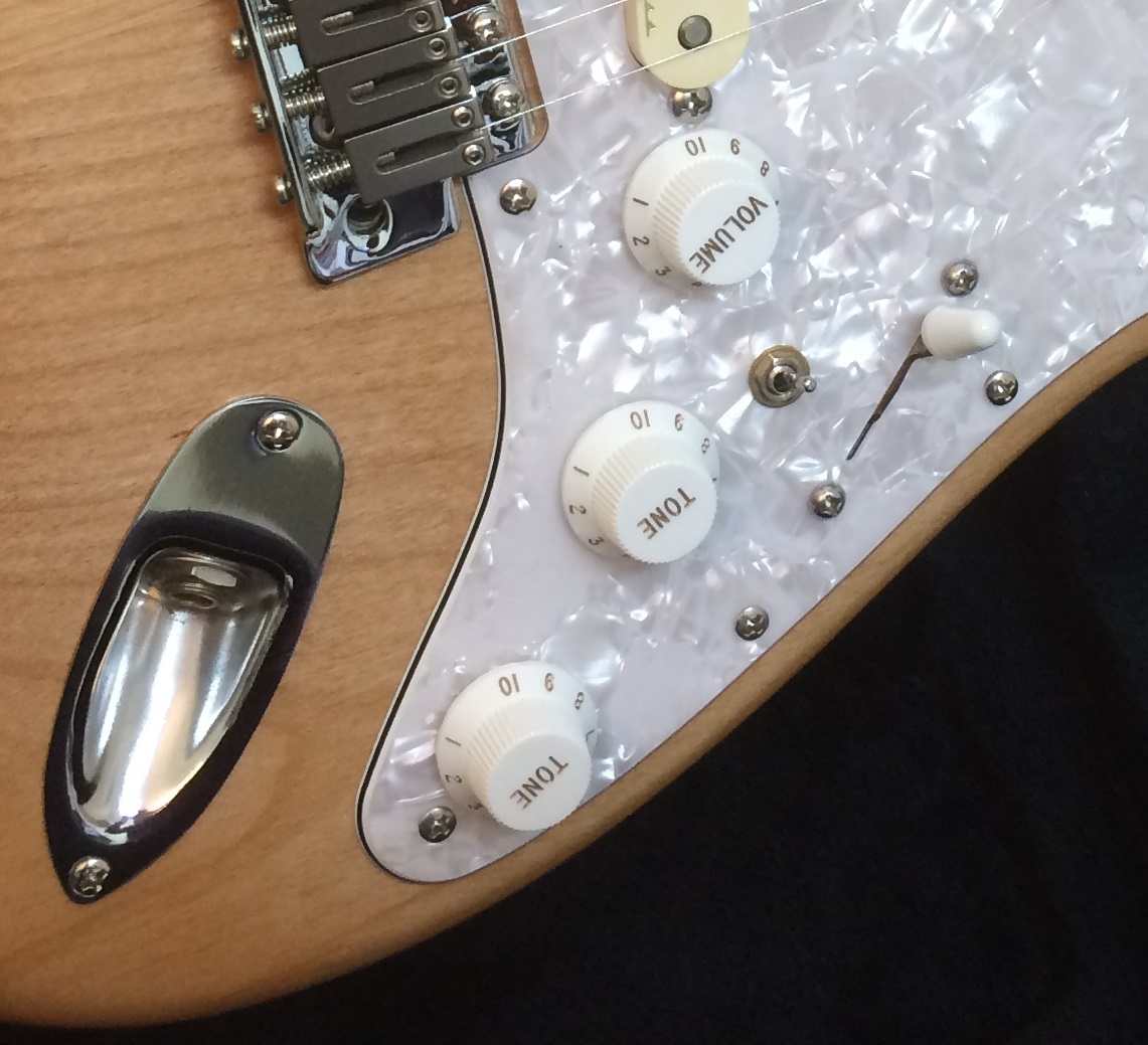

    Option 3 sounds the best. But sounds like I am a bit out of my depth. I would definitely need a diagram there I assume. I will probably just get a 5 way switch and go back to basics
  2. #32
  3. #33
    Yep, that’s the general style of layout I was thinking of. The variant in the above diagram allows you to have the middle pickup on its own, but to mute the guitar you need to roll off both volumes.
    The other variation feeds the middle pup’s volume to the ‘in’ of the master volume; you lose the option of having just the middle pickup by itself, but you can mute the guitar just rolling off the master volume.
    It all depends of how you would normally use the controls, your style of playing and which pickup combos you actually use. A diagram for the latter variant is easy enough to draw up if needed.
  4. #34
    If you decide to go with a 5-way, and still want further options, look for a "7 Sound Strat" diagram. You can get all the standard strat positions plus N+B and N+M+B by using a push-pull pot or a mini toggle. (I prefer the mini toggle).
    Also, if you really want the the pickup combinations you originally posted, and can live with the 1 volume/1 tone, you can wire as I said previously and just have an un-wired pot to fill the hole. (there are other clever ways to plug/disguise/cover pot pickguard holes too)

    Thanks for everyone’s help! I reckon I’ll go with the 3 way switch and go off that diagram. Thanks so much!
