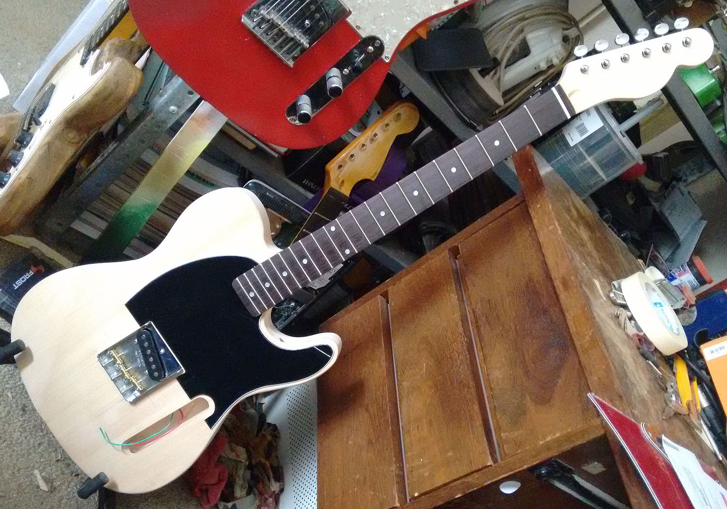

  3. #33
    Member I’ll give it a go's Avatar
    Apr 2019
    Perth, south of the river.
    263
    I hope that's it, otherwise I can't see what's wrong.
    Here's the day's progress. Still have to cut the pickup hole, but the main concern for now is the bridge/control section.
    Attachment 30530
    No sign of the neck plate, or jack plate and 3 way switch yet, so plenty of time for that.
    cheers, Mark
    I can see this pic on my mobile, looks really good so far. Looking forward to see how the rest goes together.

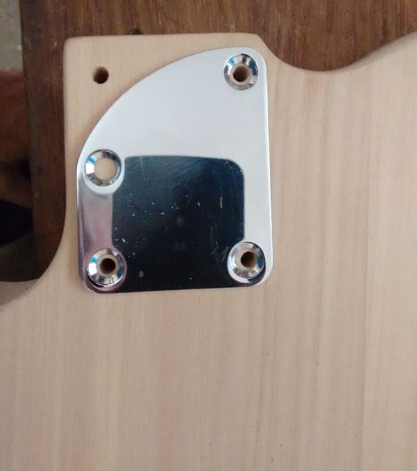

  7. #37
    Neck plate mod
    Bonus, the original 3 holes line up.

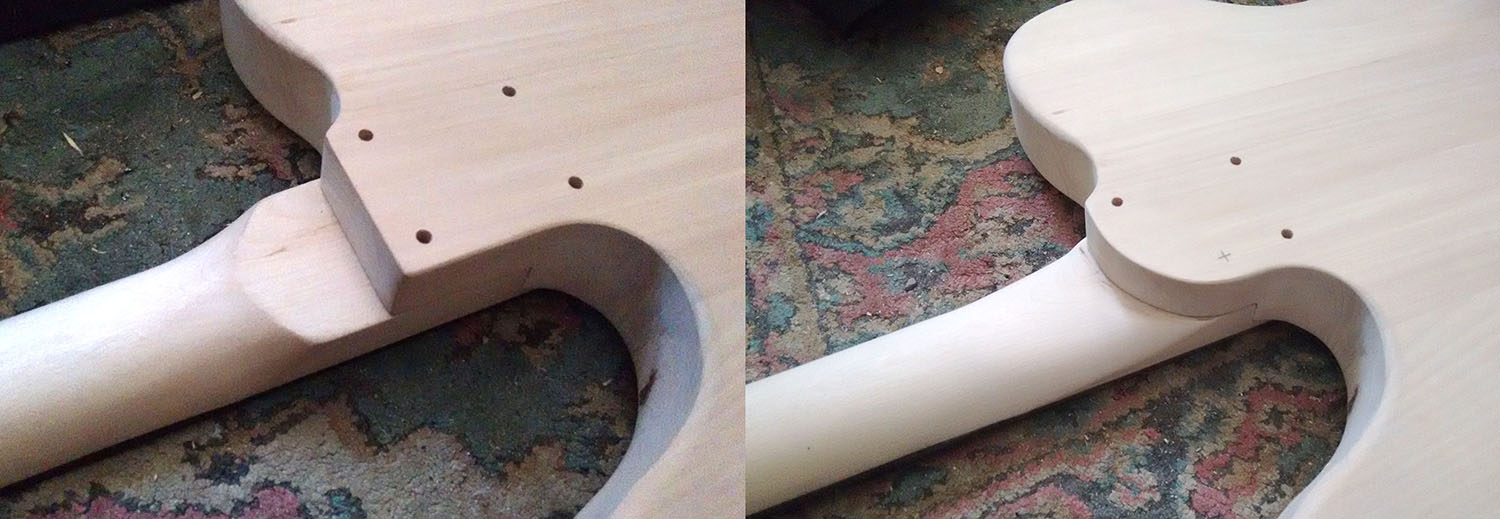

    Now I'm adopting an idea that I saw Grant (neverwas) accomplish.
    Before and After.
    Gee, it really improves access to the dusty end.
    cheers, Mark.
  8. #38
    Apr 2019
    263
    That’s looks awesome, and this is all because the back plate doesn’t always line up straight with the back of the body? That’s what I’ve read so far anyway.
  9. #39
    Quote Originally Posted by I’ll give it a go View Post
    No, the asymetrical neck plate is a common modification.
    Often it seems the pre-drilled holes don't match with the supplied neck plate.
    It just means you have to dowel them up and drill 'correct' ones.
    You may just get lucky.

  10. #40
    You can also just slightly enlarge the pre drilled holes. The screws usually bind up in them a bit anyway. The screws don't need to bite into the body to make the join secure, its all about clamping force. If you enlarge the holes slightly then progressively tighten the screws in an 'X' pattern it will normally square up.
