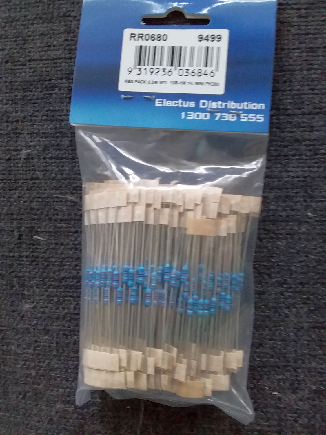

    There's nothing stopping you from putting orange drops in your Wah if that's what you want to do, yeah you can get those resistors from Jaycar, they sell packs of 300 1% metal film resistors in various values, I bought a pack so that I've got them if/when I need them, no worries at all, only too happy to help out whenever I can.
    Bag of 300 1% metal film resistors:
