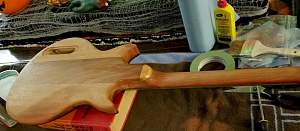

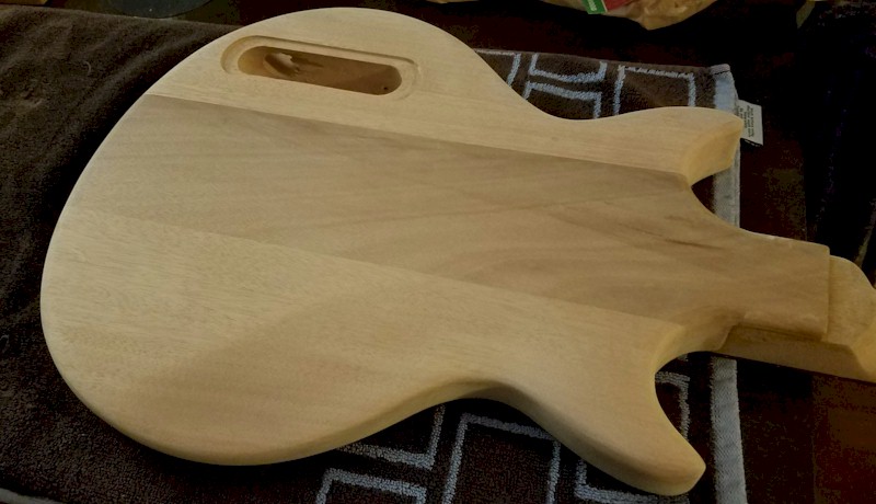

    Did the tummy cut...last week when I was doing the forearm contour, I just forgot to do this part and just now got back to it. It's fairly deep in the body, but I decided to blend it in to go with the whole round or soft aspect of the ergo features I'm going for, so it's a bit hard to see in the pic, but, I think the final result will be... "elegant" I guess is the word.

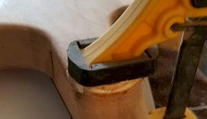

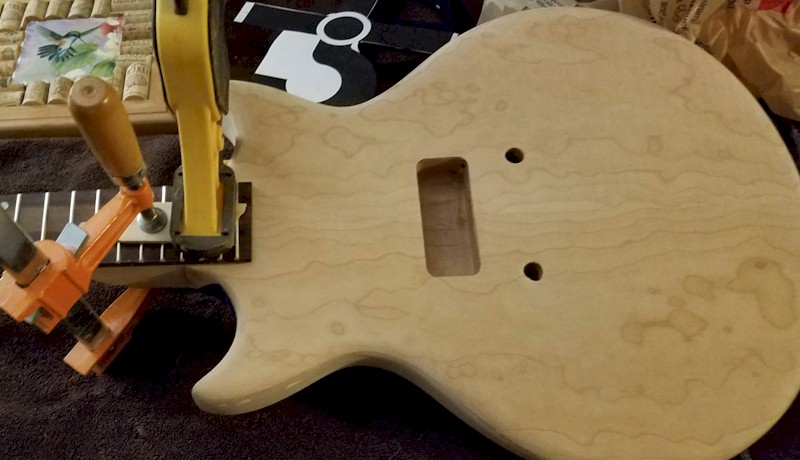

    ...and I glued/set the neck:
    Today I'm going to glue some wood to the heel so I can get the smooth transition I want and eliminate the sharp/square end where the pocket starts, sorta emulating a neck-through guitar visually. Will take lots of sanding, but I think it will look and feel way better.

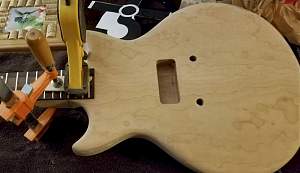

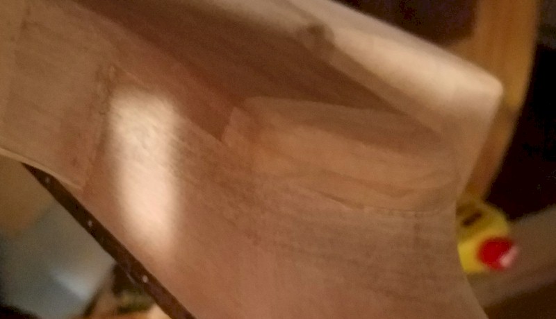

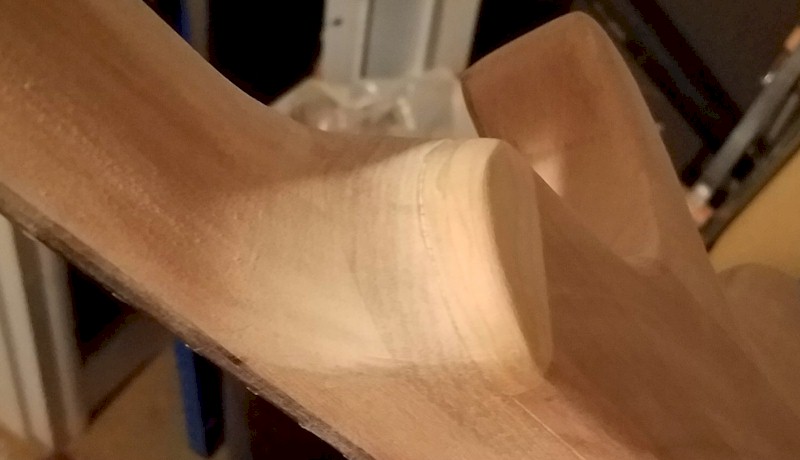

    Added Wood...
    ...and my wife responds, "If only it was that easy."

    Time to sand...

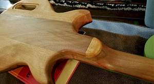

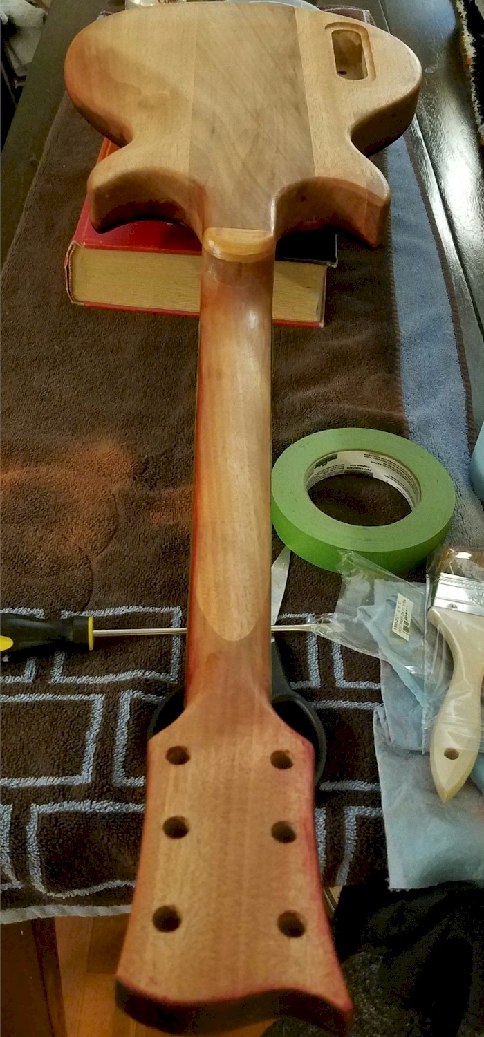

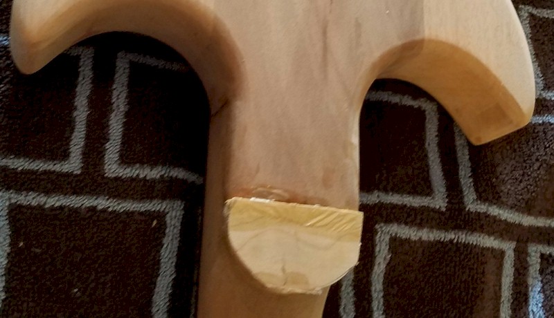

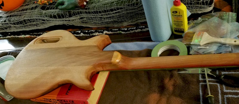

    Well, that wasn't so hard...
    Shaping the heel.
    Cut three pieces of the 1/8" maple and sandwiched them to fill the void...
    Free-handed some of this with the grinder, then attacked it with 60 grit...I was actually really worried about this, but it turned out to be easier than I thought. Lots more sanding, but I'm pretty happy.

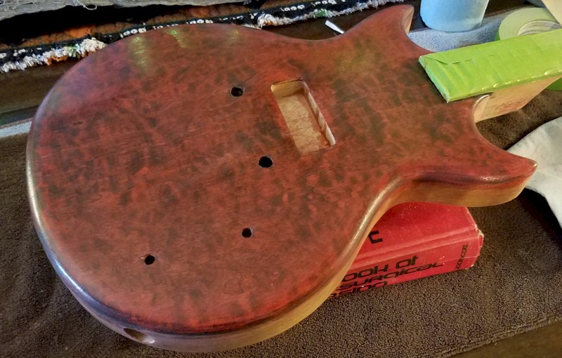

    I did the stain on the maple top...not sure what to think of it. Of course, all guitars should be red and black, so I stained black, sanded back, and went over with the red. I got a lower grade of veneer this time, and the result not quite what I was expecting. Leopard spots is the only way I can really describe it. The pic doesn't really capture it (in person, it's a bright, deep red) and there's not as much "shimmer" as I was hoping for. I actually did it twice. Completely sanded it back and re-applied, same result...so I'm going with it.
    My hope is that the lacquer will make it shimmer and pop.
    Put some sanding sealer on last night and lightly sanded with 400 and this seems to bear out when I hold it in the light. It'll still be cool, but I liked what I achieved with the bass better. That's what I get for changing grade.
    Put a couple coats of sanding sealer on the rest. It's too bad that I dorked up the body when the bearing flew off my router bit...I like the wood, and I might have gone trans red or black on the rest to show the grain. Oh well...solid black nitro it is...

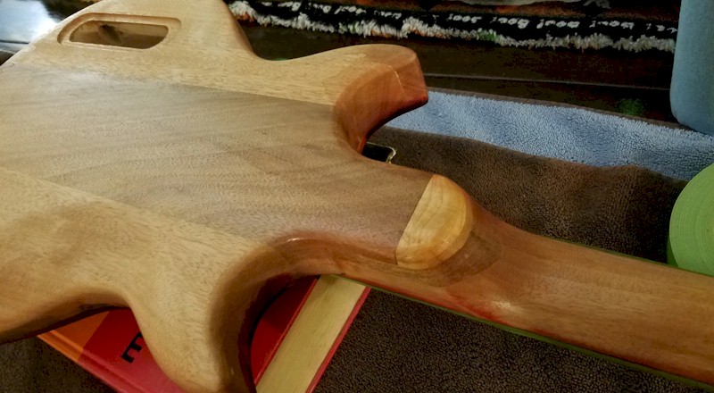

    Happy with the way the heel turned out. I rounded it out all the way around...no sharp corners on this guitar (well, except for the pointy thing I did with the head stock).
