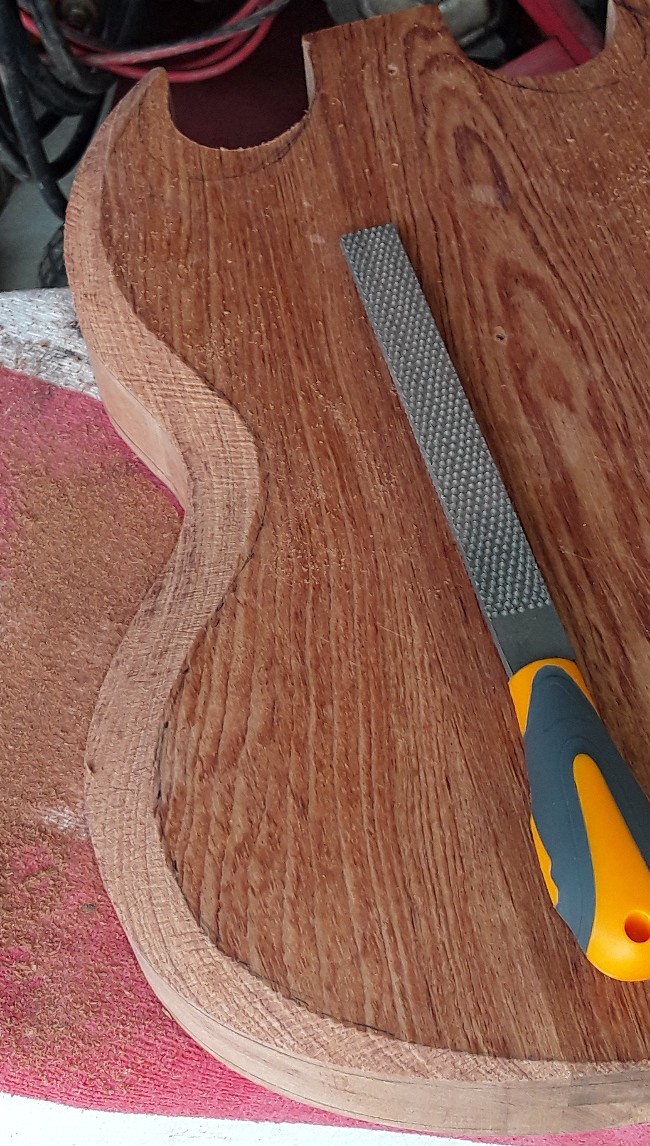

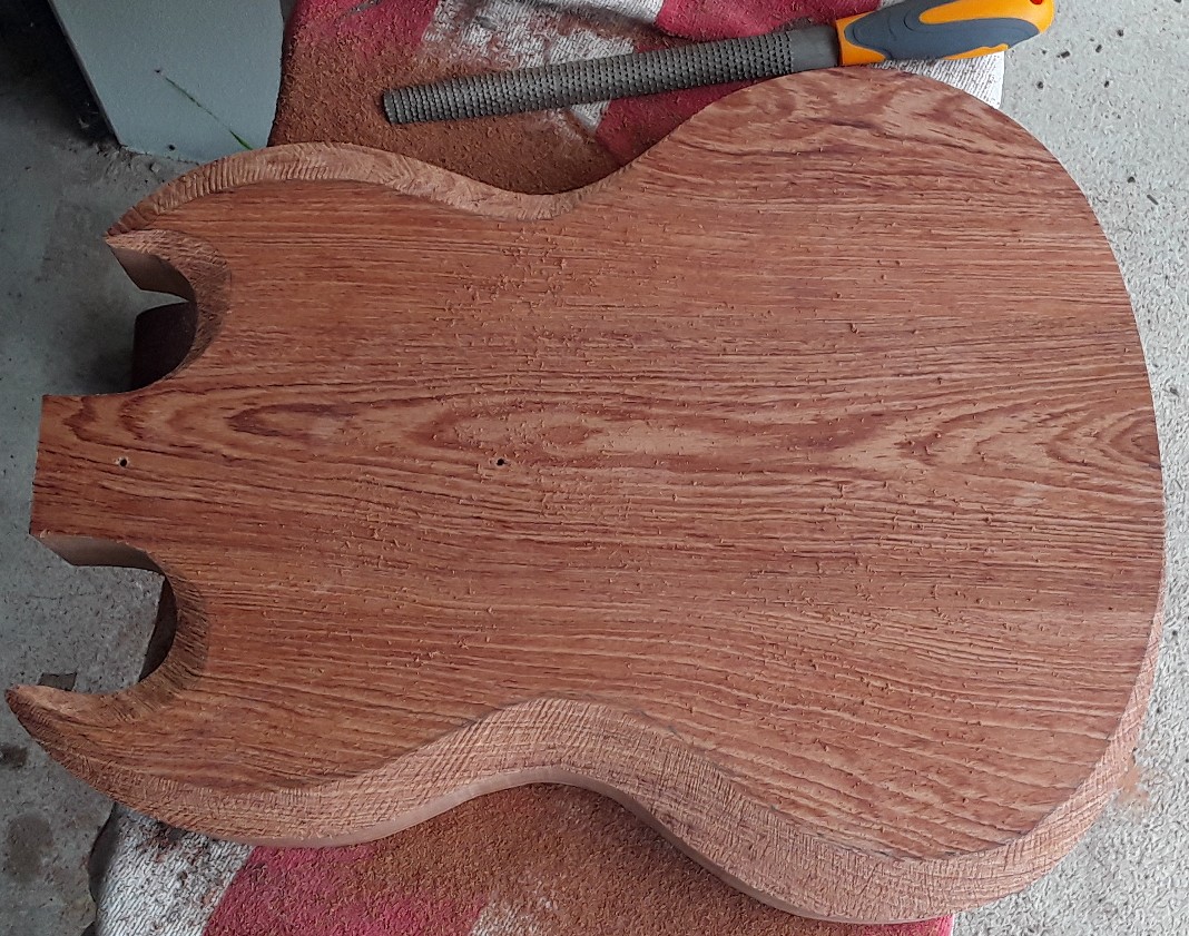

ID:	28670 Click image for larger version.
ID:	28671 a bit of shaping with the bastard file

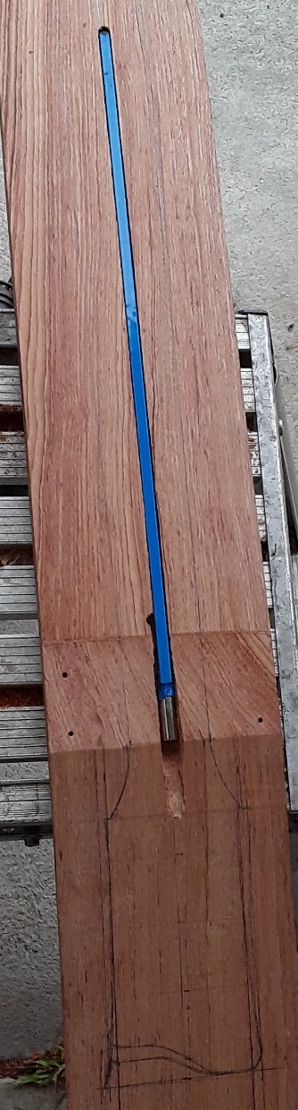

ID:	28688 trussrod grooved out

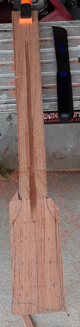

ID:	28689 neck roughly cut out

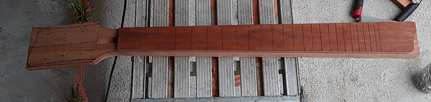

ID:	28692 fretboard shaped, question for anyone who has done this before, most videos show radiusing and fretting before gluing to the neck. Can i glue the fretboard on before and radiusing and fretting in place
  9. #39
    B&G definitely glue their fret board to the neck before radius-ing and fretting. They have some unreal videos on facebook which give some insight into how they do things. They have a jig which holds the neck straight against a linisher and then it's swung in an arc to get the right radius on it. I'll see if I can find a you tube link.
  10. #40
    Quote Originally Posted by Adam Barnes View Post
    HI Adam, On the three necks i have made so far and one reboard, I have slotted the board, and mounted it before adding a radius and fretting. It shouldn't create a great issue doing it that way, just have to be sure you are bang on centering it as you glue and clamp it.
