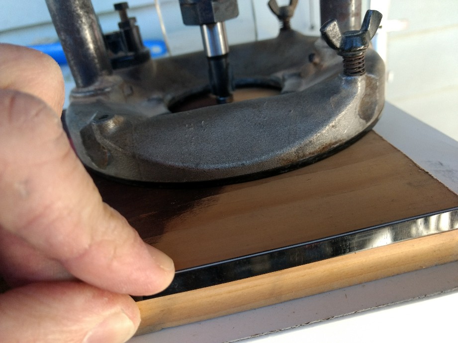

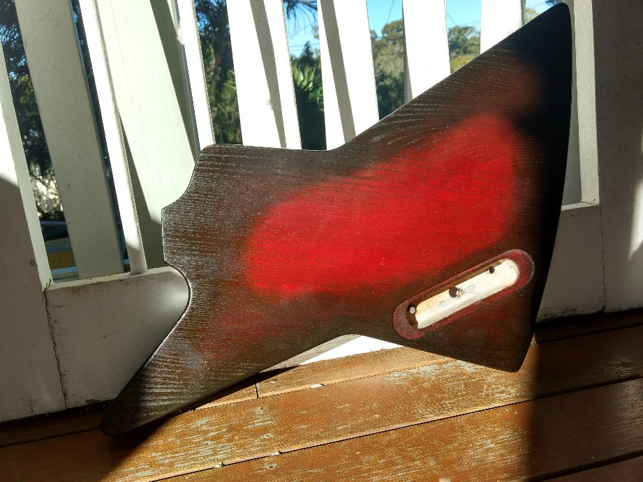

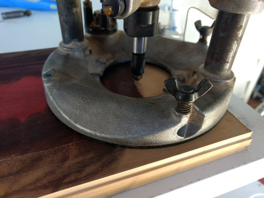

    Test routing a success! First pass and I think I have it spot on, binding site just proud of the top which was what I am after. I'll take a stiff drink and do it on the body later. Took a shot of the back of the body in sunlight after 2 coats of feast Watson wipe on poly in gloss, I am liking it.
