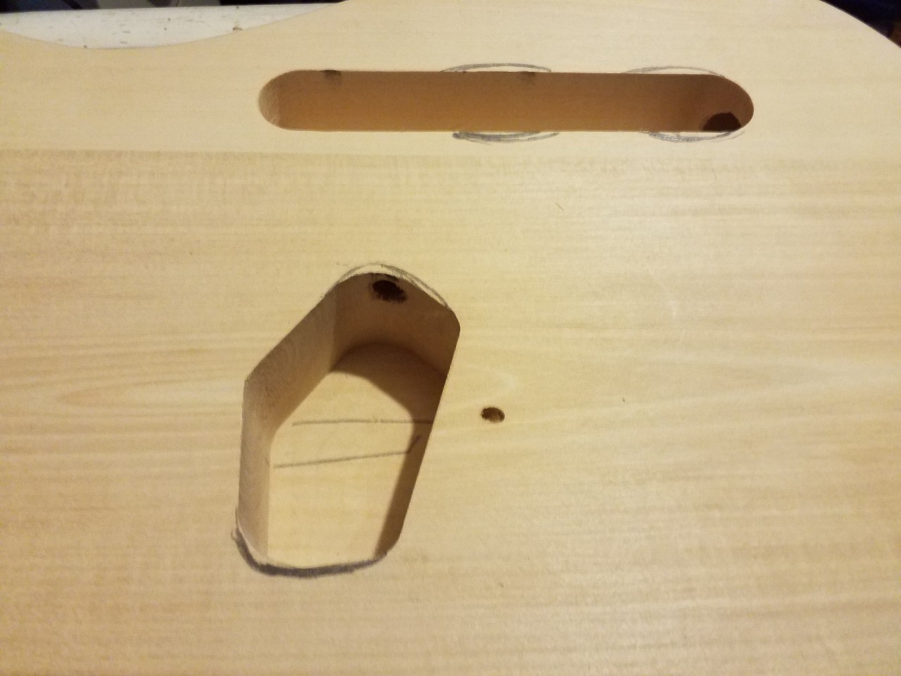

    So checked the sizes and both fittingsvare a tad large but easily fixed with the trusty dremmel.

  4. #34
    seems to be the norm, looks exactly the same as I had to do.

    Yea just checked your thread, seems anything aftermarket doesnt fit. Btw you sure had some dramas, glad they were sorted, nice looking beast

    Quote Originally Posted by nitroburner1000 View Post
    Yes I had to do this with my Tonerider pickups in the pbg body

    The only thing to consider is that the bridge plate covers the enlarged hole. The edges of the existing hole are close to the edge of the plate. I'd locate the bridge first and them make those mods. Same with the control platess it has to match up with the scratchplate which has to match up with the neck pocket
