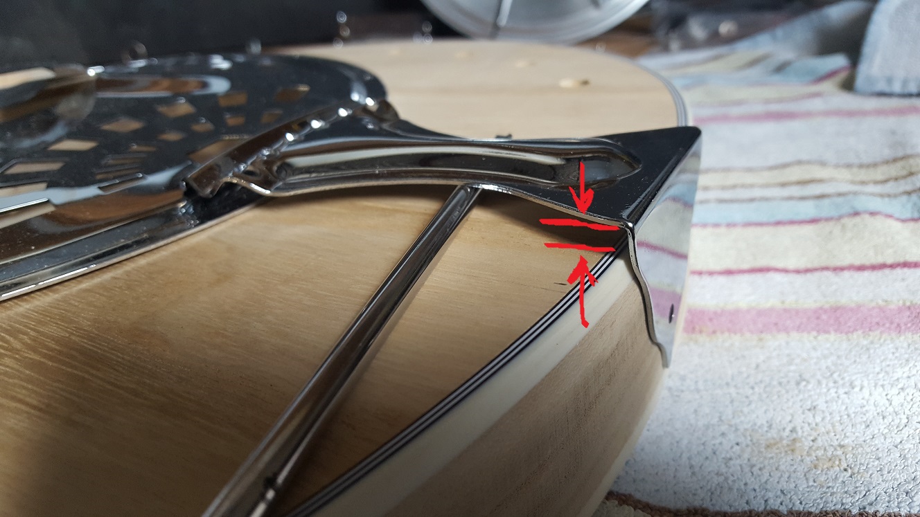

  6. #35
    Member cork sniffer's Avatar
    Dec 2015
    South Coast NSW
    348
    Not sure of tailpiece position.
    I'd think it should be mounted close to the body and bent upward to just clear or sit on the cone cover (1st photo).
    Or do they sit off the body and run at 90' to the cone cover (2nd photo).
  7. #36
    Referencing my Dobro, the tailpiece corner sits flush on the corner of the front face, It do that on my kit, the pointed end protrudes an unacceptable amount. It may require some fettling.
  8. #37
    Dec 2015
    South Coast NSW
    348
    Thanks, it will look much better with bracket corner and body corner together. I was 95% sure that was the best way to go, now 100%.
  9. #38
    Member Singing Frog's Avatar
    Apr 2018
    Eden Hills S.A.
    32
    On my other resonator the tail piece is resting on the top plate but has a felt pad between the plate and the tail piece, you definitely need to get it as low as possible to get the tension over the bridge.

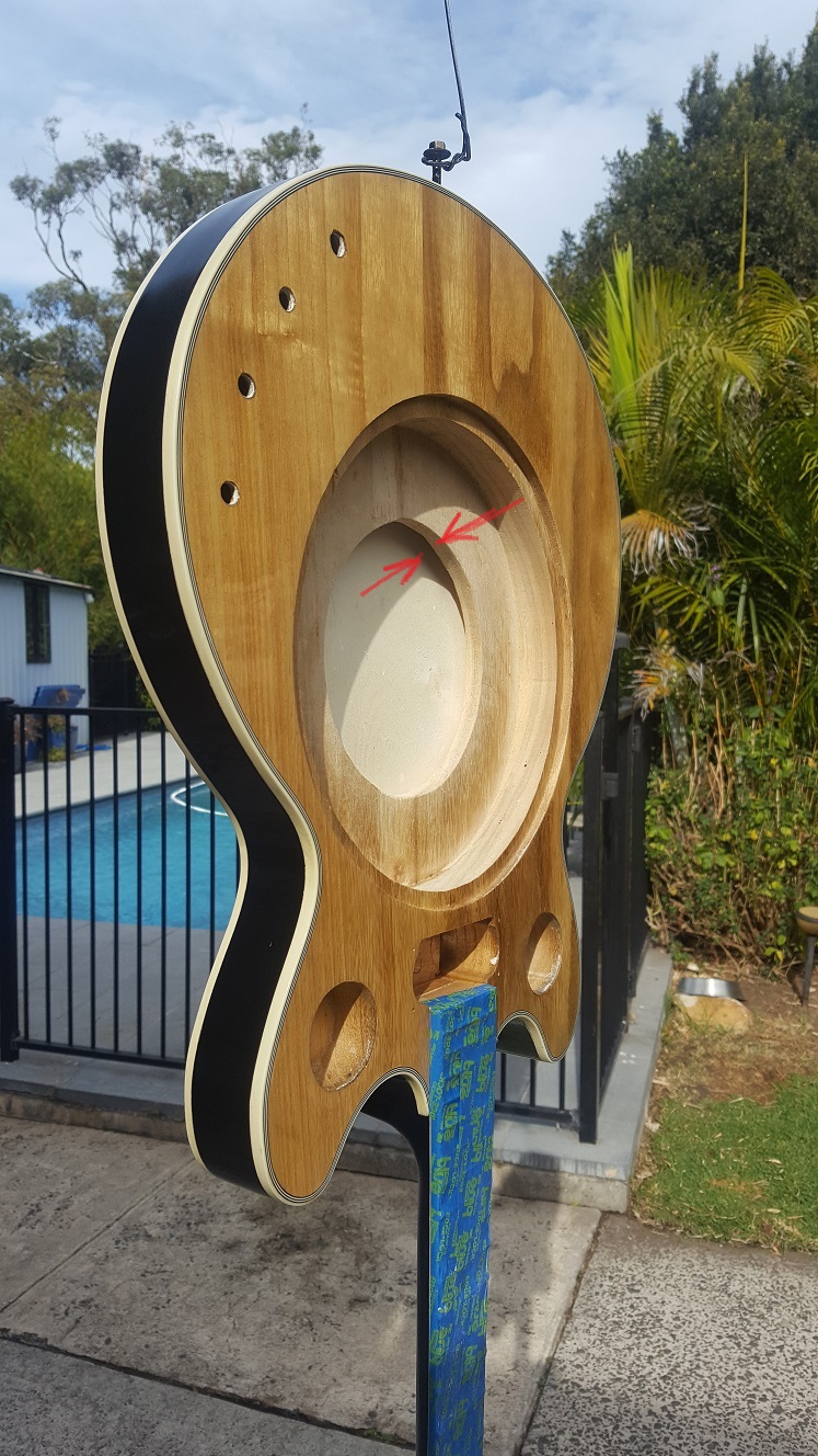

  11. #40
    Dec 2015
    South Coast NSW
    348
    Quote Originally Posted by Singing Frog View Post
    it has a resonator that will resonate regardless of any connection to an amp and a hollow body that will no doubt give is some acoustic properties
    Have you checked the depth of the cutout for the cone?
    Both FrankenWashie and I have (been forced) cut the bottom out of the main body timber exposing a cavity between said timber and the ply back. This increase in volume should help acoustically.
    EDIT, compare photos in post #10 and #25.
