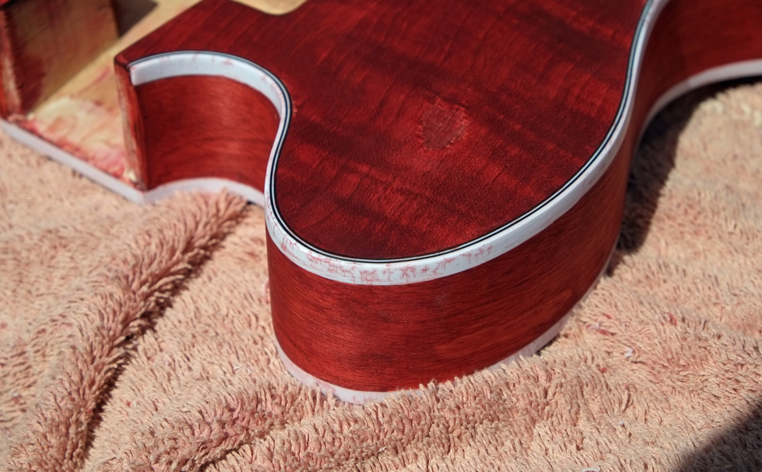

    I must say it is currently making me want to get up and do things in the morning. It's hard to break away from just sitting in front of the computer in my dressing gown and post on forums until lunchtime and then get dressed, but I was up and working away early today!
    You do need to know that there's only so much you can do and let the small things go. There's a mark on the side of the top front horn that obviously came from a stain run when I was staining the top or bottom and didn't notice it and wipe it off straight away. It's not blindingly obvious, but I know it's there. And it will now stay there because I'm only going to mess something else up if I try and fix it (if it is even fixable). A lesson to be more careful in the future and inspect the sides after every stain coat.
    I started out using a fairly big bit of sponge to apply the stain, but that sponge held far too much stain and the slightest squeeze sent a flood of stain over the surface. That got cut down several times, but even now, it's probably a bit too large.

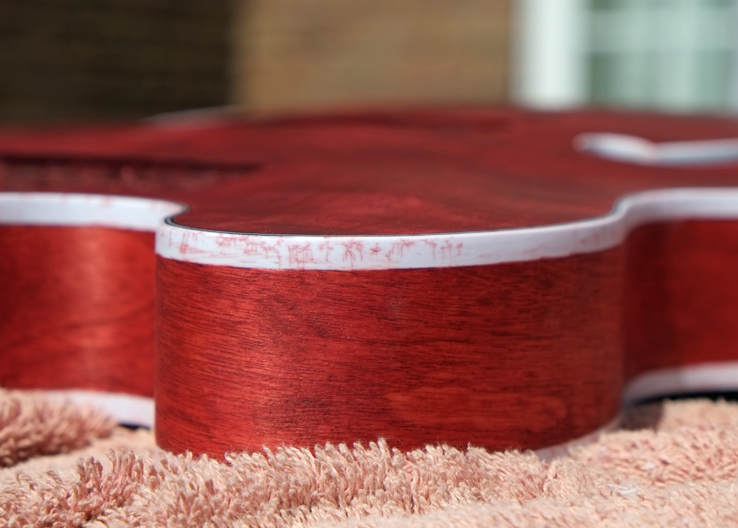

    As I didn't successfully block the F-holes when staining, there were quite a few stain runs that were visible through the F-holes. So I've just painted all the visible parts of the inside with undiluted black stain to tidy things up. I wiped the binding with some white spirit and that seems to have got the last of the red residue off. The body is now hanging in the spare bedroom with the window open to get rid of the smell.

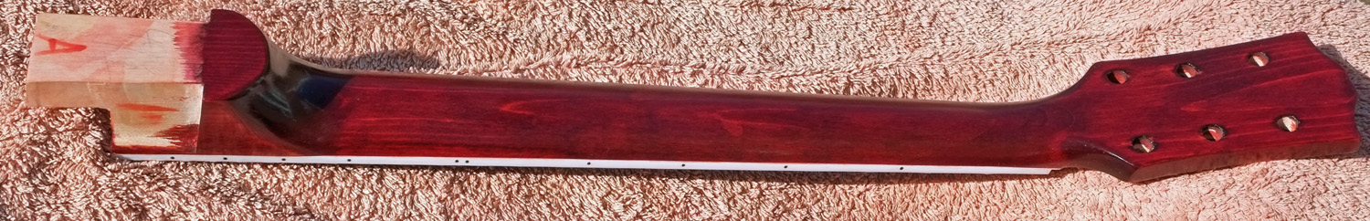

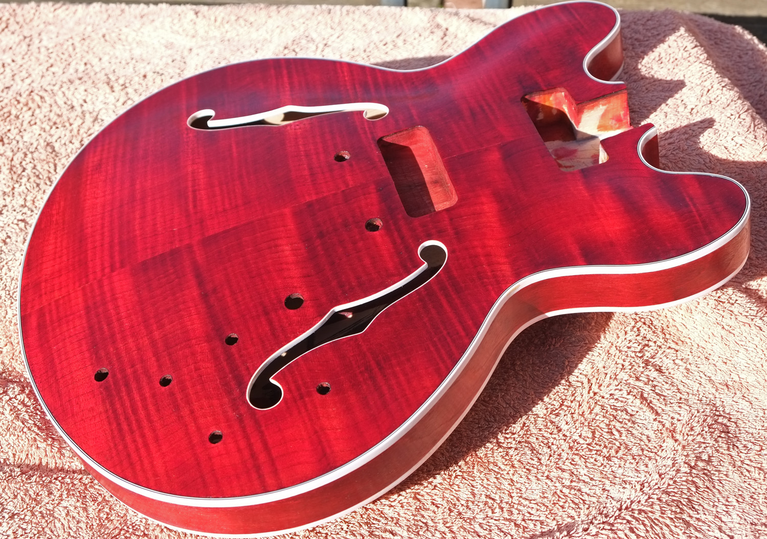

    And here are the pictures...
    Top:

    Neck (rear):
Name:	Neck small.jpg
    That's with the Tru-Oil sealer and then a few coats of Tru-Oil applied.
    It's darkened considerably and doesn't look as bright a red out of direct sunlight, a bit more like maroon.
    There are those couple of awkward spots on the back that had shown themselves up before. I'm in the process of darkening those a bit so they don't stand out as much. The back is a bit patchier than I thought it would be, probably a result of me trying to sand back, before I tried adding some other stain colours. I won't do that again.
