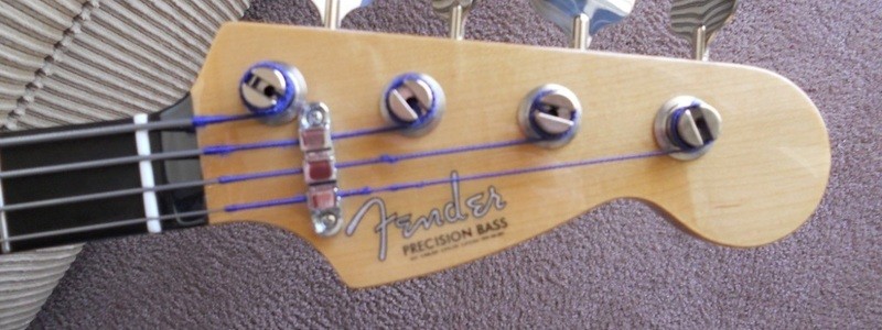

    It looks likethe E and A strings tuners holes are too far in the headstock, they try to pull the nut toward the treble side.
    Do you guys think that will work? When I apply tension to the strings the nut doesn't slide as much but I'm wondering if that is going to cause trouble?
    I don't really want to plug and redrill as I am planning a clean finish...
    Sent from my SM-G935F using Tapatalk

    Hi Fred, agree that angle from nut to E tuner is quite pronounced whilst the others look ok.
    I bought a couple of these Hipshot string retainers on eBay and fitted one to my J Bass as the break angle from Nut to A tuner was too flat and it tended to jump out of the nut slot. Spare one to be fitted on the current MMB-4 build when I get around to installing hardware.
    They work really well and would provide enough downward pressure to keep Nut where it belongs. Mind you, I have replaced both Nuts with DB Bone ones and they are a much tighter fit in the fret board groove.

    Should also mention the chrome is not very thick and chipped a bit off quite easily which made me suspect chromed plastic but on closer inspection probably some coated mystery metal instead but still does the job.

    Thanks for that Waz, I'm going to check these out.
