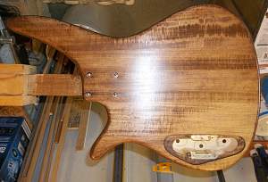

    I've had this kit for about 3 years just sitting in my pile, so it's from the old factory and QA could be a bit variable back then. The mock-up I did when I first got the kit showed that the neck pocket was pretty loose, there were some issues with both ends of the fretboard and some chattering/tearing on the back of the body. No great drama but the intervening years have also taken a toll and one of the body seams has started to open up. I thought I had pics from the original mock-up so I didn't take any new ones, but apparently not, so as a visual aid here's one from the store:

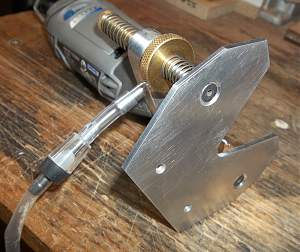

    I didn't want to have to cut the switch tips so that meant recessing them far enough into the body to ensure they wouldn't get accidentally tripped or catch on anything. Some careful measurements and guesstimates suggested I'd just be able to sink them in far enough and still have a couple of mm's clearance over the back of the pots etc… maybe, if I'm lucky. Mounting the switches in a block was going to be the most practical option, so time to make an aluminium mounting plate.
    The two mini switches needed to be on top of the plate to get their tips to match the height of the larger ones.
    To fill the recess so only the switch tips would be exposed I made up a double layer of 3mm acrylic (glued together) with some strategic routing for the screw ends and nuts etc.
