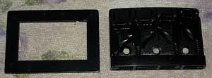

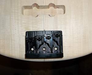

    I'm using a Schaller 3D bridge on this which gives you a lot of flexibility but less intonation range than the stock bridge. It also needs to be positioned a lot further back than the stock bridge… like, at the very edge of the body back, to get the range of intonation adjustment that I want. How much further back? None, none more back.

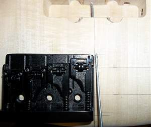

    But, there's a problem. The bridge ground wire on this kit runs to the middle of the bridge pup rout…
    cont.
    Not a problem with the stock bridge, but the Schaller sits so much further back that...
    …part of the hole will be visible at the front of the bridge. Not good.

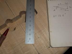

    Given that I don't really like where the ground wire comes out in the pup rout anyway, I decided I may as well drill a new, better positioned, hole for the ground wire. Math time.
    65mm horizontal run with a 16mm drop.
    That should mean a drill length of 76mm at a 13.8 degree angle. The 16mm vertical drop plus the thickness of the drill bit should bring me out around ~1mm up from the bottom of the rout. Hopefully.

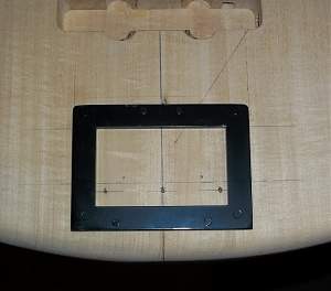

    The bridge has a riser plate to adjust bridge height, which I may or may not use, but it's handy to check where the wire hole will sit too.

    Now that all that's been taken care of I can clamp the bridge in place and check alignment. E and G strings on, pickups sitting in and bridge lightly clamped in place with a strip of wood at the front and a clamp at the back. Everything looks to line up nicely, string position looks good (although the bridge can be adjusted with rollers) and pickup poles are close enough.
