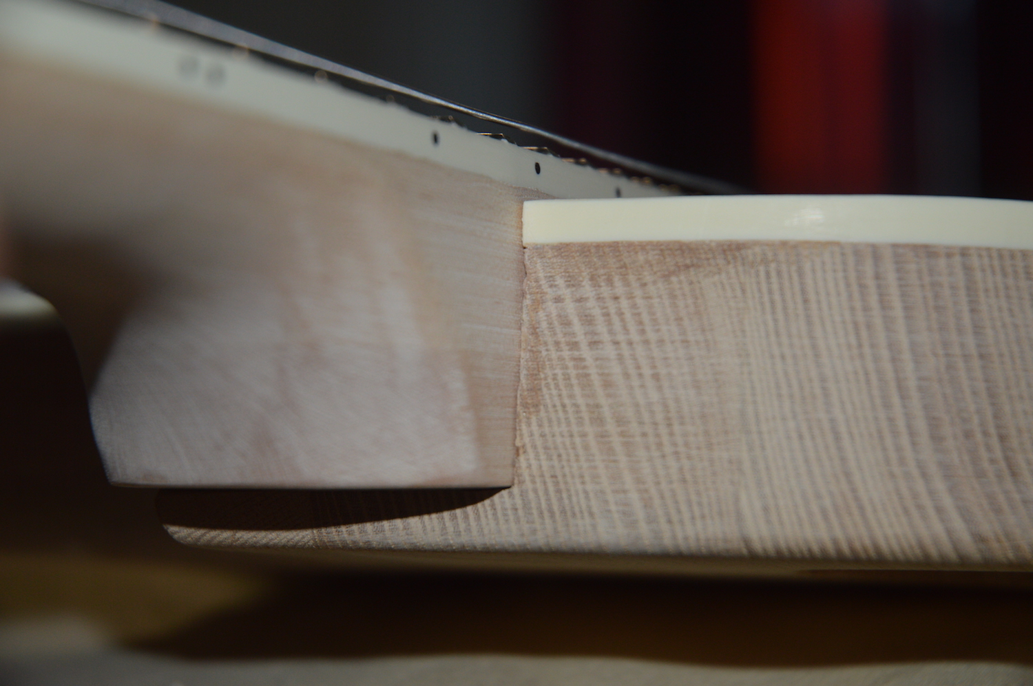

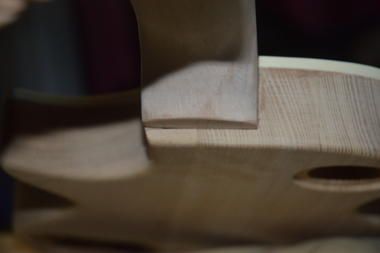

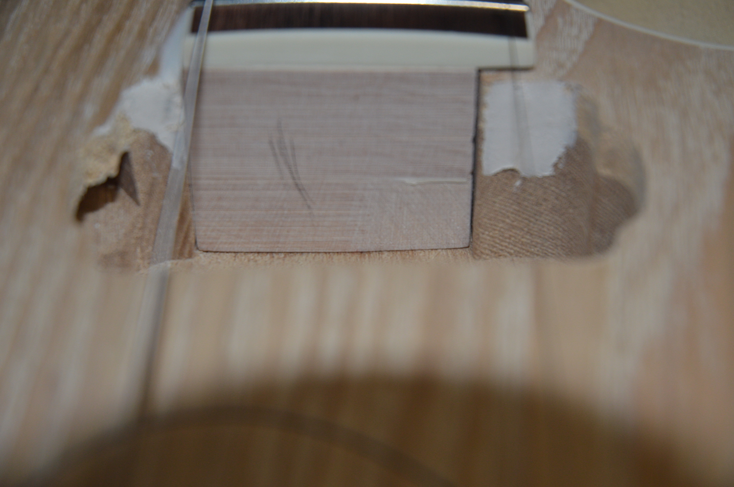

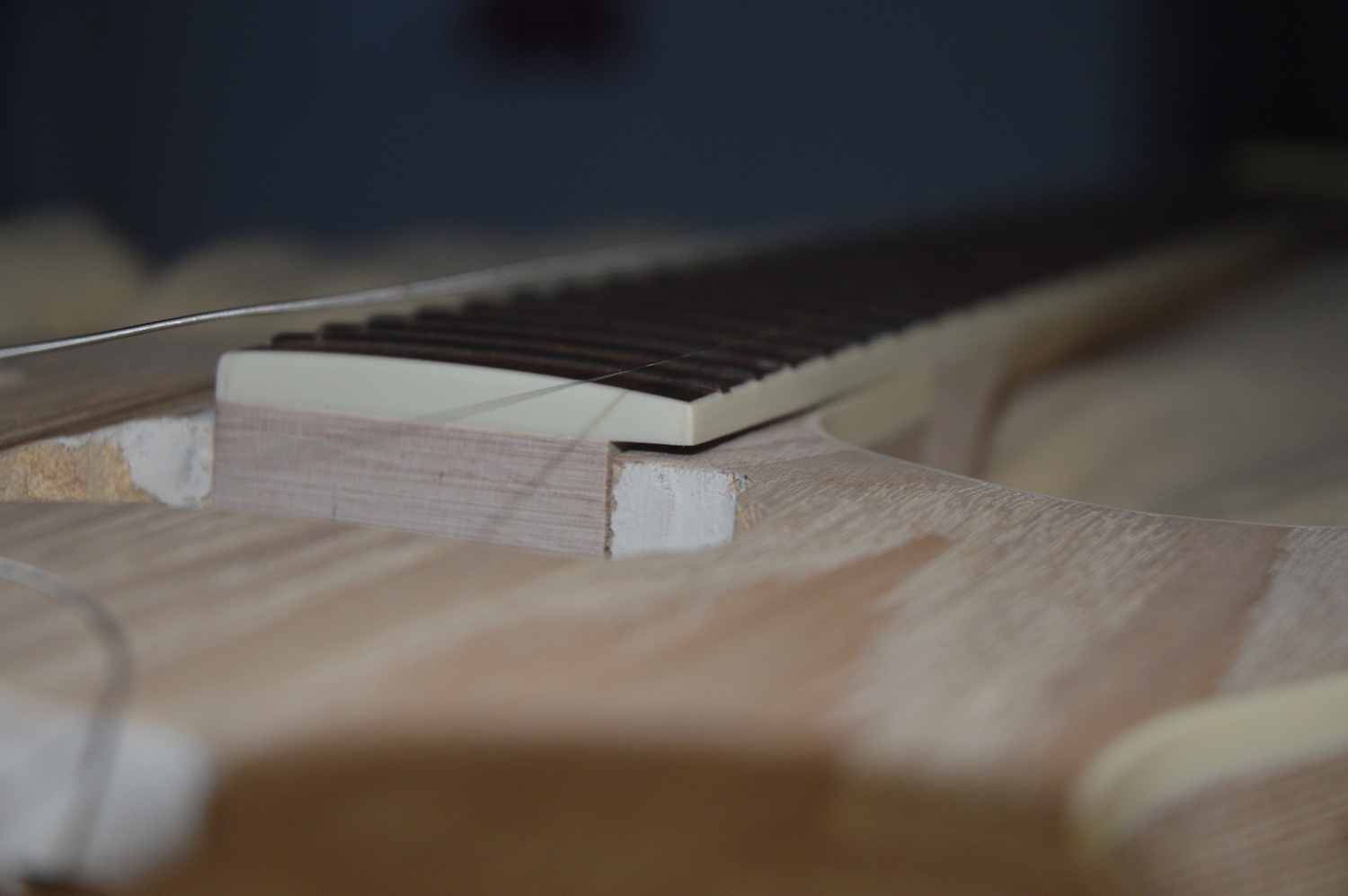

    Finally got back home - Ok, here's the images of the neck set into the body, and around it's pocket.
    As mentioned, neck is sitting at an angle that's insane - I don't think I'll ever have a secure bridge with an angle this much.
    Hope someone can shed some light on this...

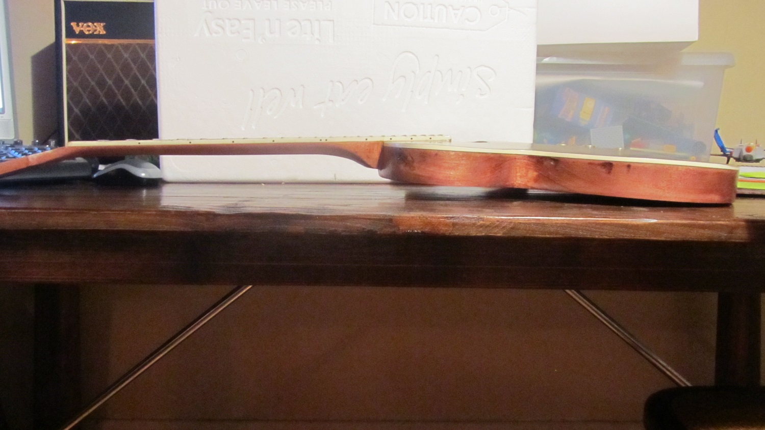

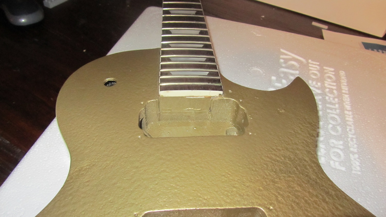

  2. #32
    Aug 2016
    Melbourne, AUS
    134

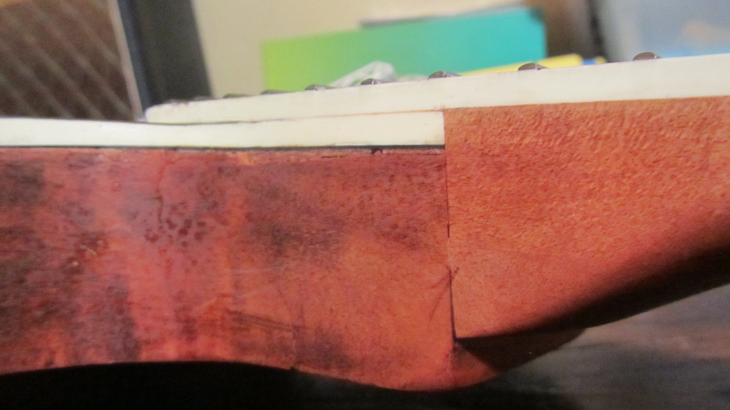

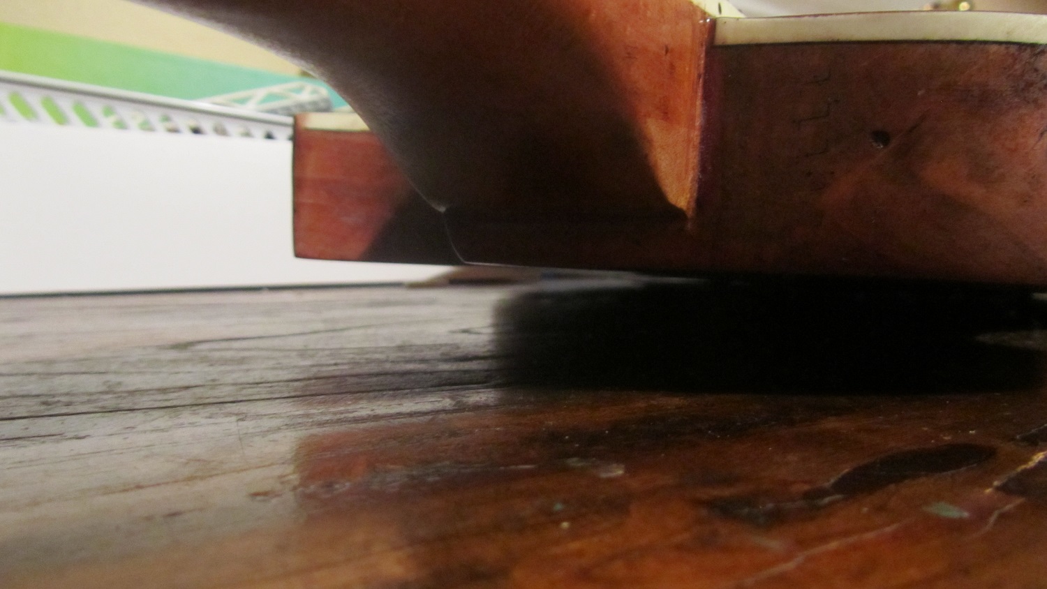

    Quote Originally Posted by depictedminds View Post
    Hi Bro, see attached photos of a Les Paul Set neck kit build. I did this last year and it set up fine and perfect and played great...But I am re finishing this guitar as we speak under Hammer of the Gods build diary..I posted the photos trying to copy yours is so you can get confidence on the neck angle....I think your problem is the neck heel needs to be planed down so the fret board sits on the body..Yours is too high but angle correct.
    You need to carefully 'Lower" the neck but keep angle the same and ENSURE the heel is dead flat for maximum contact between body and heel...At least thats my 2 cents worth.But I am fairly confident it will solve the problem.Click image for larger version.

  4. #34
    Hi DM,
    Looks like the neck is sitting higher on the cutaway side, I remember mine did when i first got it as well because the binding was sitting high in the cutaway. if that's the reason just sand the binding down, otherwise i agree with HB.

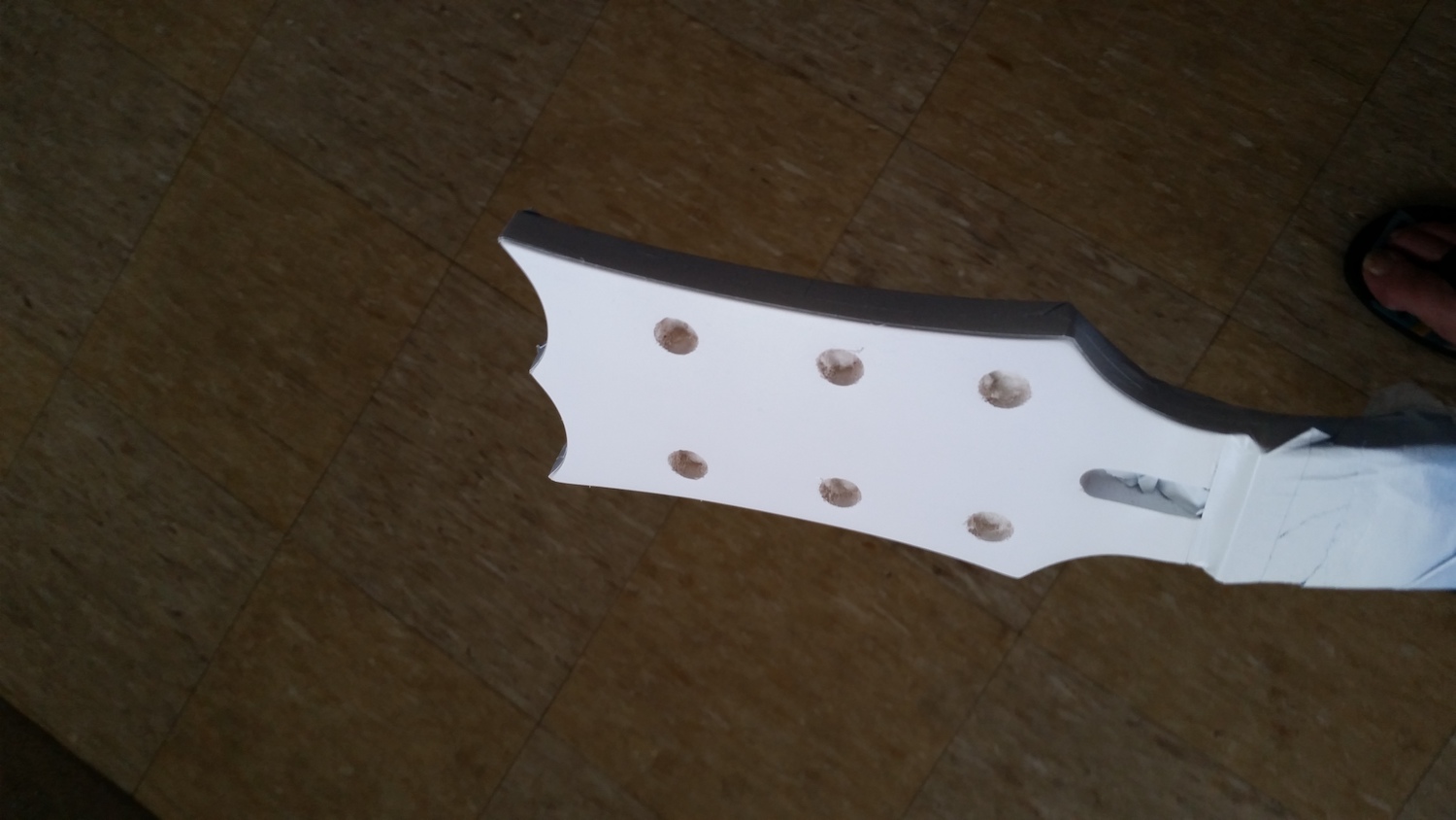

  5. #35
    headstock - nothing fancy or over the top, but I was happy with the dremel work here... slow and steady....

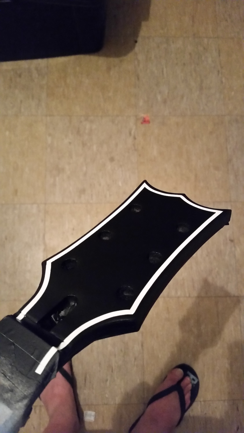

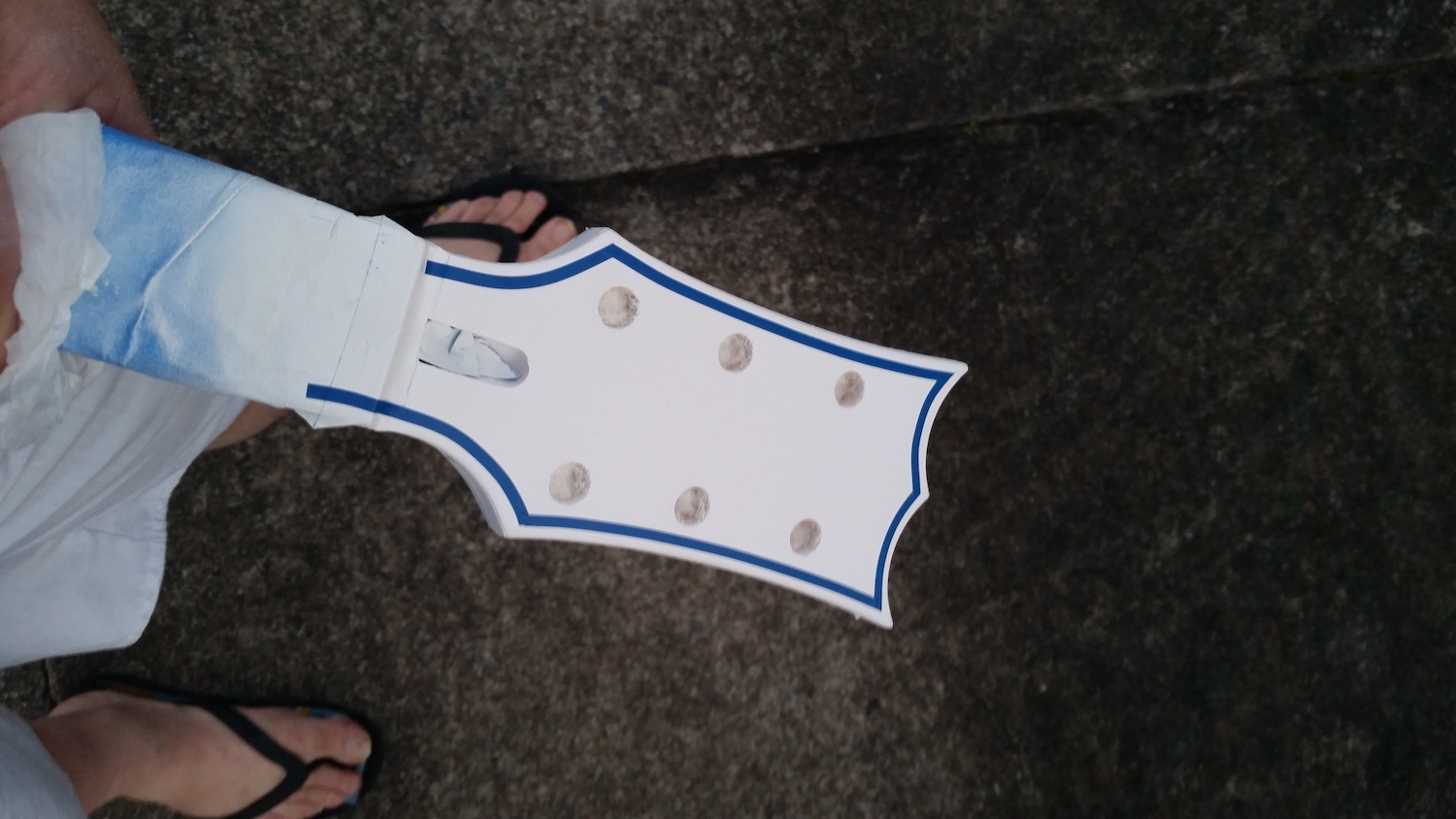

  6. #36
    Headstock painting day (number 1)
    This is going to be a solid black headstock face, natural wood side and back, white pinstriping on the face, with a opal decal.
    So - step 1 - Face painting. After getting this smooth as a bub's backside, Super nice masking, and a blast of white. Following this will be another blast of white, and then the pinstriping begins.
    By the way - thanks to everyone that helped me out with the whole neck thing - After reading over and over again, It started to become a little trivial that the neck heel was going to be a shade larger IN ALL THREE DIMENSIONS (.. duh) cause smaller would be just outrageous. It's pretty much spot on perfect now - but im not touching the body yet until my dingotone comes
    More soon!
  7. #37
    Pinstriped done...
