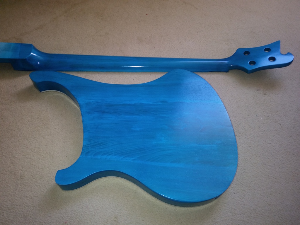

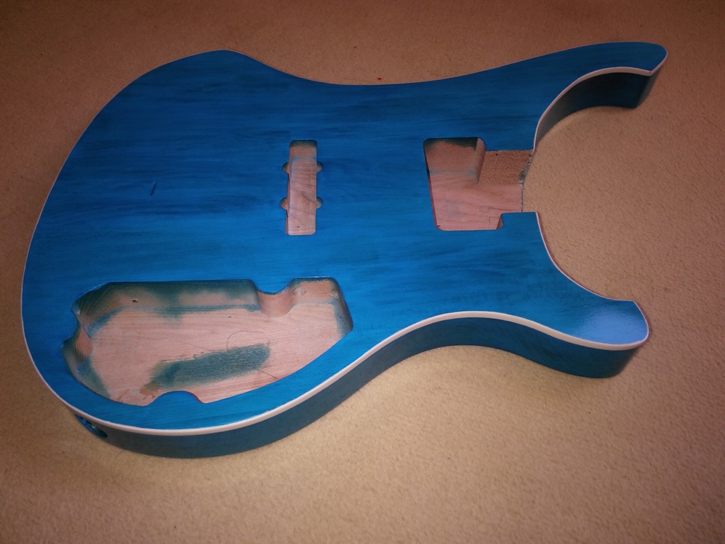

    Finshed the top coat now, as I have used a spray top coat on top of the tinted laquer Inow have to wait a view days before I can start the flatting. However have now scraped the binding, so it's looking a lot smarter, that was quite a job - took me a whole day, but overall I think it was a lot better than trying to mask it. Got the scratch plate to cut out now, have bought a pearloid one instead of using the standard white, think it will look a bit smarter. Be back in a few days when I am ready to glue the neck - will have a few questions then as this is my first ! Cheers

  7. #37
    Hi Alan, looking good.
    From the 1st pic it looks like there is a bit of stain finish on the heel of the neck where it will be glued in the neck pocket. I think you will need to sand back to the intended edge/line where the neck extends out of the body otherwise the glue might not hold, particularly once under string tension.
  8. #38
    Thanks for the tip, I haven't removed the masking tape from the end of the neck yet, but I will make sure it's all clean round the neck and the pocket before gluing.
  9. #39
