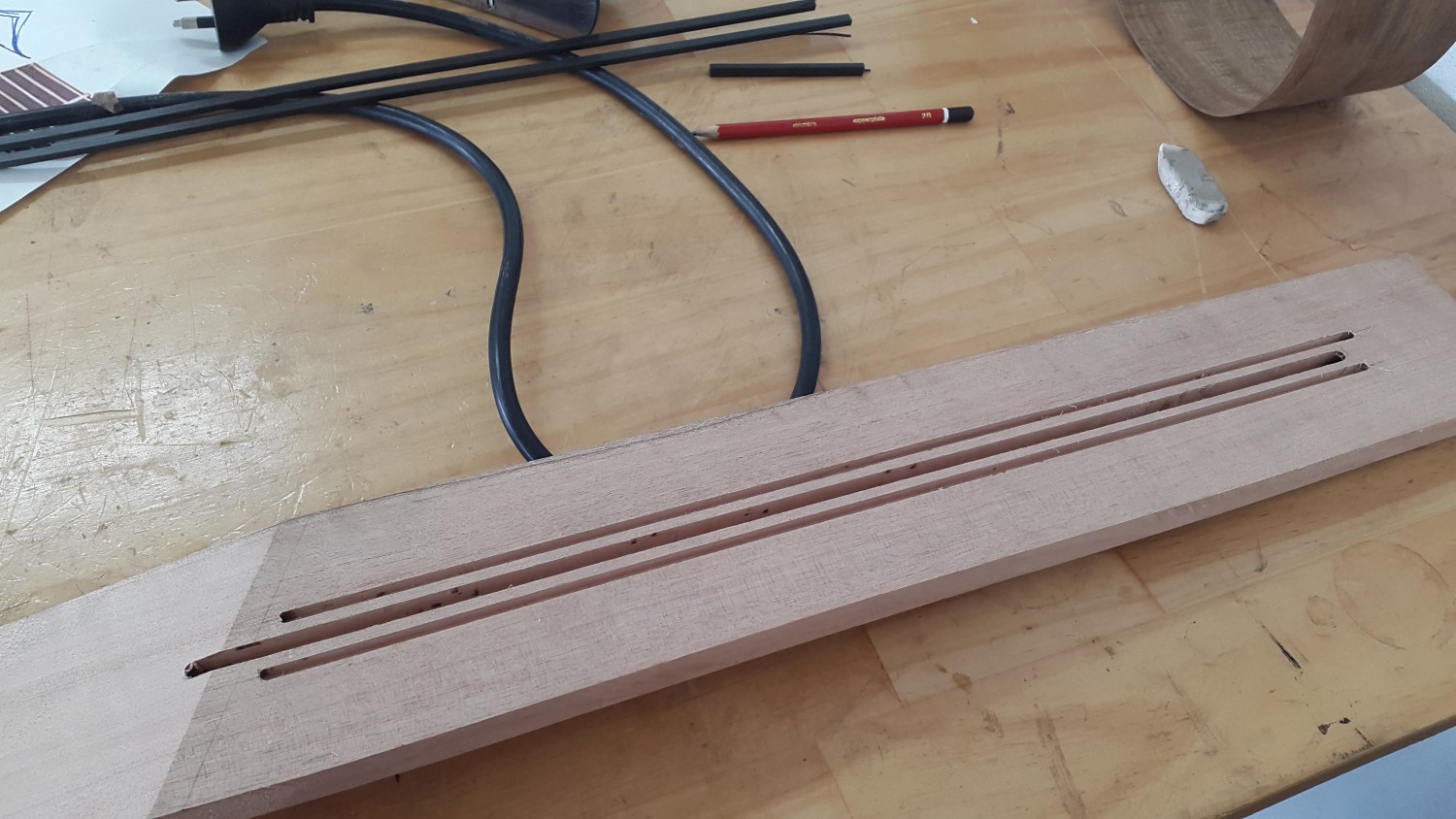

Name:	20160429_125307 (Custom).jpg
    So then we decided to rout a couple more holes. Because.....
Name:	20160429_125321 (Custom).jpg
    We're putting a carbon fibre rod in the neck on each side of the truss rod for tons of stability. Just to help out because of being a 7-string and a fairly long scale length on the bass end.

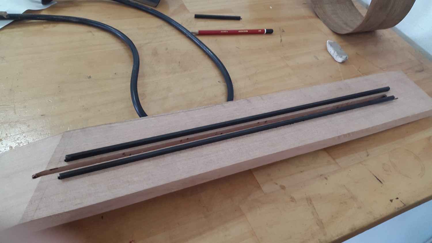

Name:	20160429_131539 (Custom).jpg
Name:	20160429_131545 (Custom).jpg

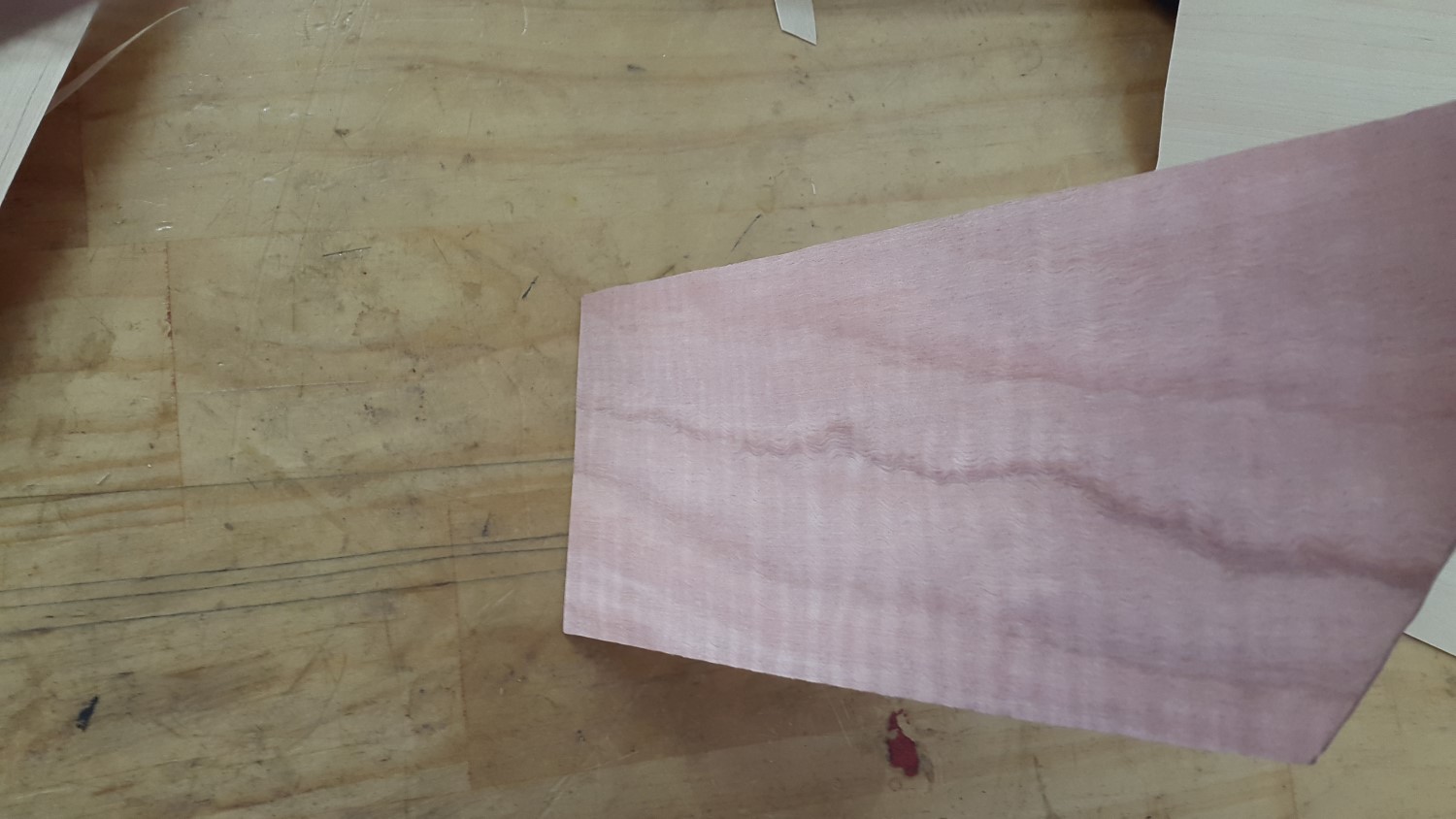

    Then it was time to glue the headstock veneers on. This was all basically the same deal as last time, and I did forget to grab a couple of extra pictures towards the end. So yea, thin Maple veneer between Jarrah and QLD maple because why not, it looks cool. And that's all!!
    Next week will be sorting out the fretboard, maybe some other stuff if we're lucky. ALSO if I'm lucky, I'll be getting some Bloodwood to use for the fretboard!! There was a piece hanging around in the workshop, and we had been talking about what I was going to use earlier, so I thought that would be cool, and since the Jarrah will come up reddish too, it should fit the colour scheme of the guitar overall. Also it just felt really nice to hold
