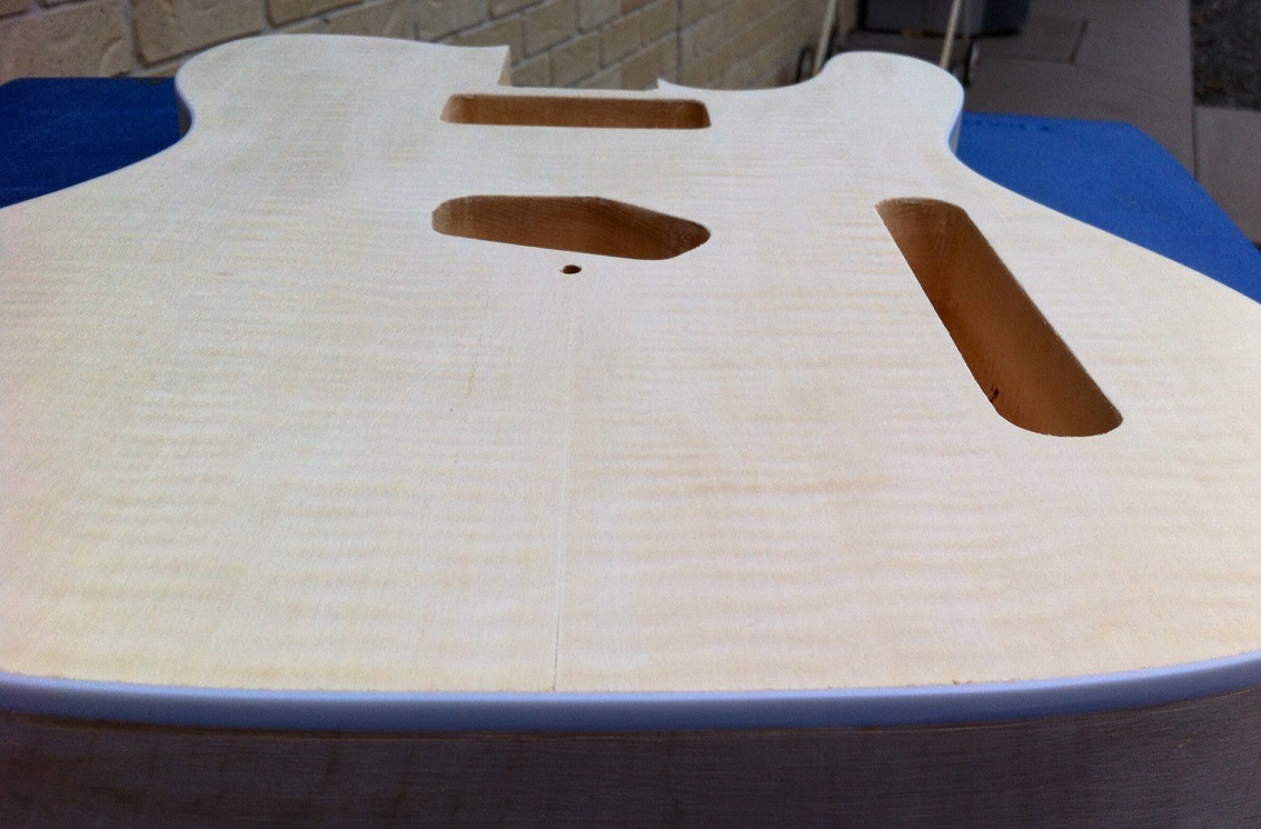

    thats a good tip Waz trying to get the neck stain to match the body. You can always sand the neck super smooth once the clear coats have been built up.
    Spot on Woks as that is exactly what I did with both the neck and flame top as I was paranoid about sanding through the paper thin cap and the necks arrive quite smooth straight out of the box.
    Once half a dozen or more clear coats were done was when I started the ultra fine wet sanding and highly recommend such to help achieve depth of colour on the neck.
    Also, for the flame popping I used cyan inkjet printer ink mixed 50:50 with water, left 24 hours to dry and then used a damp rag to wipe off as much of the ink as possible before applying the second coat. Surprised at how dark that stuff is out of the bottle and had to dilute it to get the lighter colour and by using this method saved heaps of time by not having to dry sand the body anywhere near as much.
    I see plenty of guys doing the black ink pad trick and then dry sand to pop the grain and this hint could save them plenty of time and effort.
