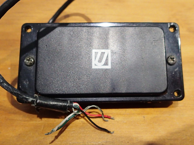

    Ultrasonic neck pickup

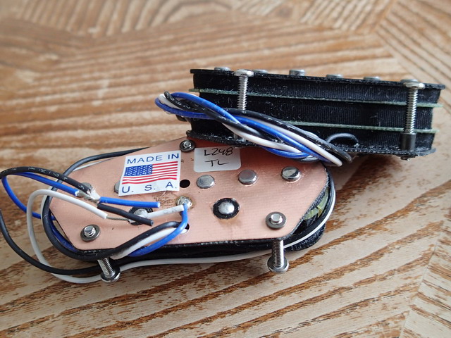

    2 tele bridges,notice how they are stacked

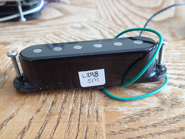

    And the strat pickup

    The Ultrasonic, strat and a Tele Bridge are going into a telecaster HB/S/T and wired in all sorts of crazy ways, the other tele into a single coil tele Esquire kind of build with some more crazy wiring.

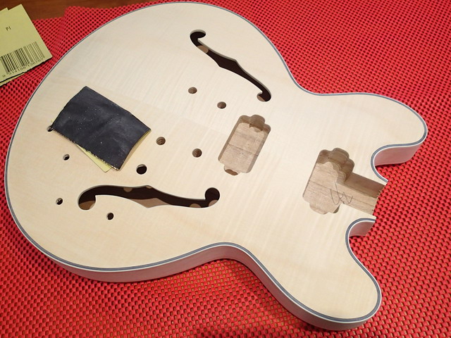

    Got in and sanded the body today, 220 then 400, i then ran my fingers over the whole top and bottom and got any rough patches, the top bout was the worst, i didnt want to go too hard for fear of breaking through the lam top.

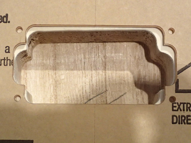

    I quickly measured the front HB route with my HB template, and i can see i need to have a bit of a sanding out there. I need to leave the neck side of the route as is, i dont think theres room for the neck if i route it forward.

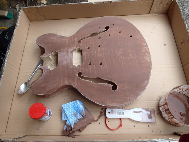

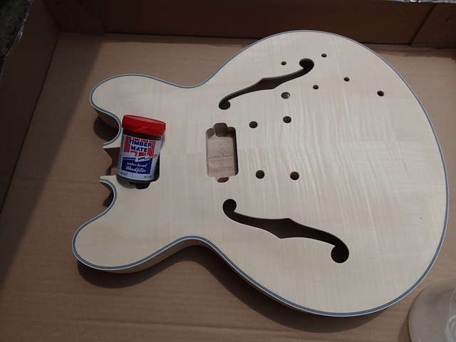

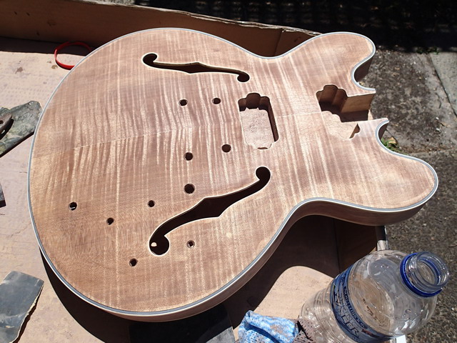

    Out with the timbermate, i chose walnut to pump the flame a little, seeing as i am using the color tone cherry red.
    The bass wood on the sides is having the filler then tru oil, with out anything else.
    the rear of the guitar not filled yet, waiting for the top to dry, will be the same as the top.

    whats a mess Mr Hart

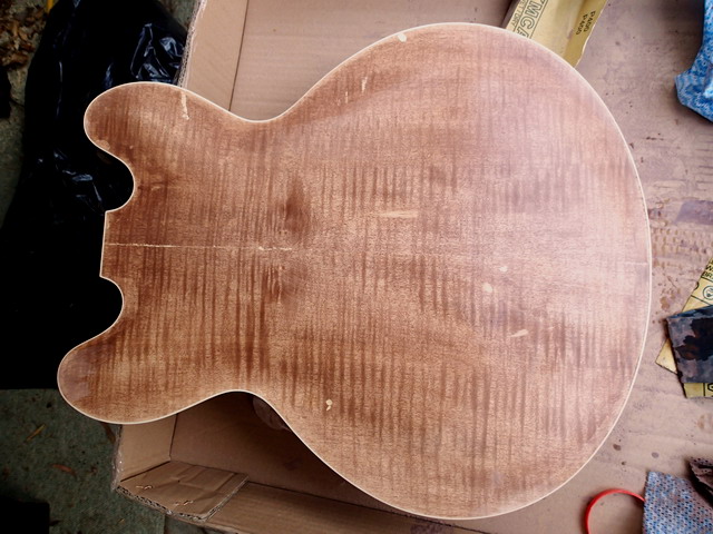

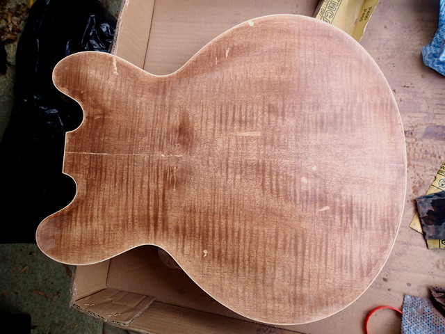

    Some blotching on the back, about 6 marks like this showing through, got a feeling its glue residue.
    Will deal with it tomorrow when i sand the body.

    Lots of trouble on the back, will try some Goof Off if that fails i will stain the back black and see how that goes if that fail i will spray it solid black. Still alot of sanding to do but i thought i would get stuck into the back because i knew those marks were there. On positive i found them before i tried to do a finish.
    Theres always a work around, and then there's the bin haha jkn

    Well its defiantely all chips, scratches and fill, sooo looks like a solid colour on the back, or try the black color-tone dye watered down a bit and see if it hides it at all.
    Oh well it was a nice flame.

    I was going to tru oil it after i stained it, trouble is once i am committed it stays.
    The actual body colour looks lighter than the pics, and thought it would look good at is with the TO on it, but i am worried about the repairs they tried on it before it left China.
    My brother has been through alot of Chinese guitar makers factories, he said he never saw one veener that wasnt as thin as rice paper.
