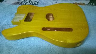

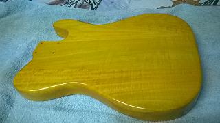

    The fresh kit of Dingotone did the trick!
    I ended up having to strip the body back to bare wood to remove all traces of the multiple layers of the original product.
    A quick re-stain with the little bit of stain that I had left, 3 coats of Intensifier and 3 coats of Finish later gave me a result that I'm happy with.
    The surface isn't flawless and the finish isn't perfect but I'm happy and so will my daughter be. If I'd wanted flawless and perfect I'd have gone and bought my daughter a finished 'shop' telecaster.
    I'm about to fit the neck and hardware so I'm on track to have it finished for the kids 21st birthday on the 5th of next month.
    A young bloke a Custom Music in Wagga Wagga is going to do the fine tuning for me.
    Really looking forward to hearing it play for the first time.

    Looks great Rob is that coolangatta gold?
  9. #39
    Thanks wokkaboy...
    Yep, Coolangatta Gold. I only had a little bit of stain left after my first failed attempt at finishing it so the colour is a bit paler than I initially hoped for... I still like it though.

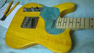

    I made a custom pick guard from clear perspex with a thin sheet of copper behind it. I 'aged' the copper with a witches brew of bleach, vinegar and salt to get the colour I wanted.

    nice one Rob love the pickguard look and shape. Looks like you are on the home stretch, looks great
    I've used DT CG on a few builds and love the colour. Goes really well on your tele with the maple neck
