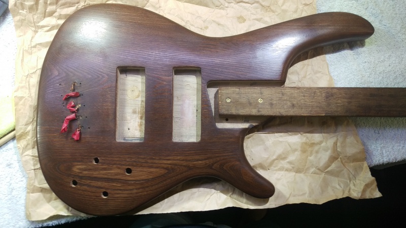

    Hey guys,
    I haven't updated my build diaries too much, but I've been slowly progressing the IB-5.
    After a few tests, mixing DT walnut with Black Stump, I found a mix I liked, and I started applying to the neck.
    I also added some black stump to the body walnut Intensifier.
    Always look amazing when wet... a shame it doesn't keep this look when it dries!

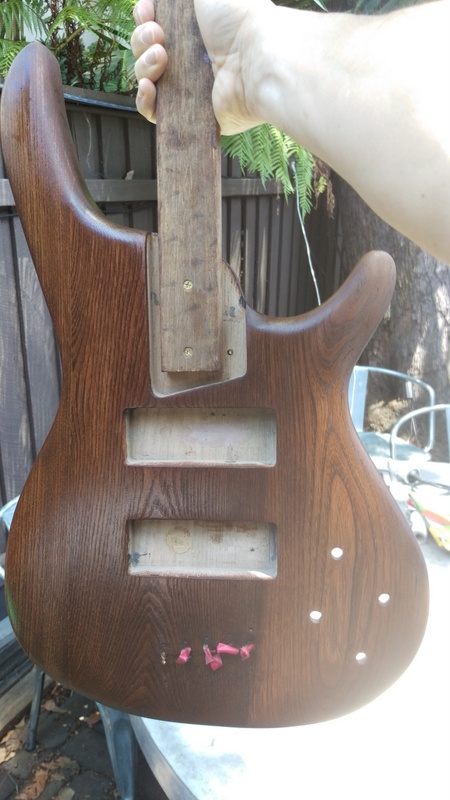

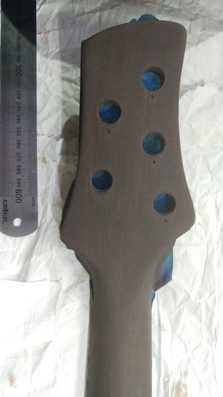

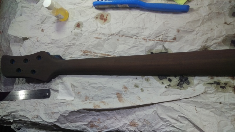

    With the neck, it got 4x coats of stain, and I managed to get it to the colour I wanted.
    It looks very dark in the garage / mancave:

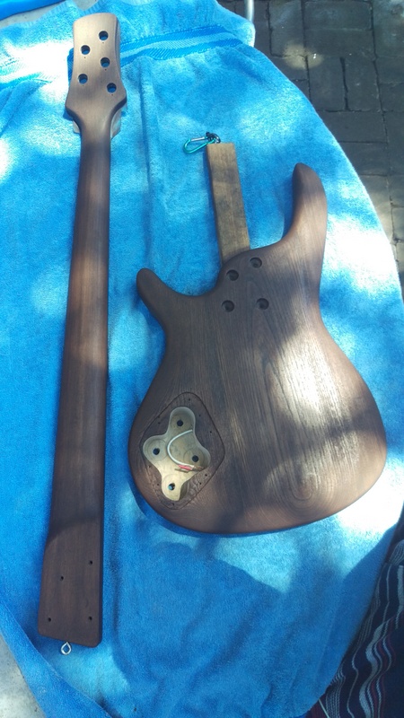

    But in the sun, the body and neck are now colour matched:
    So now that the staining is finished, I've applied a first final coat to the body, and a first top coat to the neck (I had left over clear neck DT from the STA-1). We'll see how it cures...

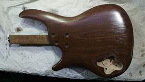

    I haven't posted any update for some time now, but good progress have been made!
    After an initial attempt with DT final coat where I wasn't too happy with the result (it was DT Mk1), I decided to do the top coat of the bass with Aussie Oil. I really liked how it worked out with my 12 strings, so easy to apply and looks great. So I applied five coats, then wen ton holidays for 2 weeks, and then reapplied 5x more coats.
    Got a pretty nice finish. I didn't buff this one with the Meguiar products this time as I didn't want a super glossy finish:

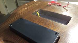

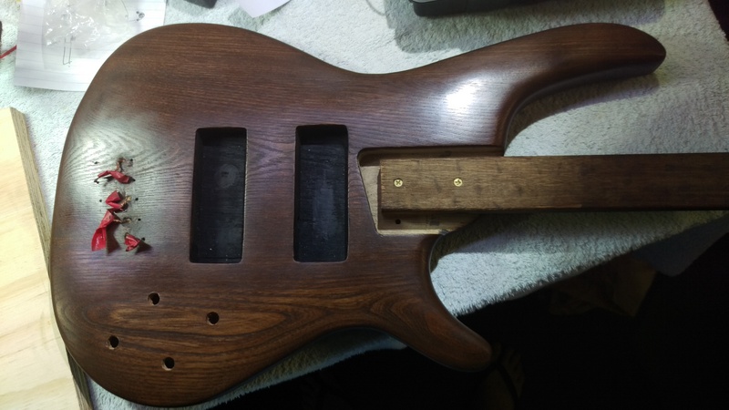

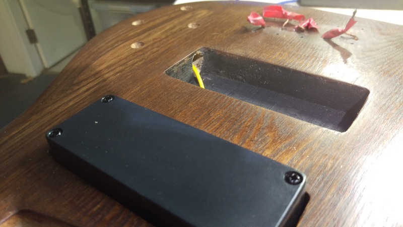

    I then painted the pickups cavities in black as I didn't want bare wood showing:
    Made the hole for the pickup cables to control cavity larger to allow the cables to sit under the bridge pickup:

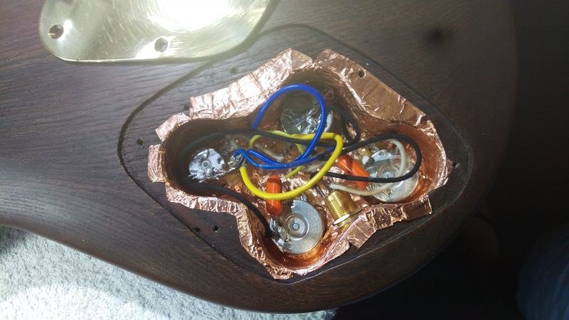

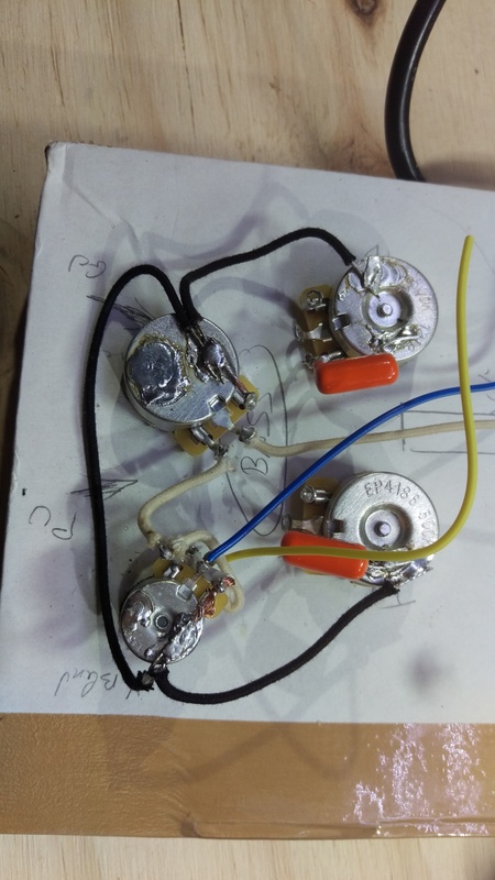

    Then prepared the electronics outside the guitar:
    And I reckon I used the .047mfd orange drops that were meant for a normal guitar instead of the .022mfd I was planning to use... may have to change them later...

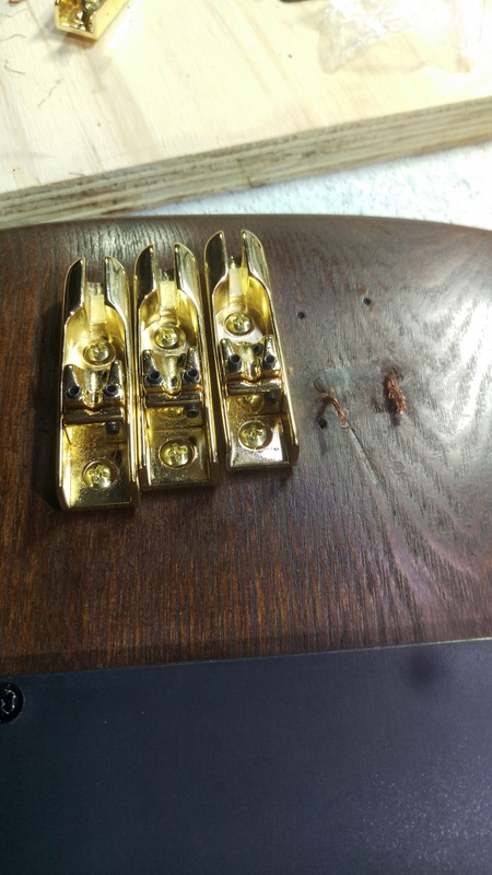

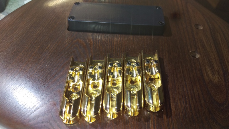

    I then installed the 5x bridges, earthed each of them with the copper wires I had laid before finishing, and managed to get them looking almost parallel! Wasn't a given... I never thought it would be so hard to drill 2x rows of 5 holes perfectly equally spaced... I guess I know now!

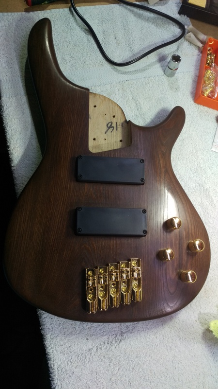

    I then fitted the electronics in the body and soldered the earth wires, jack and pickups:

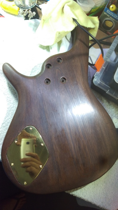

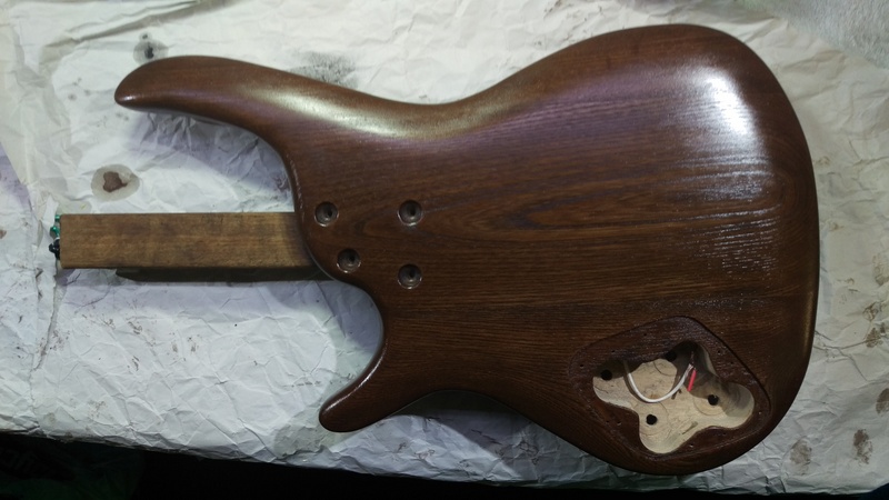

    And I closed the control cavity with the brass plate I custom made months ago!
    Here's the back:
    And the front:

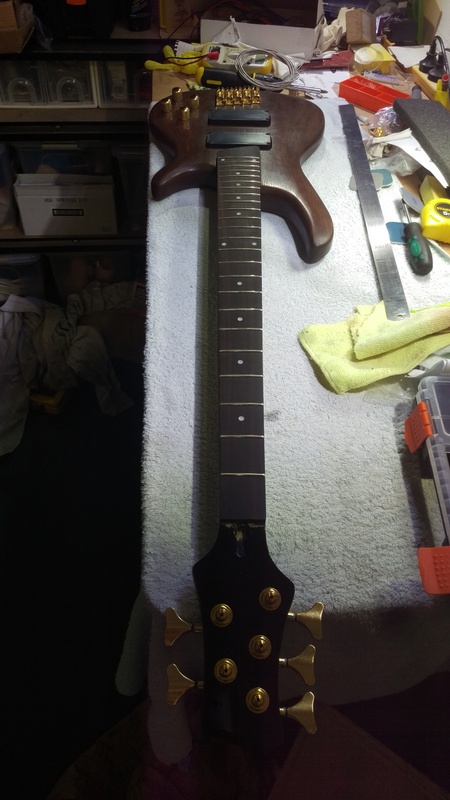

    Just needed installing the neck:
    Then bone nut and strings!
    It's still with the chinese strings as I'm finalising intonation and I prefer to mess around with cheap strings.
    Pretty happy with it, and now, I only have to learn to actually play the bass! :-)
    I'll take proper photos with the SLR, outside later.
    Cheers
