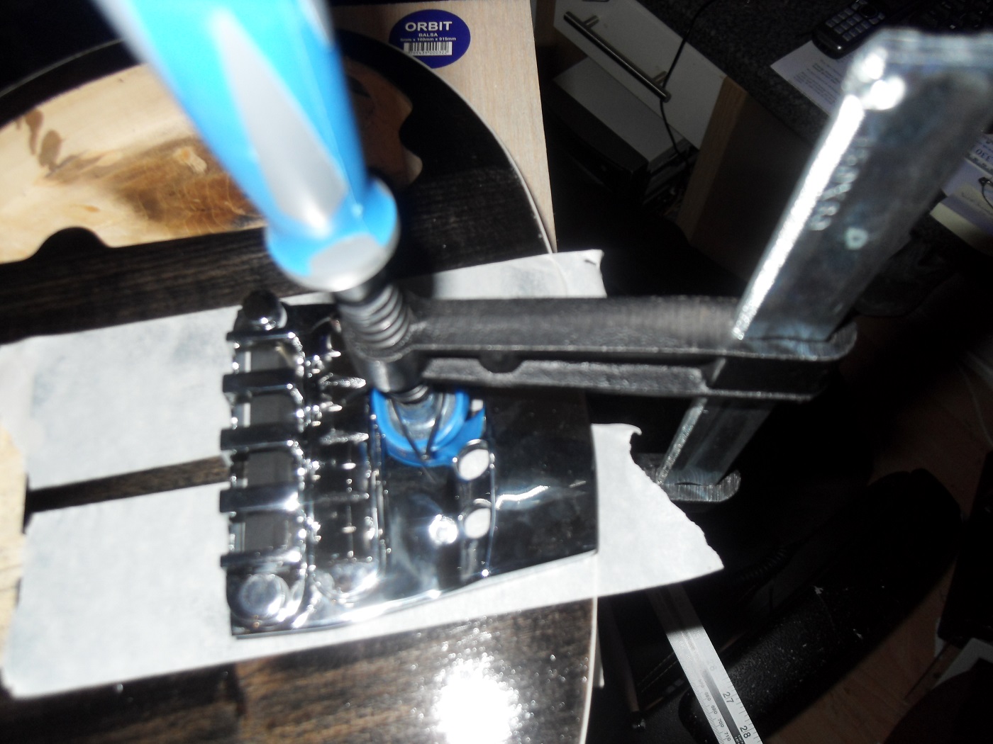

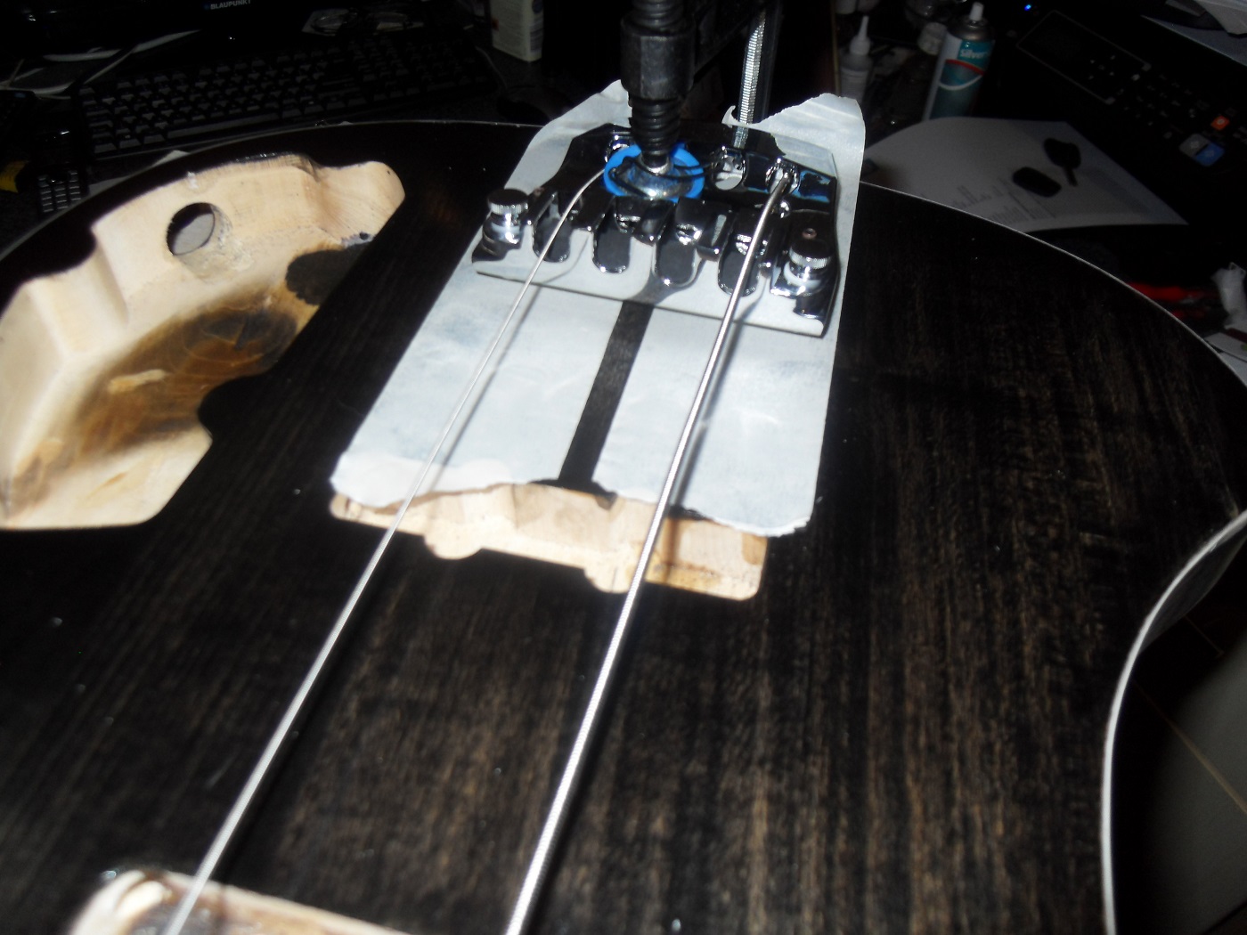

    Greetings all, the tail is strings through the the unit not through the guitar, working out the location of the tail i am going to be masking tape to guitar top, clamp into place as suggested, use my steel straight edge in place of the strings to line up the unit to get it centered and set for length for intonation, drive in a couple of screws then use the strings to double check, once i'm happy i will then draw the out line of the plate then add the rebates where needed.
    Yes i did set the neck before doing any other work, to do this i clamped body and neck and then used a straight edge steel to check on line and rake also making sure the truss rod was backed off.

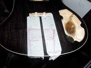

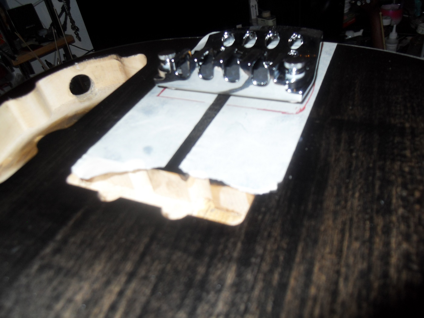

    Prepping up ready to fit tail unit, after applying masking tape i set location using clamp, steel straight edge and measure. checked with top and bottom string before tracing round the tail unit, drew freehand slightly inside and trimmed with a craft knife leaving masking tape template. Ready to be routed/carved out, i may go down to my lock up tomorrow and dig out my woodworking chisels.

    The whole tail unit sits on the top of the body, the only part that is to be carved out is the hatch marked area.
