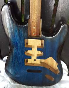

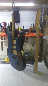

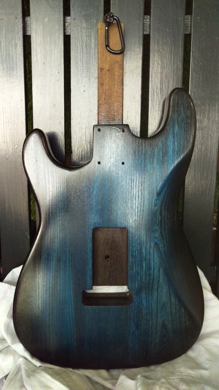

    Next step for this weekend was start spraying the gloss. Weather has been shocking all weekend in Sydney so quite humid, but I couldn't let this block me!

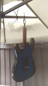

    So when the showers stopped I hung the body from the umbrella:
    That gave me a nice place to hang the guitar from outside, quite protected!

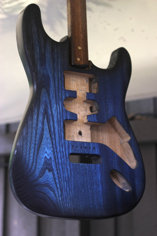

    Because it was quite humid I only sprayed very thin coats, 2x on Sat and 2x today (Sunday). I left a lot of time between them.

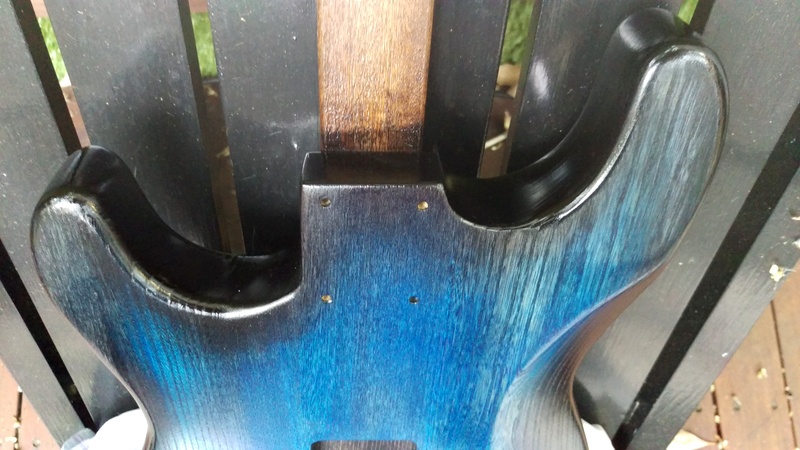

    Anyway, it changed the look of it and the body now has an interesting colour. Not quite the pure blue and black I had in mind, but I like it:

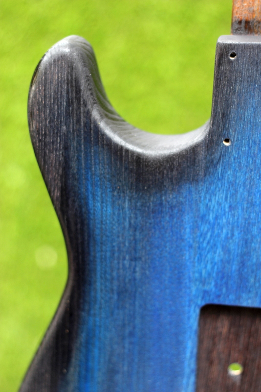

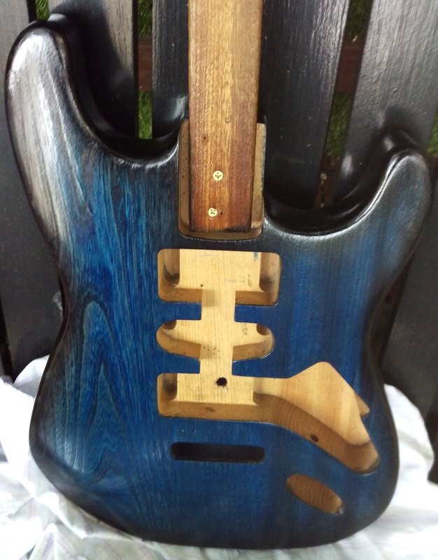

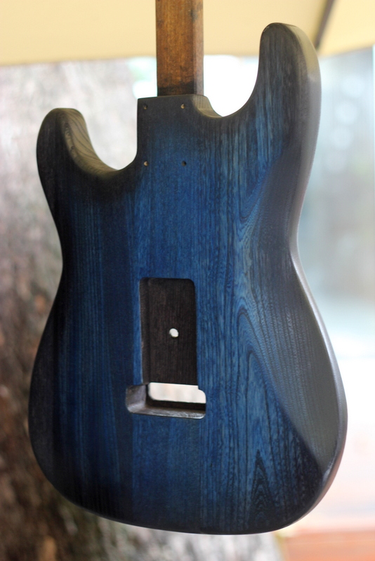

    And here are some close up photos:
    It looks like one of the wood pieces that makes the body didn't take the dye like the others... but I guess that will contribute to the 'handmade' feel!
    So now I'm going to leave this cure a little bit, and I'm thinking I'll give it a nice wet sand at 800 or so this week so I can start spraying again next weekend. Hopefully the weather will be dryer and I'll be able to put a bit more gloss on this one!

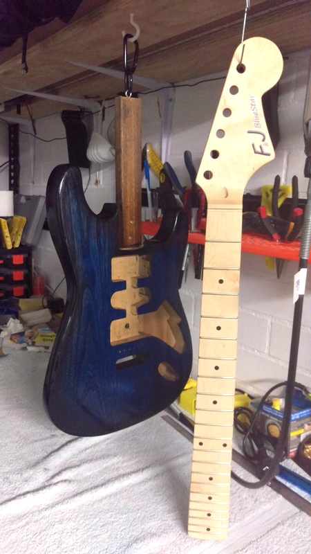

    Forgot to add that I put the first coat of Dingotone on the neck.
    I loved the smell!
    It is so much nicer than the chemical stuff... I reckon the next build is going to be all Dingotone!
    Anyway, body and neck are now nicely hanging side by side:

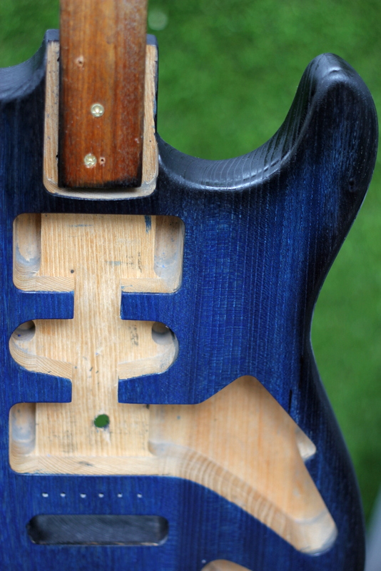

    After leaving the body to cure for a week I sanded it back with some 800 to flatten it a bit.
    Now that the surface is sealed, it really showed that my grain filling didn't work too well... I guess I had the same issue that Gavinturner mentioned, the timbermate getting removed by the wet dye.
    Anyway, I'm going to see if I can fill this with gloss over the next weeks... but I'm thinking I actually like it with the grain showing too... we'll see

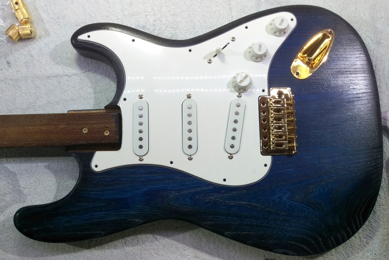

    In the meantime I tried the scratchplate, bridge and jack plate on to see how it works colour wise and I'm pretty happy with the result:

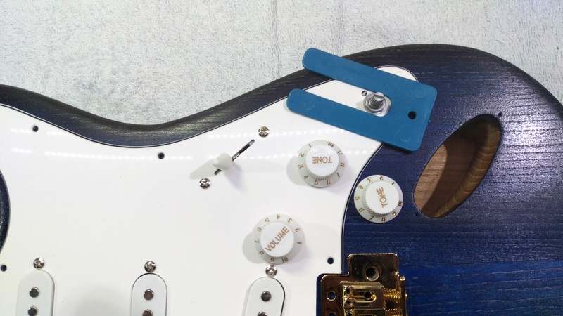

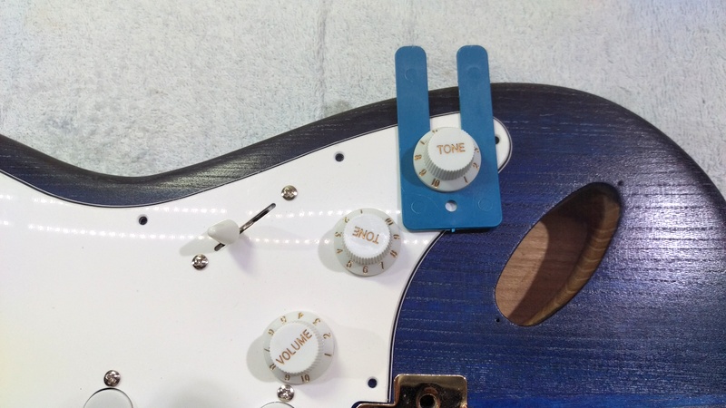

    I've bought gold knobs that I'm thinking may replace the plastic strat ones, so I went on to remove the strat knobs. I had read different ways of removing them with screwdrivers, credit card, etc.
    But I actually had one of those windows packers near my workbench, 1.5mm thick and I gave it a try, worked pretty good:

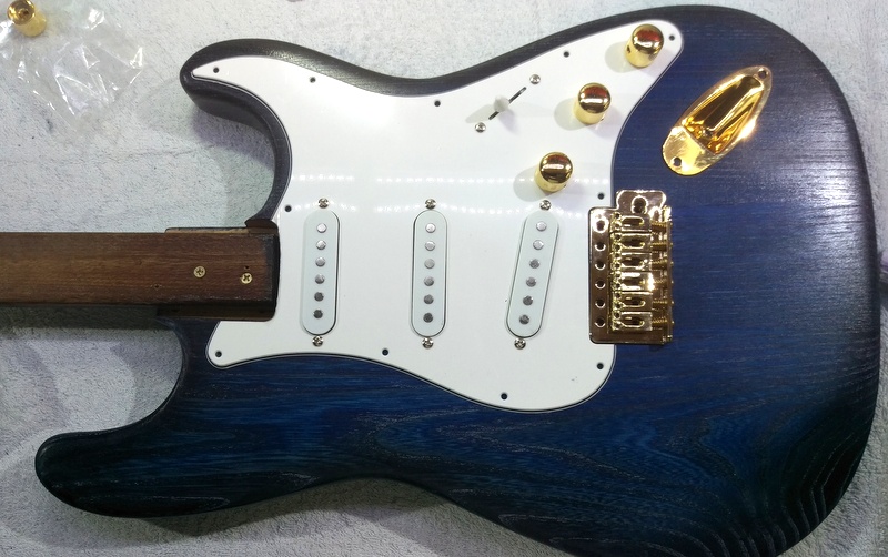

    And now with the gold knobs:
    I think I like these, but I actually like the white ones too... anyway, we'll see once the neck is on, etc.

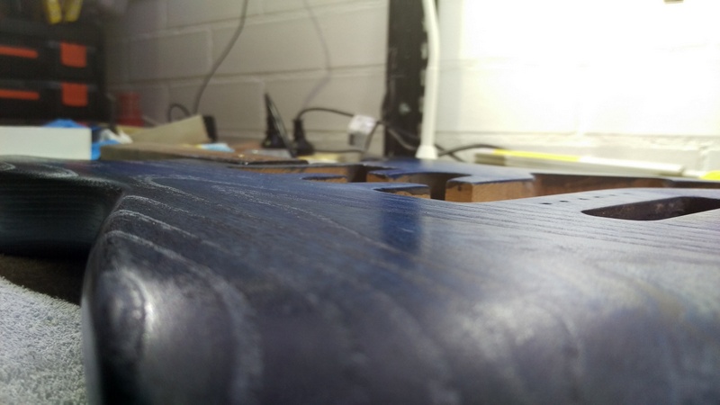

    I sprayed a few more coats of gloss too:
    I'm going to have a fair bit of sanding to do before I continue next week as I rushed the last coat of the day and got some pretty bad runs...
    Did someone say to be patient?...
    Anyway, it's good I wasn't planning this one to be the last coat!
