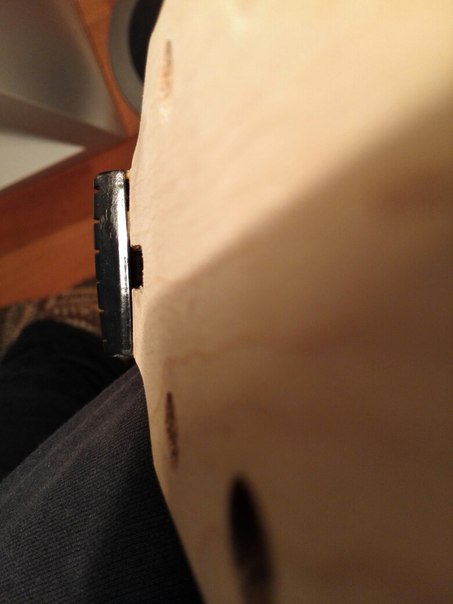

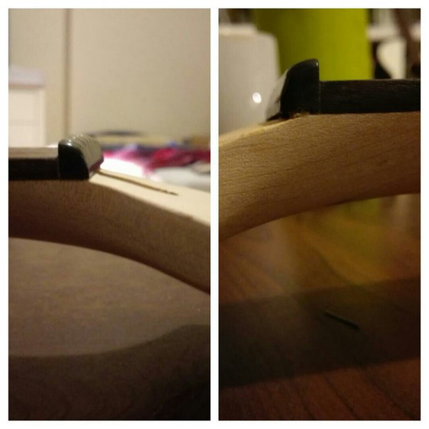

    Hello
    I think that there is something wrong with neck, headstock is curved, and nut almost hanging in the air.
    What do you think?

    Hi Eugene,
    I had a look at your photos and I have a fix for you.
    You will need to remove the nut by very gently hitting it with a piece of timber so you don't damage it or the fret board.
    Then with a file or rasp, level the nut slot. Do this carefully, checking often to make sure you dont take off too much.
    When you have it level and square to the fretboard, glue the nut back on with a drop or two of super glue.
    This should fix that problem.
    As for the slight angle of the headstock, this is not really a problem as it wont affect the Guitars playabilty or tuning.
    If you have any other questions, please don't be afraid to ask them here on the forum, we are here to help you build your guitar.

    Nut is not problem.
    I'm worried about the head.
