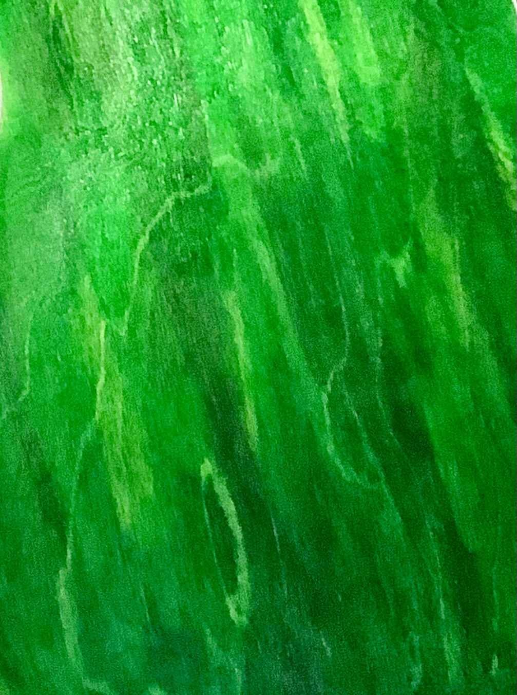

    After 4 coats of wipe on poly the colours really stand out - becoming a fan of wipe on poly so easy and effective. Seems to be a good hard finish as well.
    Waiting for some filler I ordered before starting on sides and top.
    While waiting I’m sanding down some wooden bridges I made for experimenting with height and grooving for strings.
    Trevor I added a shim to the neck pocket which changed the neck angle so now the straight edge is just above the bridge channel - I figured this allows more adjustment with bridge height- higher bridge to start with and can always lower as preferred.

    Nice colour! I like the dappled light beams idea.
    And good call with the neck angle and shim.
